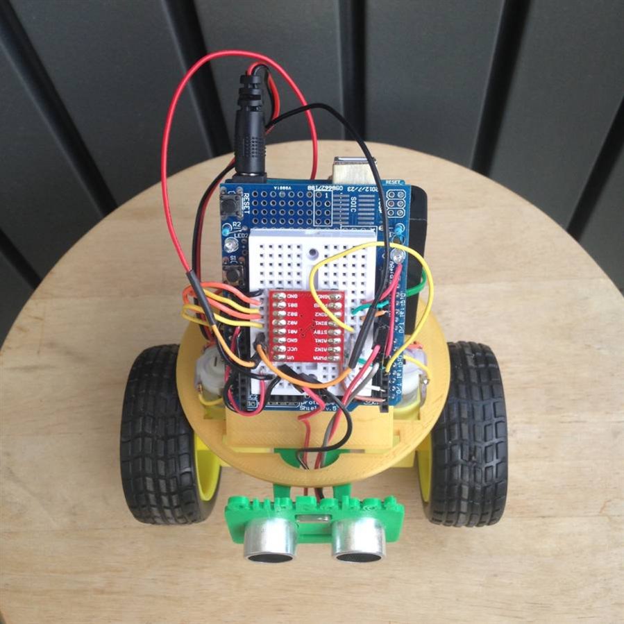

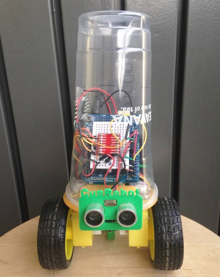

This month’s theme Robot on Wheels had me excited, and though I have been kind off busy at work, I knew I had to post a project. I have been working on a 3D design to create a simple robotic platform which is easy to 3D print. This is the second version of the 3D printed parts with improvements, and I have called it the -  CupRobot, as I am using a cold coffee cup to protect the electronic components image, but feel free to suggest a name if you come with something more interesting, or some enhancements you would like to see with the bot.

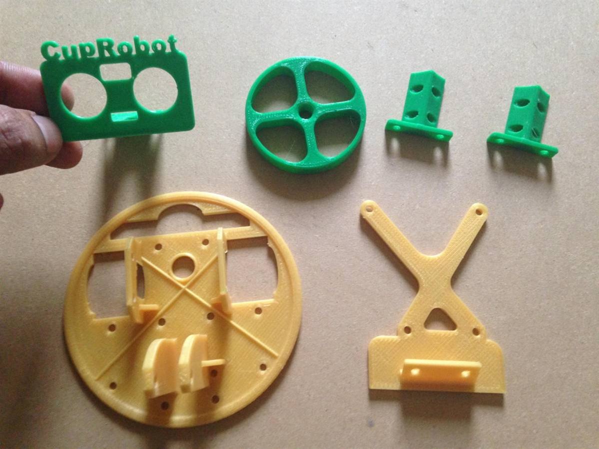

Here is a picture of the 3D printed parts, you can use PLA or ABS and you will not require any support material while 3D printing. STLs files for the 3D printed parts attached.
#1 base to hold the motors
#2 holder for the Arduino Uno
#3 back wheel
#4 holder for the AA battery holder
#5 in addition if you plan to add an ultrasonic sensor you will need to 3D print another holder, which king of gives the CupRobot its eyes image..

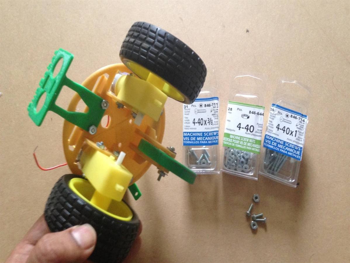

For putting the components together you will need 4-40 screws and nuts, which you can get at your local hardware store.
Here are the circuit connections using the Sparkfun motor driver(TB6612FNG) and Arduino Uno.
  • PWMA on the motor driver connected to pin# 5
  • AIN1 to pin# 1
  • AIN2 to pin# 2
  • PWMB to pin# 6
  • BIN1 to pin# 11
  • BIN2 to pin# 12
And for the ultrasonic sensor(HC-SR04) connected to
  • Trigger Pin  to Arduino pin #9
  • Echo Pin to Arduino pin #10
