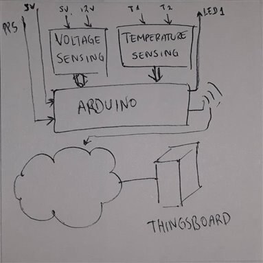

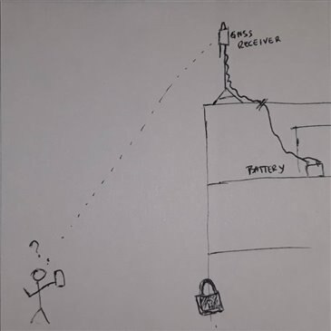

In an RTK GNSS system, one receiver works as a base station calculating its position from satellites data, and as its position is fixed, it calculates some corrections and then broadcast them. On the other side, a second GNSS receiver take those corrections in order to improve the accuracy of its calculated position. A more detailed description can be found in this article: "How RTK works". As the receiver we are using is not for outdoor applications, we assembly it in a weatherproof enclosure and the only incoming cable is for power and comms. The assembled unit is the one below and as can be seen, only two antennas (GNSS and RF) and a cable gland are exposed.
Now, the idea is that the base station can be a standalone, unattended unit working 24/7 we need to know at least some information about it, like the battery voltage and the internal temperature. The client of the project will install it on the roof of a building and put the battery indoors, about 25m away from the unit. Measuring the voltage at the battery or opening the box to check the temperature is not the best option as we would need to ask for permission, take someone out of his/her work, etc., so we prefer to do something that let us make trials and work independently. The problem is summarised below.
Based on this, we decided to develop a small IoT-based device that helps to monitor the health status of the base station unit. The idea is to use the Arduino MKR1000 IoT kit which was part of a previous Roadtest, and send the data to an IoT cloud platform. In this case, Thingsboard was chosen because was used for previous projects. For describing this development, this post is divided into three sections: Design, Development and Testing. Each section will show the aspects of both hardware, firmware and software.
Section 1: Design

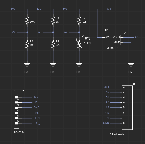

The overall requirement is to create a system to measure 2 voltages (5v and 12v) and 2 temperatures, the measurement period will be 1 minute and the data should be sent to the cloud for its visualisation and analysis. As the GNSS receiver provides a Pulse-Per-Second Signal, this will be used for timing one minute between measurements. The general block diagram of the solution is presented below:
Hardware
Voltage Measurement
Inside the GNSS receiver enclosure, there are 12V from the battery and 5V regulated which sometimes are used with a power bank for trials out-of-the-roof. As the Arduino MKR1000 inputs only accept 3.3 volts signals, two voltage dividers were designed for this purpose. The first one for the 5V (Vcc) uses 2 10k resistors, which provides a factor of 0.5, and with a maximum value of 2.5V when the input is 5V. This output will be connected to the Analog input 0 (A0). For measuring the battery voltage (Vbat) the divider uses one 1K and one 220 resistors, for a factor of 0.18 which outputs 2.7 when the input voltage is 15V. This output will be connected the analogue input 1 (A1).
Temperature Measurement
For measuring temperature I had in stock one NTC thermistor (B57863s0103f040) and one temperature sensor from the Arduino IoT kit: a TMP36. For the first one, a voltage divider with a 10K resistor is used, powered by 3.3 volts from the Arduino board, the output of this divider is used with the analogue channel 2 (A2). The TMP36 sensor is powered from 3.3 volts as well and the output is connected directly to the analogue input 3 (A3).
Digital IOs
The PPS signal from the GNSS receiver is connected to pin 4 of the Arduino and an LED for visualisation purposes is connected to pin 7.
The schematics of the hardware design is shown in the following picture.

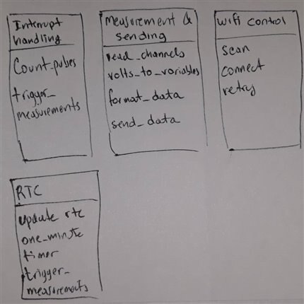

Firmware
The firmware is composed of four parts: Interrupt handling for receiving and counting the pulses from the PPS signal and triggering the measurement, the RTC module for updating it and counting one-minute intervals as back up, the wifi control module for scanning, connecting and retrying connections, and finally, the measurement and sending module which reads the voltage values from the analogue channels, converts them to variables and then format the data for sending it to the cloud. A sketch of the modules is shown below:

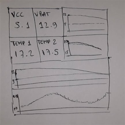

Software
As Thingsboard is a developed platform, only a draft of the desired dashboard is done at this stage. It is defined that the dashboard contains the last values of the variables Vbat, Vcc, Temperature 1 and Temperature 2. Also, it is desired to include short-term and long term graphs of the evolution of the variables. Something like this:

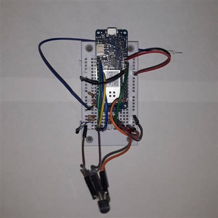

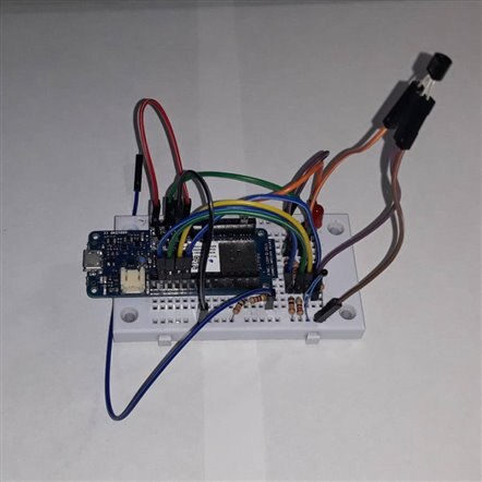

The initial implementation of the hardware was done on a breadboard using through-hole resistors, one NTC thermistor, one TMP36 temperature sensor, one LED and jumper wires. It was tested both with a 5v power bank and inside the enclosure measuring both 12v and 5v. The prototype is shown in the following pictures:

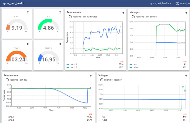

Software

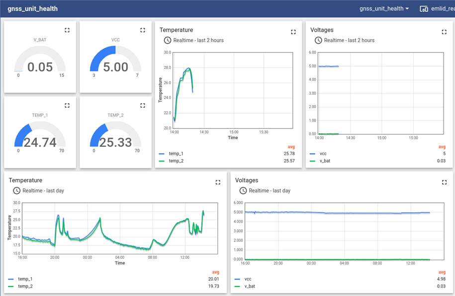

I already had an account in Thingsboard (Free demo version), so the first step is to create a new device. Then I can copy the access token for that device, which is used in the firmware for making the POST request with the data to be sent. Once the device is ready and receiving data, a new dashboard can be created. Inside the dashboard, several options of widgets can be added and organised in a grid manner. For our case, we chose four gauge widgets for displaying the latest values and 4 graph widgets for short- and long- term plotting of the variables:
Section 3: Testing

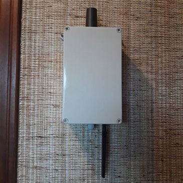

Here there is a video of the system working from a battery bank. When the temperature sensors are disturbed the dashboard widgets are updated.
And here is a screenshot of the dashboard receiving data from the health monitor once it is installed inside the enclosure:
