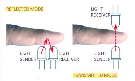

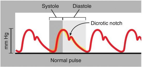

             A pulse wave is a change in the volume of a blood vessel that occurs when the heart pumps blood, and a detector that monitors this volume change is called a pulse sensor. Heart rate can be measured in many different ways. The figure below shows the different ways of measuring the heart rate.
The two most common techniques are electrical and optical methods. In principle the heartbeat sensor is based on the principle of photoplethysmography, whereby the heart rate is measured by sensing the changes in blood flow through the index finger. The flow of blood volume is decided by the rate of heart pulses and since light is absorbed by the blood, the signals are equivalent to the heartbeat pulses. There are two types of photoplethysmography:
Transmission : Light emitted from the light-emitting device is transmitted through any vascular region of the body like the earlobe and received by the detector.
Reflection : Light emitted from the light-emitting device is reflected by the regions.
The below image illustrates how these two methods are applied.

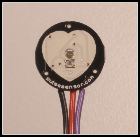

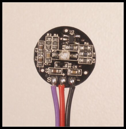

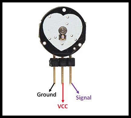

     The main sensor that we will be using in this project, is the pulse sensor.  Before going further, let's look into the details of this pulse sensor. Below is the figure of the pulse sensor
Front view of the pulse sensorRear view of the pulse sensor

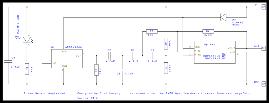

And below is the schematic of the pulse sensor
     The schematic and PCB file is open source and can be downloaded from here. To explain more on the pulse sensor, on the front of the sensor is the heart logo. This is the side that makes contact with the skin. On the front, you see a small round hole, which is where the LED shines through from the back, and there is also a little square just under the LED. The square is an ambient light sensor, similar to the one used in laptops, tablets, and cellphones, to adjust the screen's brightness in different light conditions. The LED shines a light into the fingertip or other capillary tissue and the sensor reads the light that bounces back. The back of the sensor is where the rest of the parts are mounted. That's a very brief idea of the pulse sensor. This sensor can be directly connected to Arduino or any other microcontroller. This sensor comes with three pins. The figure shows the name of each pins.

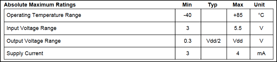

And the spec of the sensor is as shown in the table below

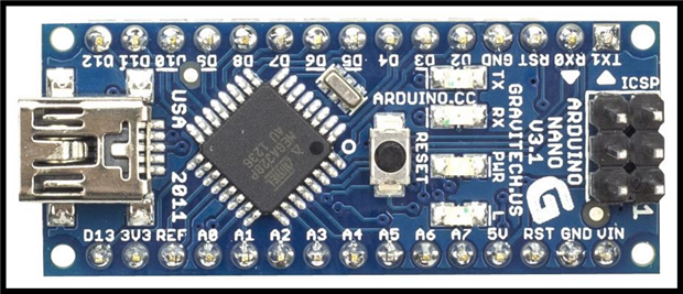

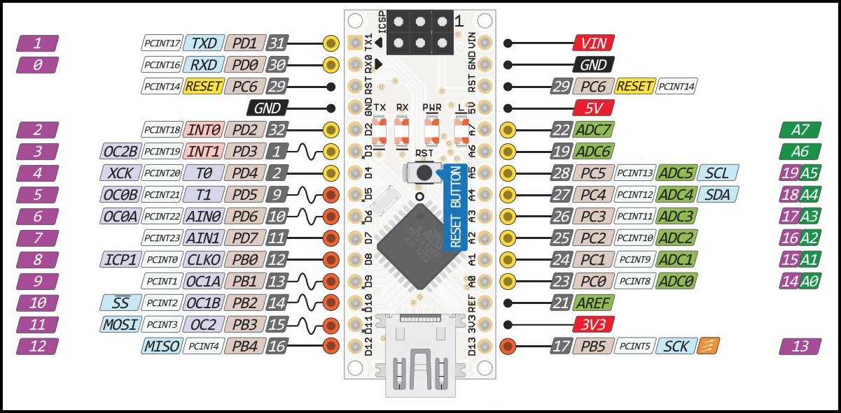

That's about the pulse sensor. Next, we shall see our next component/device which is the microcontroller. For this project, i have decided to use the Arduino Nano. The reason for me to choose this model is due to its small form factor. The figure below shows the image of the Arduino Nano and its corresponding pin.

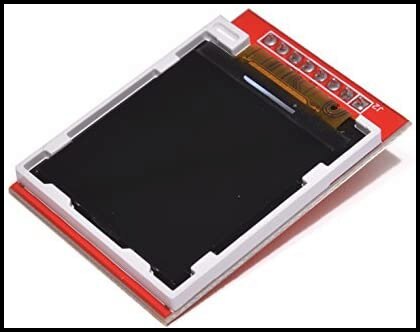

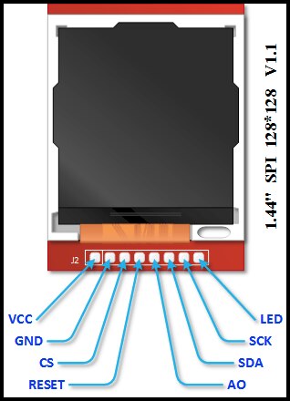

We will like to display the heartbeat in a cool way, hence decided to use the 1.44" tft display and their respective pin layout.

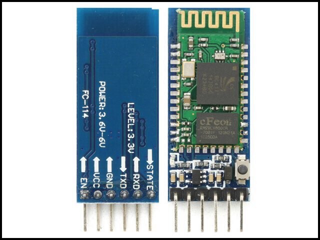

And the next device/component that we would like to see is the Bluetooth device. We would like to send the data from the pulse sensor to mobile devices. The type of bluetooth devices which we have decided to use is the HC05. The figure illustrates the HC05

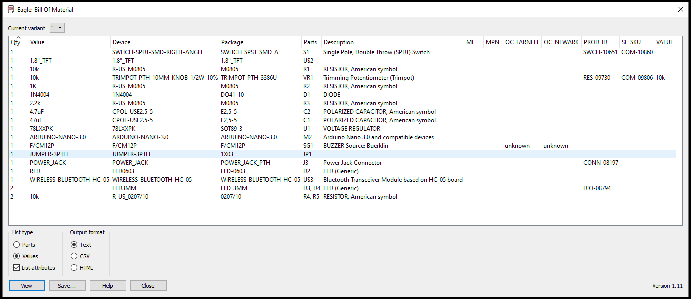

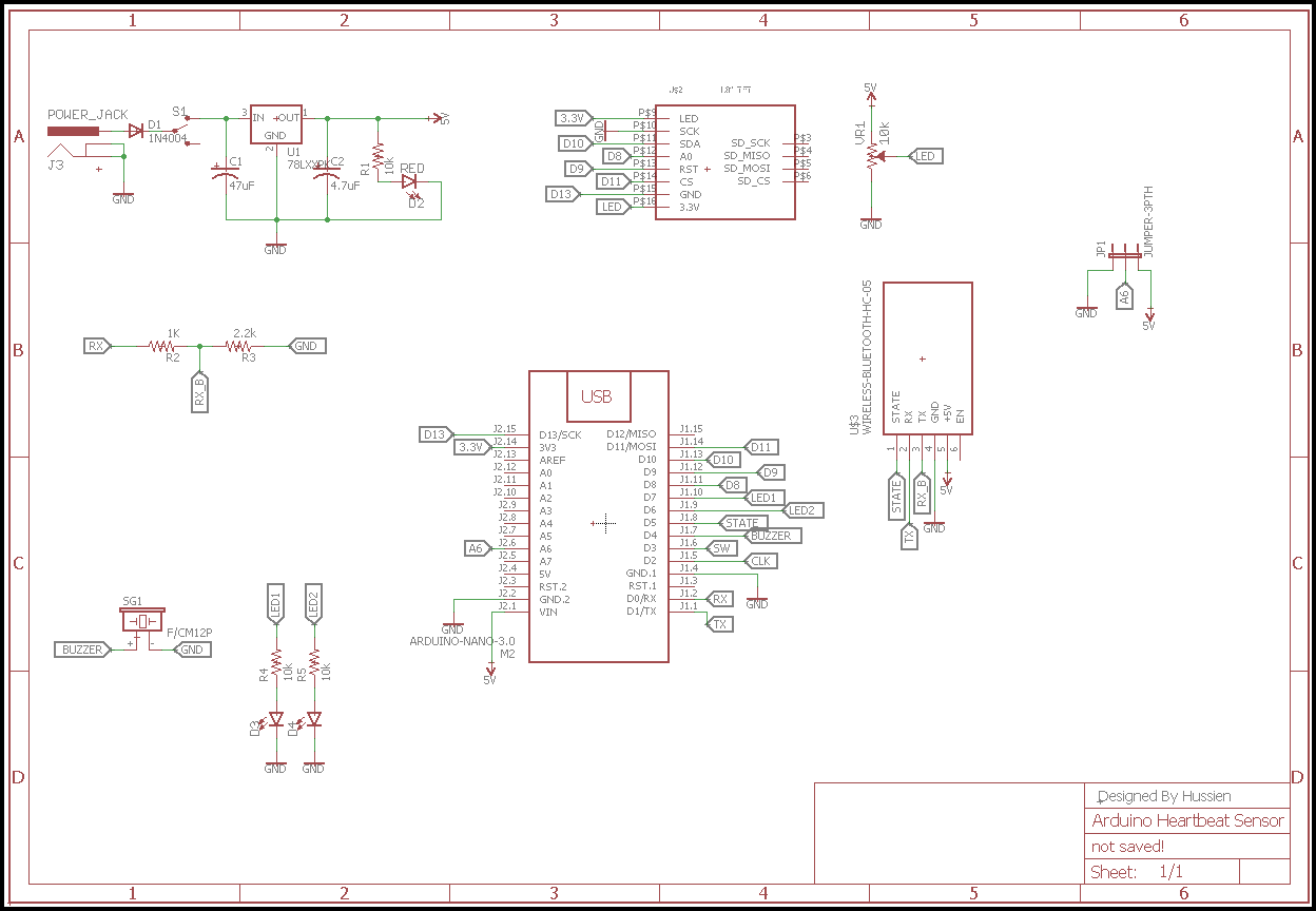

These are the three main components of this project. Other than this we have used miscellaneous components such as the trimmer pot, and others as well. All the components used are covered in the BOM list. Now let's move on to designing the circuit for this project. For this, I have used Eagle. The figure below shows the schematic.
And below is the BOM of the schematic

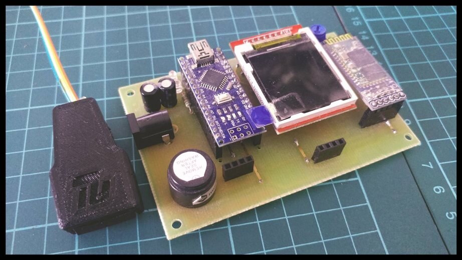

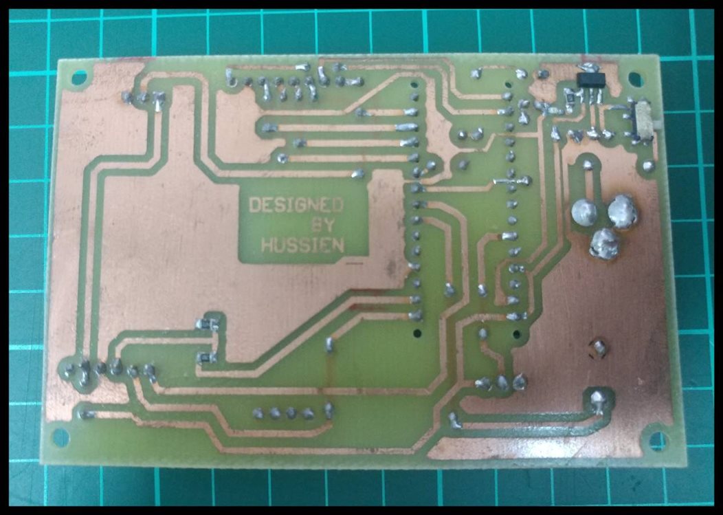

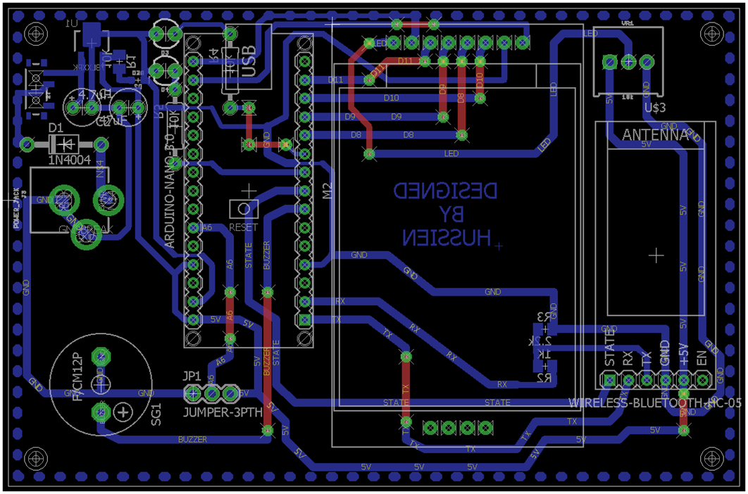

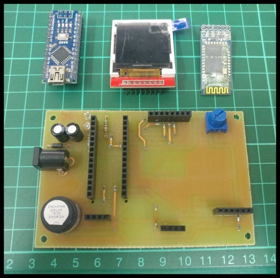

I have decided to build this project on a PCB, below is the PCB layout of this schematic

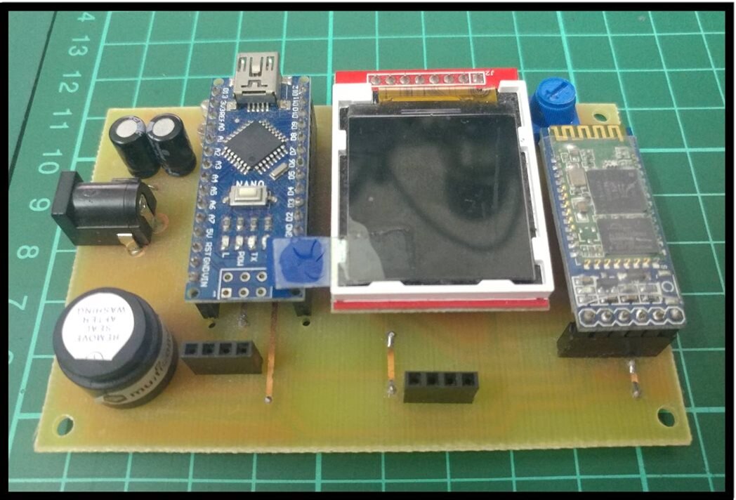

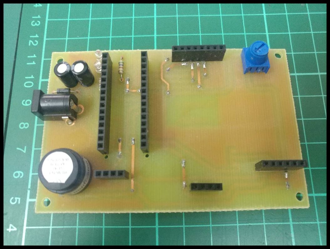

The figure below shows the component populated on the board.

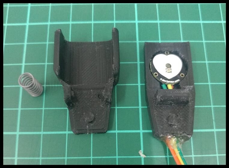

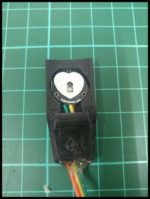

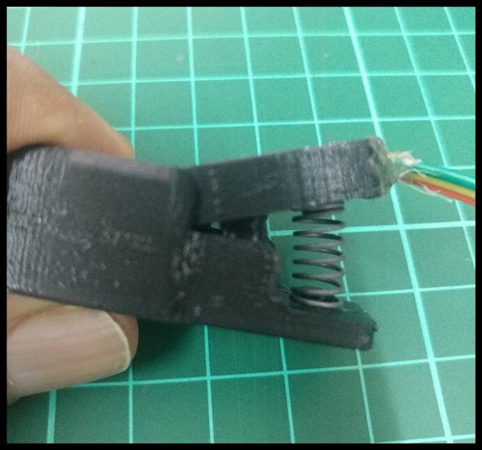

Once that we have our board ready, we have one last thing to get done before we can start to program our board. We need to get our pulse sensor ready for we can start to calibrate or put out the sensor into action. There are many ways to get the pulse sensor attached to the finger. One example is to use the velcro strap or any other method as well. In this project, I have decided to 3d print the pulse sensor holder. The figure below shows the 3d printed case for the pulse sensor.
Header 1Header 2Header 3
The file for the 3d print can be downloaded here. Once all are set, next we move on the coding part.

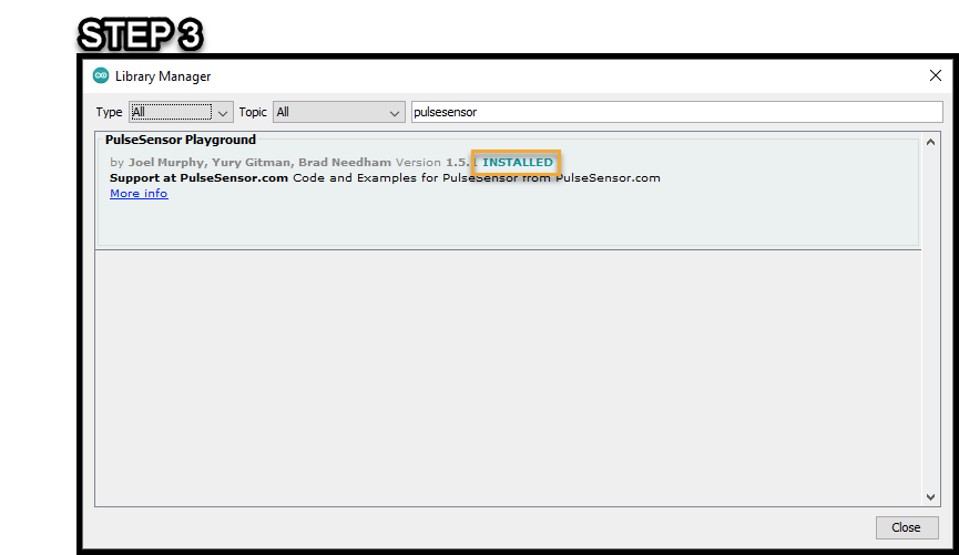

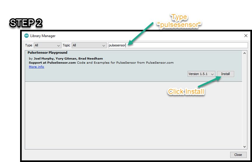

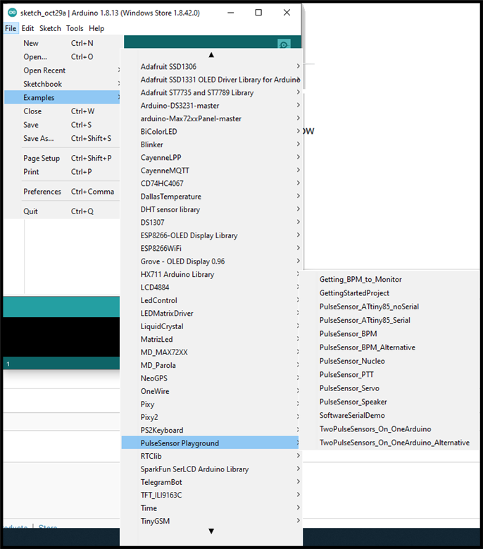

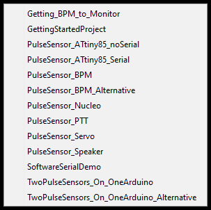

In this part, we shall look into the software that we use to build our project. Definitely we use the Arduino IDE, and apart from that, we shall use other software as well. Firstly we would like to calibrate our sensor. For this, we will use the sample code and view it in the serial monitor. First step is to ensure that we have installed the pulse sensor library. If not installed yet, please follow the steps below
Once the library is installed as shown in figure above, we can try to run the first example as shown in the figure below
As can be seen from the figure above there are a lot of examples provided within the library. The image below shows a better view of the examples
We will first run the "Getting_BPM_to_Monitor". Below is the snapshot of the code.

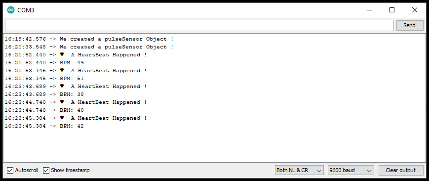

Basically, the code is from the pulse sensor example. The pin number for the pulse wire is changed from A0 to A6 to suit our design. Next, we upload the code to the board and see the serial output.
And the video below shows the heartbeat in the serial plotter.
The default threshold value is 500. And it can be changed to suit our sensor based on the reading we get through the serial monitor. Next, we shall move on to design the display for the TFT display. As we have seen in part 3, we are using a 1.44" TFT display. In order to get this running, we will be using the Adafruit_GFX.h and TFT_ILI9163C.h library. And to test that our display is working fine and wired properly we will try to run the sample code as shown below
