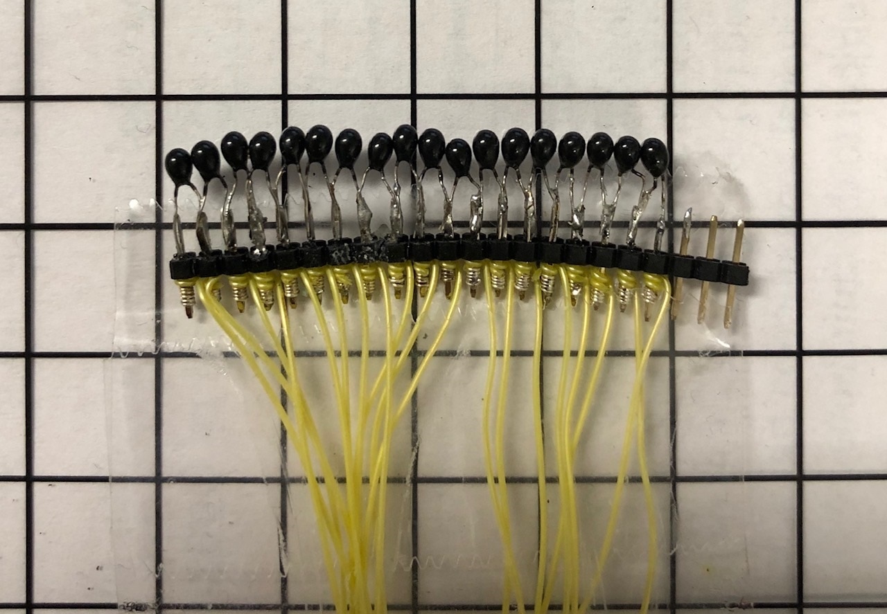

Iteration 1: Thermistors

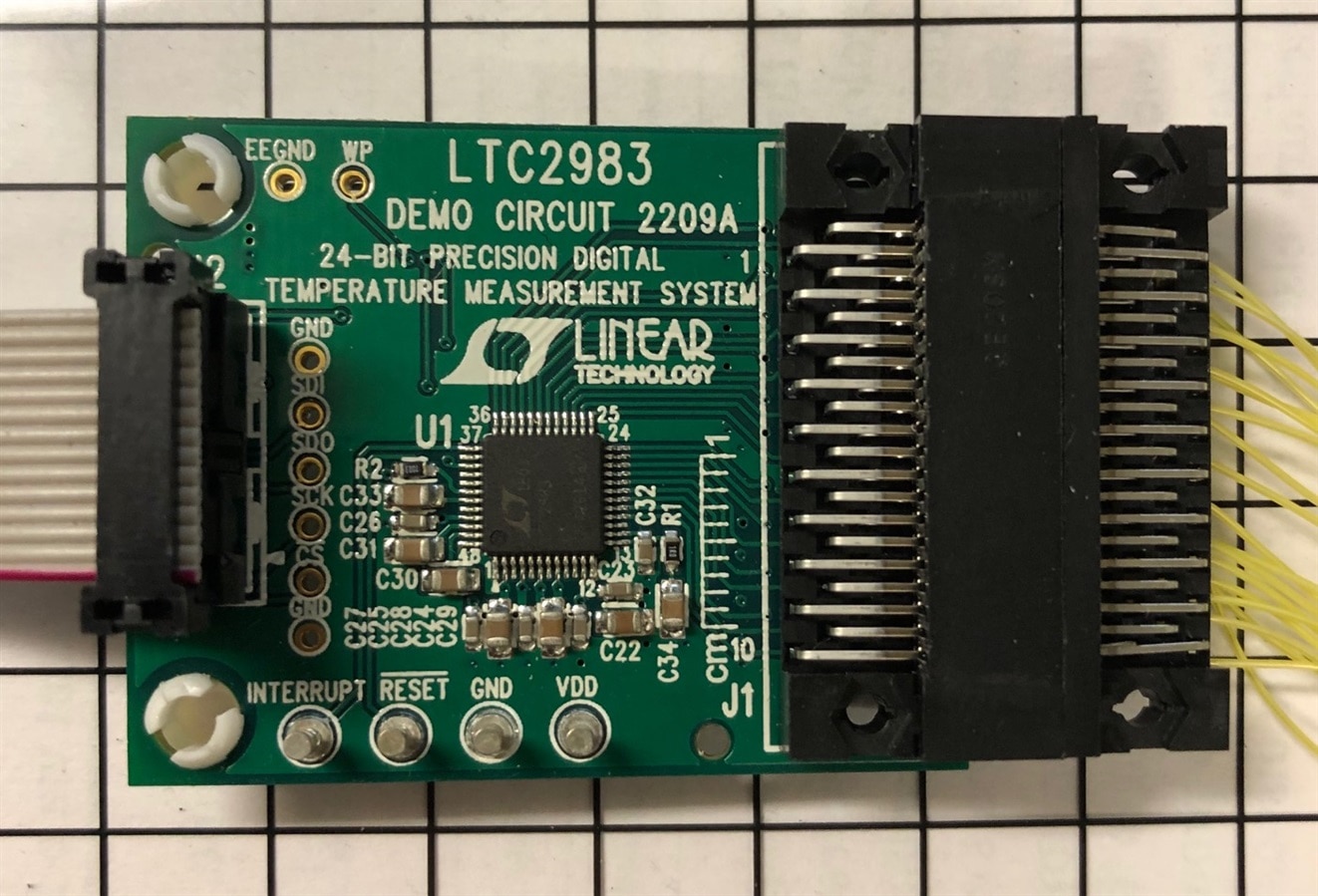

Analog Devices has a kit with a "Linduino", and a LTC2983 24-bit digital temperature measuring system.
I purchased the kit and 16 thermistors, soldered them up and here's V1 (each grid square is 1cm)
This setup worked OK in air, but went crazy in water.  I could seal the whole thing in epoxy, but had another idea...

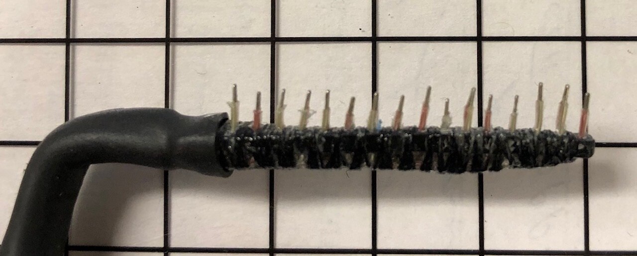

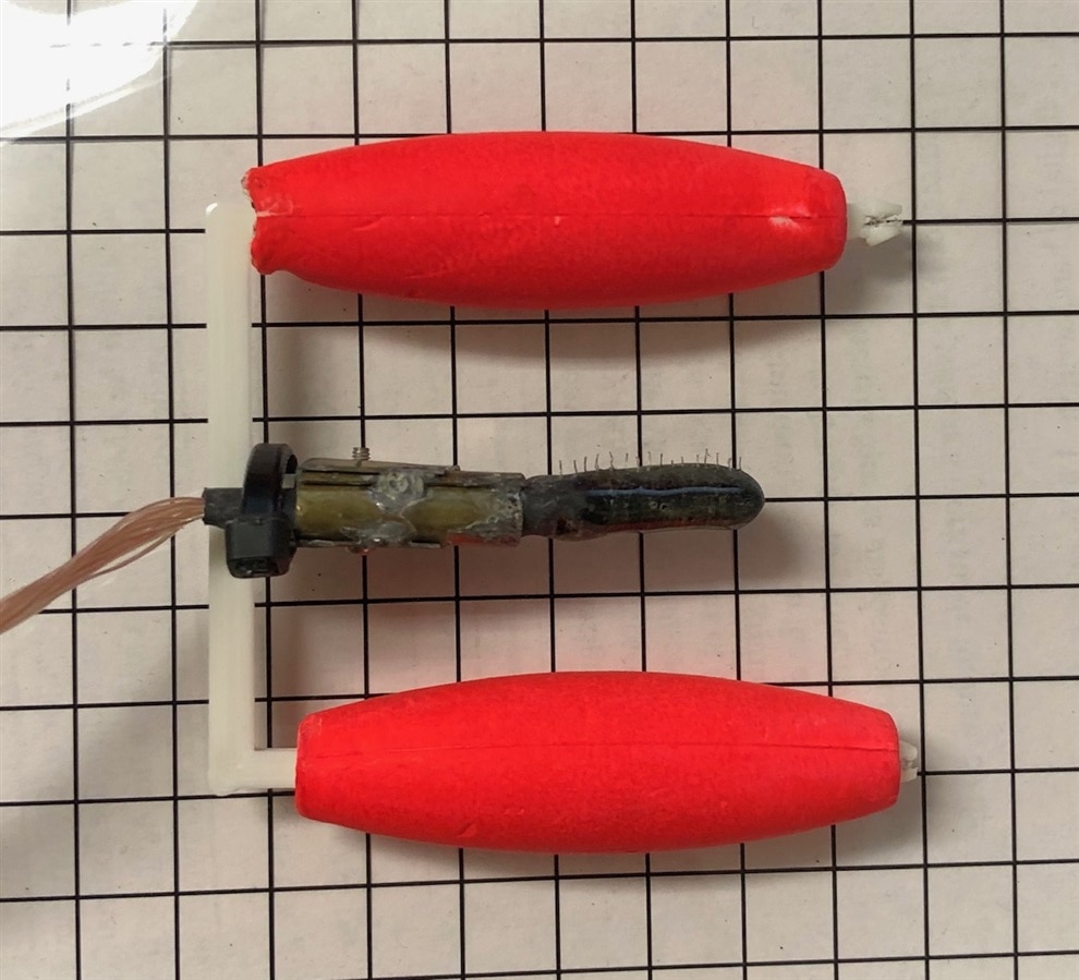

Iteration 3: smaller thermocouples:
I found some circuit board with 1.25mm spacing and put some 40AWG k-type thermocouples through the holes.
Then I wrapped between each thermocouple with sewing thread to build up and separate the individual sensors.
Then I epoxied the device very carefully.
I changed out the NI USB DAQ to a NI cDAQ-9191 WiFi DAQ that could be battery operated.
The sensor array was mounted at 15deg to a pair of floats so that half of the sensors would be in the water, and half out of the water.

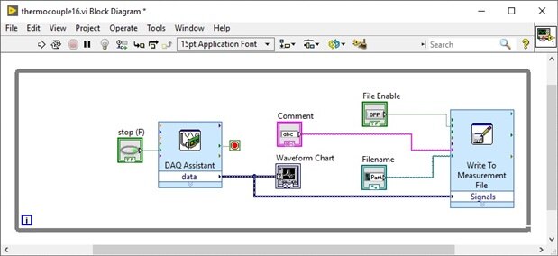

Here's the LabView Block Diagram:

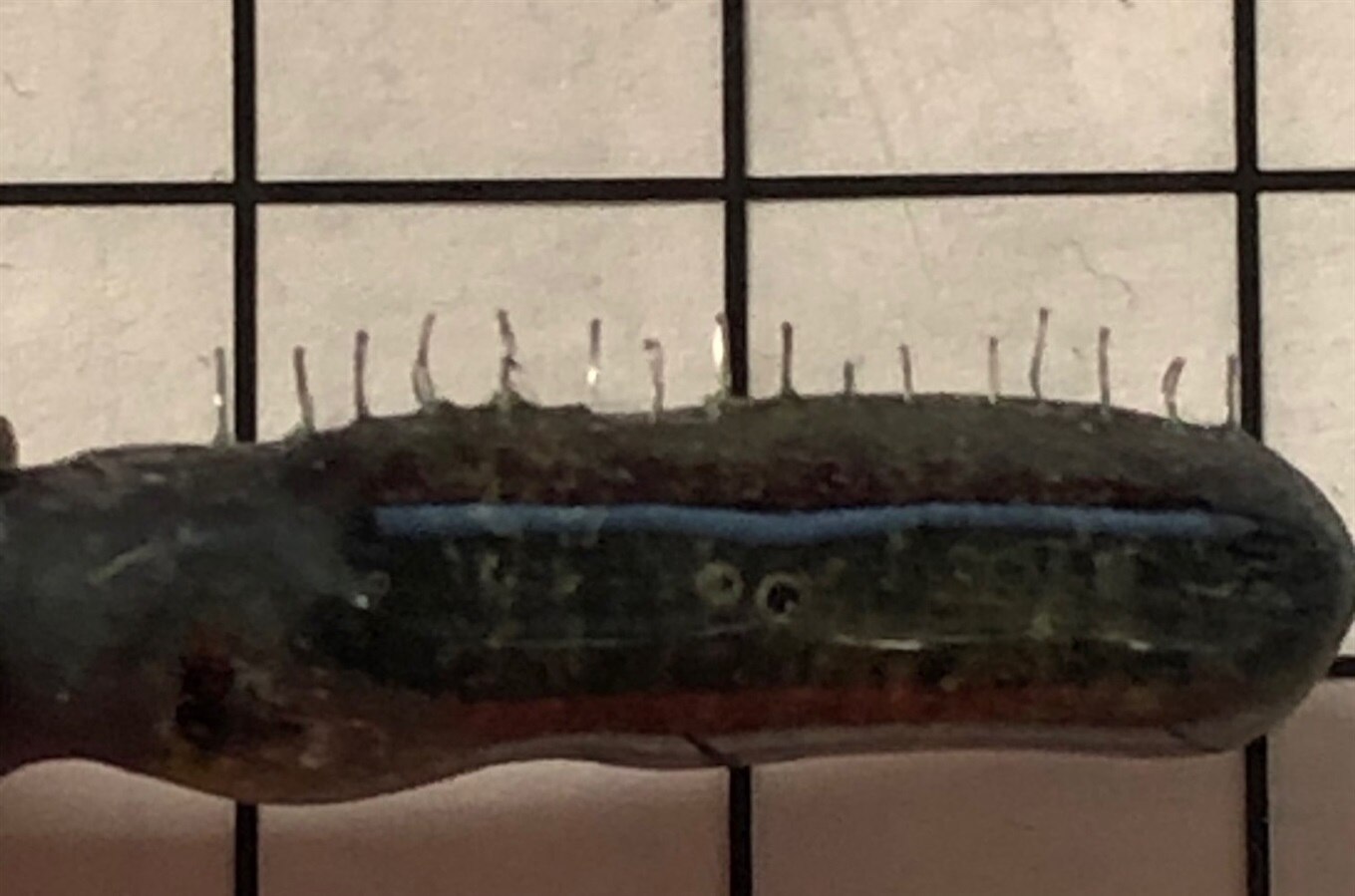

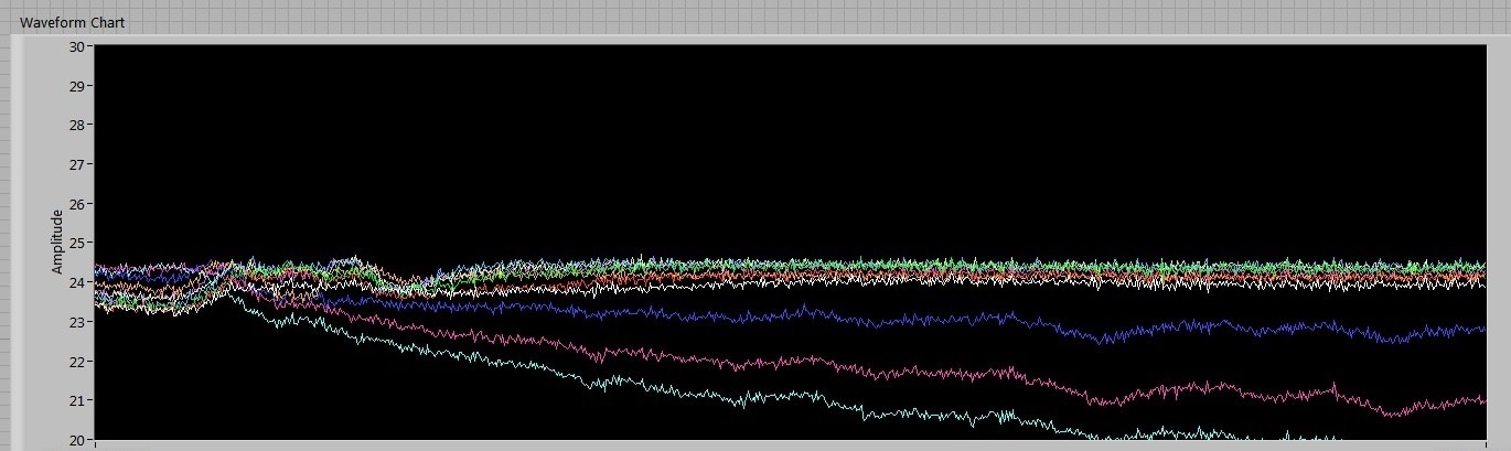

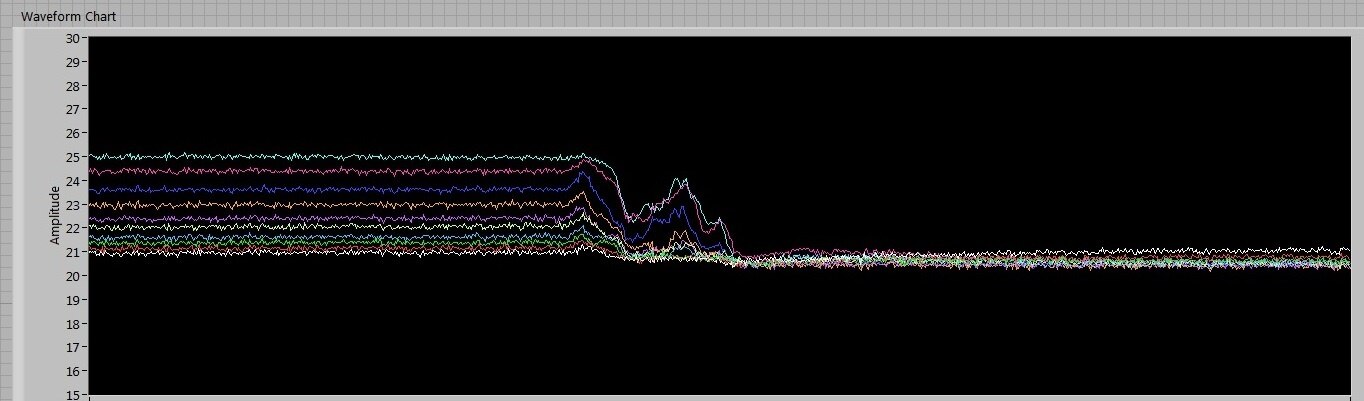

The data was interesting.  When the probe was out of a mixed layer of water then put into the water, the graph was as expected.
When the probe was submerged completely and then raised half-way the data was a bit unexpected.
Instead of showing warmer air temperature, it showed cooler than water temperature due to evaporation cooling.
We found out that we couldn't tell if some of the thermocouples were in colder water, or just out of the water with evaporation cooling.
Of course the first time we put the probe in a real lake, a dragonfly immediately landed on it and caused all sorts of problems, after that, the minnows were nibbling on the probe.
No matter how hard we tried, a tiny wind would cause a wave big enough to submerge the entire probe.
