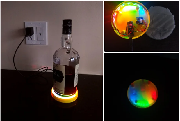

Holiday season is almost here, which means it time to make something that lights up. As part of this project, we are making a Light up Coaster using an Arduino Nano, LED strip and a grove sound sensor. The coaster changes colour as soon as it hears some sound/music playing.

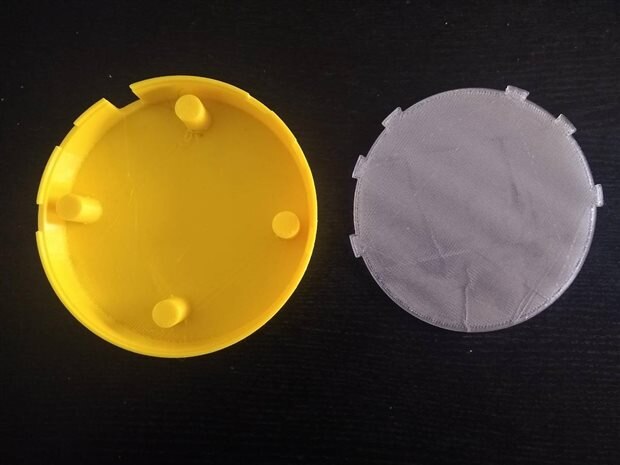

Download and 3D print the STL files attached
There are 2 STL files attached in the zip file below, You can print this coasterBottom.stl file using a coloured filament and the coasterTop.stl using a transparent filament to help with the diffusion of the APA102 LED strip.

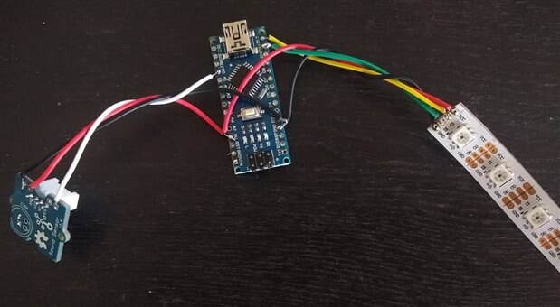

Soldering the circuit together

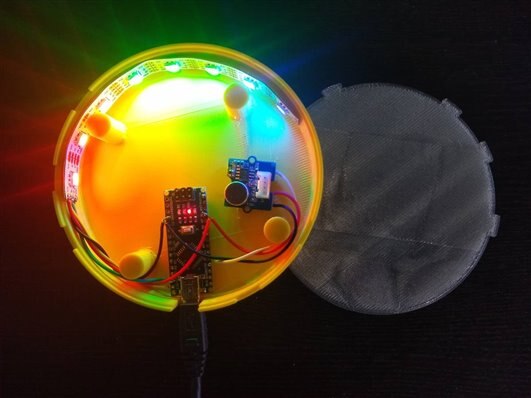

Now for the circuit we will need an Arduino Nano, LED strip APA102 and a Grove sound sensor. Here are the connections to the Arduino Nano
  • apa102 led strip Data  connected to Arduino pin# 11
  • apa102 clock connected to Arduino pin# 12
  • Sound sensor connected to A0

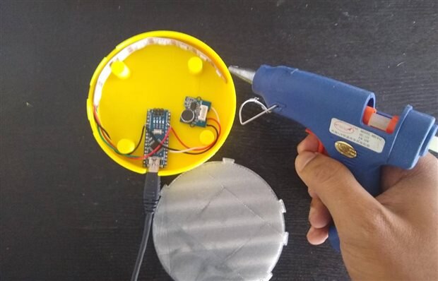

Once done hotglue the Arduino, Sound sensor and LED strip to the 3D printed parts.

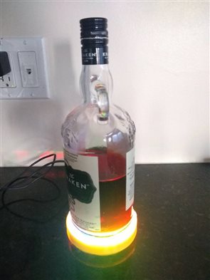

Here is a quick test of the circuit, and once done the top should snap fit to the bottom 3D printed part...
Here is a quick video demo.
