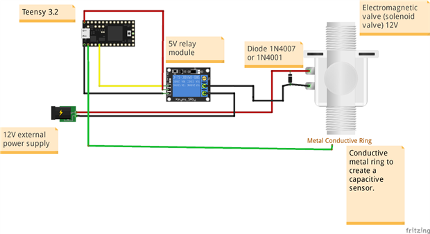

ELECTRICAL COMPONENTS
  • Teensy 3.2 - 1 pc
  • Electromagnetic valve (solenoid valve) 12V - 1 pc
  • 5V relay module - 1 pc
  • Diode 1N4007 or 1N4001 - 1 pc
  • Metal to set up around the valve as capacitive sensor - 1 pc
  • 12V external power supply for solenoid valve - 1 pc
ARCHITECTURE
INSTRUCTIONS

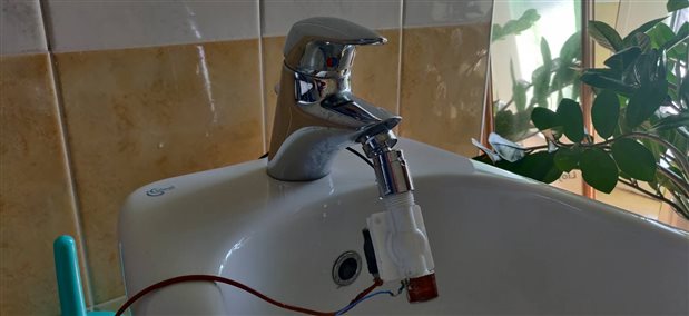

To limit the touching area around the tap to a specific area, it's important that the capacitive touch sensor is surrounded by not connective material, like plastic.
