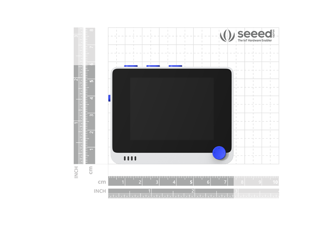

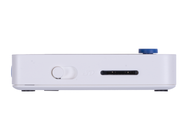

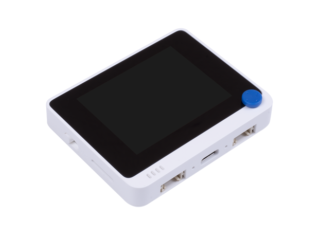

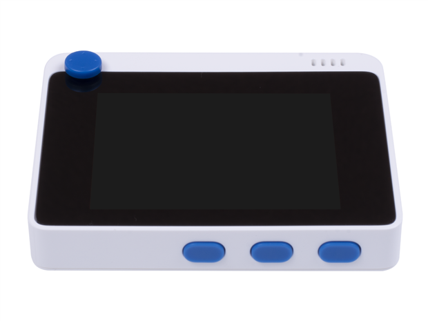

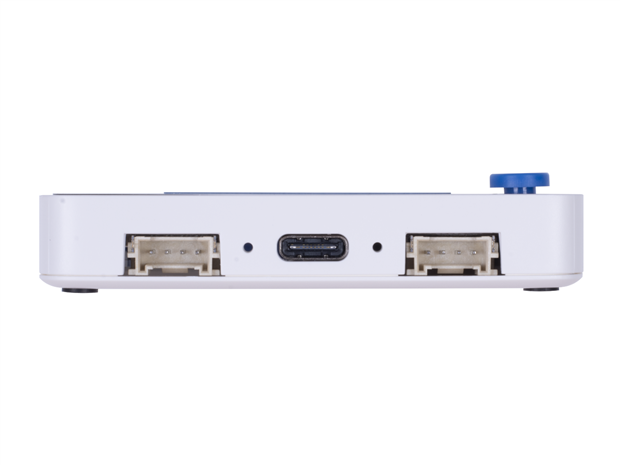

Front LCD View: USB-C and Grove ports on bottom.  Power/reset switch and microSD on left.  5 way switch lower right.  Speaker lower left.
Front LCD View: 3 push buttons on top.

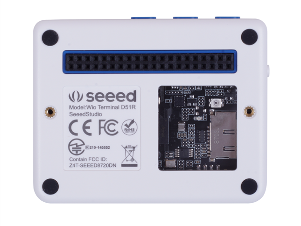

Back View: Clear window for IR emitter and light sensor.  40 pin RPi connector.  Magnetic feet in corners.

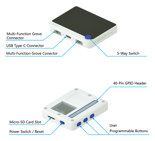

Left SIde View: Power/reset switch.  microSD slot.
Bottom view: USB-C and Grove connectors.

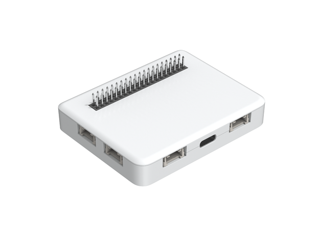

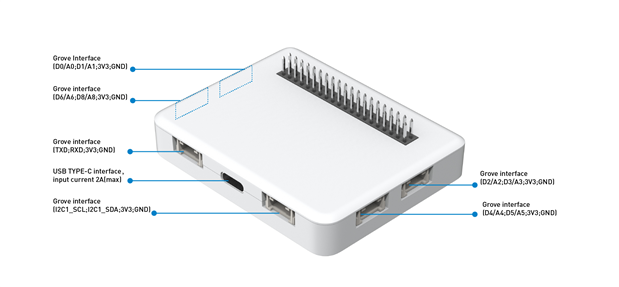

Battery Pack Top View:  RPi header.  Grove ports on left.  USB-C power and Grove ports on bottom.

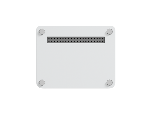

Battery Pack Bottom View: RPi connector feedthru.  Magnetic feet in corners.
Dimensions: 72mm*57mm*12mm (Battery Chassis is same thickness)
Functional layout diagrams of Wio Terminal and Battery Pack

I thought that I would create a multi-sensor application that would highlight the Wio Terminal's capabilities.  I had considered using the built-in IR emitter and light sensor but unfortunately since I plan to use the battery pack those sensors won't work because they are designed to use a transparent window on the back of the Wio Terminal and that gets covered by the battery pack.  I wish that they had put those sensors on top near the 3 pushbuttons.  I am going to use a light sensor but I'll need to add that externally via one of the Grove ports.
