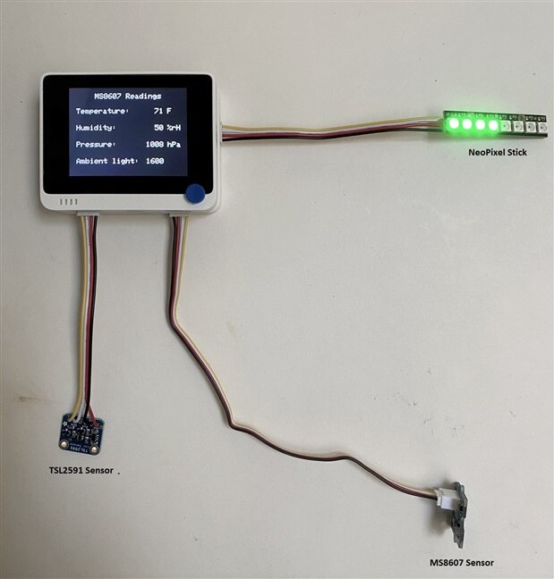

Sensor Connection and setup

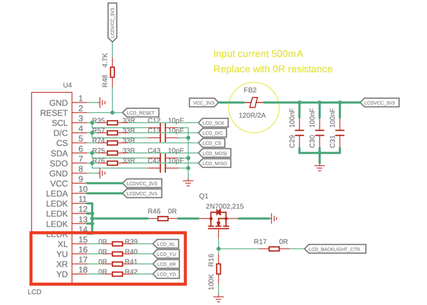

LCD 320x240 Display
The LCD display uses one of the 3 internal SPI interfaces (the other 2 are used for the WiFi and the SD card).  There are touch control lines shown on the schematic but this might be for a future version upgrade as the current display does not have touch capability.  The pin used to drive the backlight control FET is also PWM capable but a third party library is needed to drive it.
The libraries required to interface the LCD are the Seeed_Arduino_LCD library (TFT_eSPI) and the Adafruit_Zero_DMA library.  These are included in the Seeed SAMD board package.
TSL2591 Lux Sensor
I am using the I2C1 bus - one of the 2 dedicated I2C interfaces.  I2C1 is available on the bottom left Grove connector of the Wio Terminal and the bottom right connector of the battery chassis in addition to the 40 pin RPi connector.  I am using the bottom left Grove connector for the light sensor.  The Adafruit sensor breakout that I used is an obsolete version that uses a 0.1" header pattern for the pinout.  The new ones have a Stemma QT (QWIC) connector.  I have adapter cables from Stemma QT to Grove but in this case I just cut a Grove cable in half and wired it in directly.  I used the other half of the cable to connect the NeoPixel Stick.  I used the Adafruit Arduino library with the default I2C address of 0x29.
MS8607 Temperature, Humidity and Pressure Sensor
I'm using the second I2C1 Grove interface on the bottom right of the battery chassis for this sensor.   Since this is a Grove module the connection was with a standard Grove cable. This sensor breakout is made by TEConnectivity and uses a MEMS sensor that is factory calibrated.  I used the Adafruit Arduino library which is a version of the TEConnectivity library modified for the Arduino IDE. I was somewhat surprised that the sensor uses two I2C addresses - 0x76 for pressure/temperature and 0x40 for humidity.
NeoPixel Stick 8 x 5050
I am using Digital Pin D2 on the Grove connector on the upper right side of the battery chassis to drive the NeoPixel Stick.  This stick uses RGB LEDs rather than the 4 color RGBW LEDs.  Each LED is individually addressable and all LEDs are connected sequentially on a single wire interface, so I only needed one of the two signal pins on the Grove interface.  I wired the board using the other half of the Grove cable that I cut for the light sensor interface.  I used the Adafruit NeoPixel library to program it.

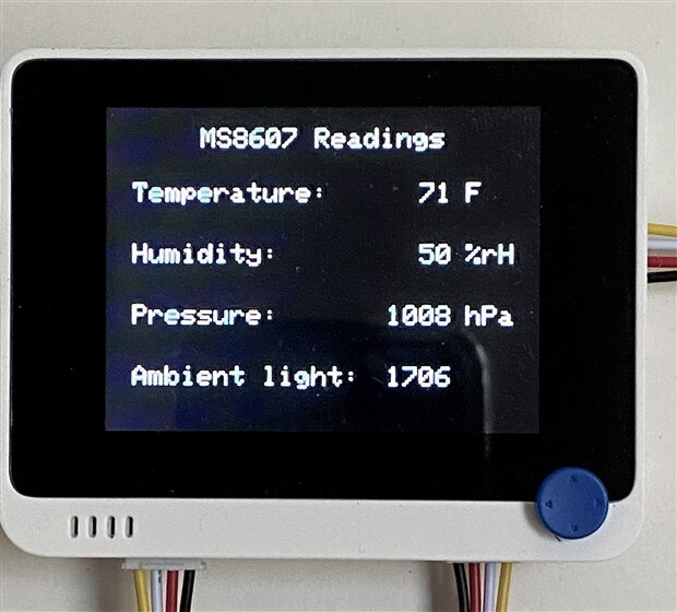

Interactive Sensor Program
So, I started with a program to use the 3 sensors together with the display.
  • Display Temperature, humidity and pressure measurements from the MS8607
  • Display Ambient light readings from the TSL2591
  • Change the number and color of the LEDs on the NeoPixel Stick based on the temperature measurement
  • Change the brightness of the LEDs based on the ambient light measurement
Wio_Terminal_MS8607_TSL2591_NeoPixel.ino

    tft.setTextSize(2);
    tft.setTextDatum(TC_DATUM);
    tft.drawString("MS8607 Readings",160, 15, 1);

    tft.setTextSize(2);
    tft.drawString("Temperature: ",20, 55, 1);
    tft.drawString("Humidity: ", 20, 100, 1);
    tft.drawString("Pressure: ", 20, 145, 1);
    tft.drawString("Ambient light: ", 20, 190, 1);
    tft.setTextDatum(TR_DATUM);
    tft.setTextPadding(tft.textWidth("999", 1));
    tft.drawNumber(tempF, 255, 55, 1);
    tft.drawNumber(humid, 255, 100, 1);
    tft.setTextPadding(tft.textWidth("99999", 1));
    tft.drawNumber(press, 255, 145, 1);
    tft.drawNumber(lightValue, 255, 190, 1);
    tft.setTextPadding(0);
    tft.setTextDatum(TL_DATUM);
    tft.drawString("F", 265, 55, 1);
    tft.drawString("%rH", 265, 100, 1);
    tft.drawString("hPa", 265, 145, 1);

Sensor hookup to the Wio Terminal (running on battery in this picture)
Close-up of the sensor measurements on the LCD Display

Color pattern (each LED represents 10 degrees F from 40 to 120 degrees F)
  • Blue - below 70 degrees F
  • Green - greater than or equal to 70 and less than 90
  • Red - above 90 degrees F
