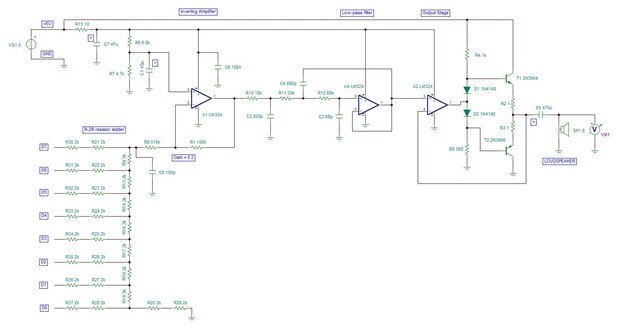

Circuit description
The waveform is generated by a R-2R network working as a DAC (digital-to-analog converter) directly from the Arduino port pins.
See this series of blogs for more on the R-2R network used as a DAC: Arduino: R-2R Experiment
By its nature, because the digital I/O pins swing between the rails, the output of the DAC is 0 to 5V fullscale. That's too high for what I want here, so I need to reduce the swing to something more manageable. I do that with the first stage (U1) which is an inverting amplifier with a gain of one tenth fifth - that then gets me a maximum swing of half a volt (I changed it after writing this because the original was a bit quiet and then forgot to come back and edit the text). The gain is simply R1/R8. The idea behind the 150pF capacitor is to slow the edges of the DAC output which are very fast and cause the op-amp to ring - it helps, but could be done better. The LM324 is an old bipolar op-amp that can't work up all the way up to the supply rail, and it's probably best to keep everything well clear of ground too, so the first stage also places the signal around 2V. It doesn't matter what the actual, precise level is as long as the signals are in a range where the op-amp can function properly - the audio is ac and at the end of the chain will pass through a capacitor, after which it will be referenced to ground again, so we don't care about arbitrary dc offsets prior to that.
Following the attenuator, there's a low-pass filter which comprises op-amp U4 and the passive components around it. It's a third-order Sallen-Key filter. This smoothes the waveform and removes the steps at the sampling rate. I didn't design this from scratch, instead I copied an existing design and scaled the resistor values to modify the cut-off frequency. The op-amp is configured as a follower and there's a dc path from the previous stage to the non-inverting input, so the output will still be centred about 2V.
The final stage, comprising U2 and the transistors, is a simple (and somewhat crude) power amplifier. The op-amp can't manage enough current to directly drive an 8 ohm loudspeaker, so the transistors lend a hand. The transistors are configured as emitter followers in a push-pull arrangement. To increase the output voltage the op-amp lifts the base of T1, T2 will naturally be off in this situation, and to decrease the output voltage, the op-amp lowers the base voltage of T2, where T1 will be off. The two diodes drop slightly less than the Vbe drops of the transistors and reduce the distance that the op-amp output has to swing when it changes over from one transistor to the other - that reduces the distortion that would otherwise occur because of the slew rate of the op-amp limiting the rate at which its output can change. The whole output stage is within the feedback loop of the op-amp and because it's wired as a follower the voltage at the loudspeaker should be the same as the filter output. There's still a little crossover distortion - a designer of hi-fi power amplifiers would die of shame if their amplifier has these kind of specs - but for a simple Arduino project it's fine.

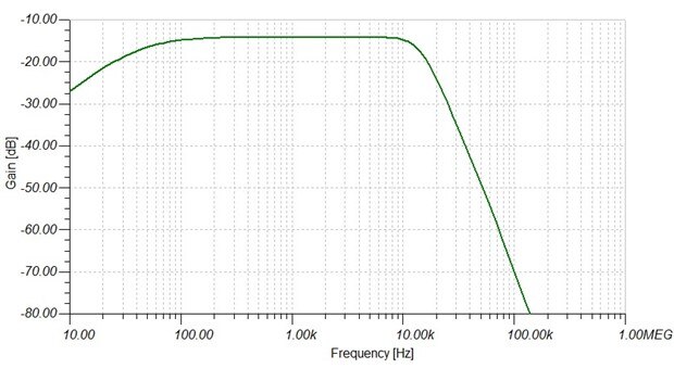

This is what the simulator shows for the overall frequency response:

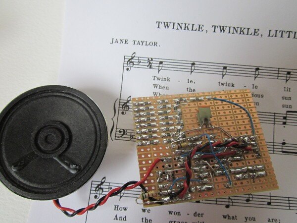

Build
As with the R-2R experiments, I built this one on a piece of tri-pad board.
Here's the board as I built it:

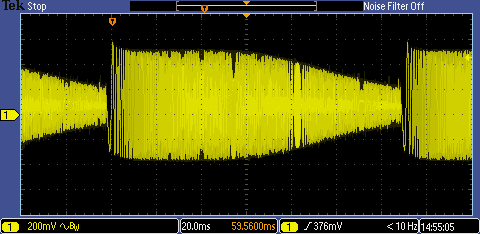

Testing
The starting point for the testing was to simply use the sketches I'd done previously for the audio generator experiments.
Here are some traces from the board.
This shows a sweep from 20Hz to 20kHz and you can see the way the filter slopes off from about 10kHz upwards:

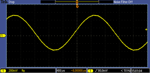

This is the waveform at the loudspeaker terminals (440Hz) - it's kind of sine-like. The little steps on the slopes of the sinewave are the points where the op-amp is frantically trying to get its output to the right place to effect the changeover between the two transistors.

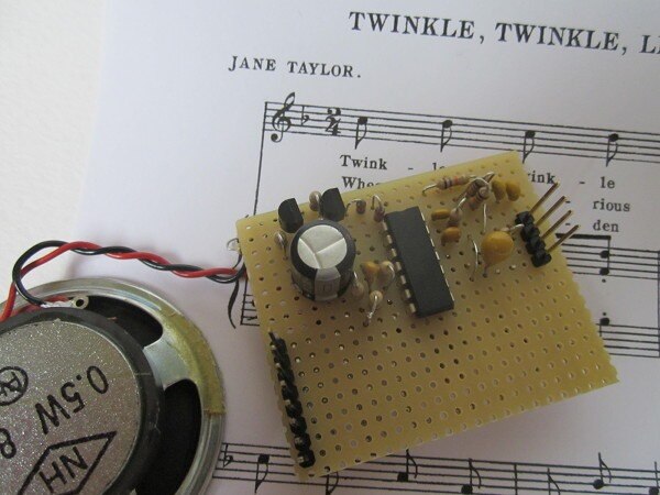

    jc2048 over 8 years ago in reply to 14rhb +5
    This is what it looks like from the end, just in case anyone's interested. If I moved the tant that's almost colliding with the microcontroller, the top board could come down 5mm, or so.
