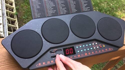

Two commercial drum machine
Components and Methods

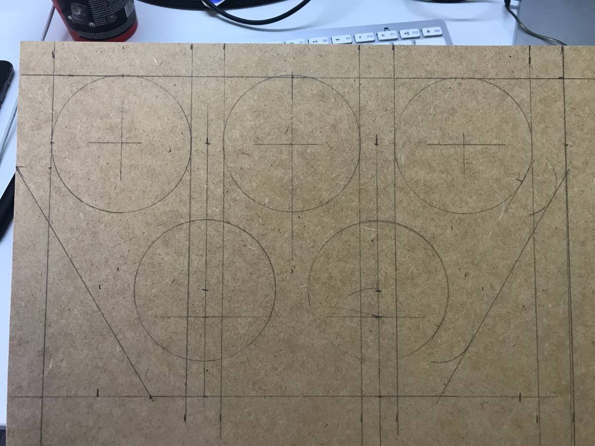

The design of the device and pads diameter (80. mm.) follows the most diffuses drum machines; the image below shows the quoted draft and pads distribution.

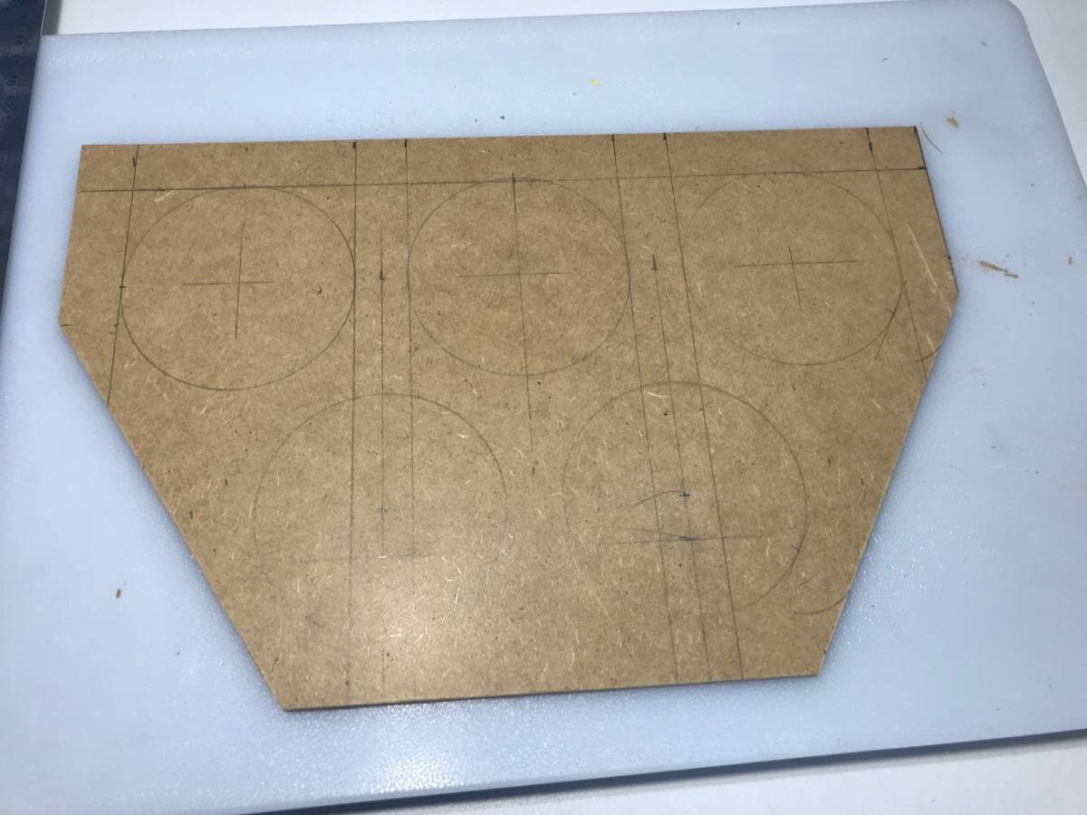

The base and percussion surface, of the pads has been obtained from a MDF sheet 3mm thick, while the remaining parts are built with cardboard.

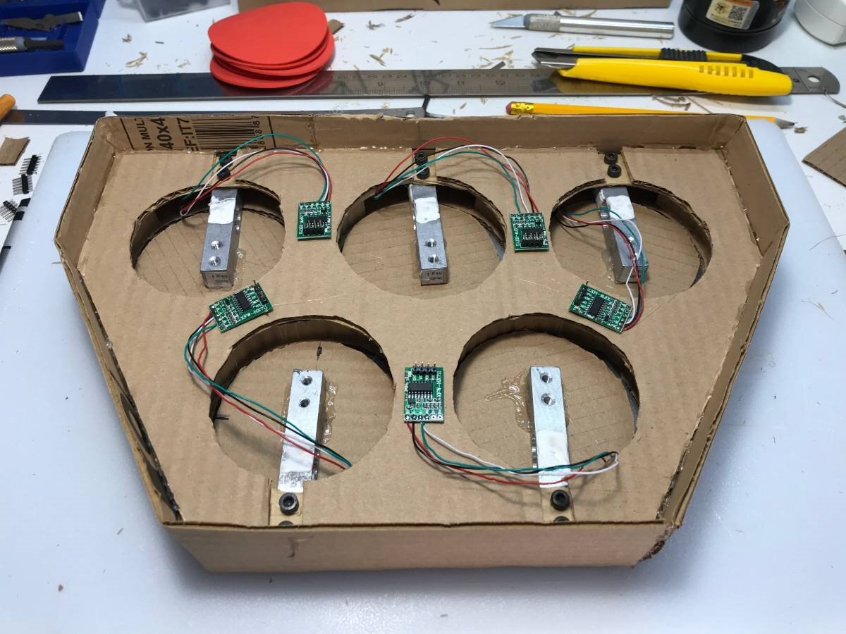

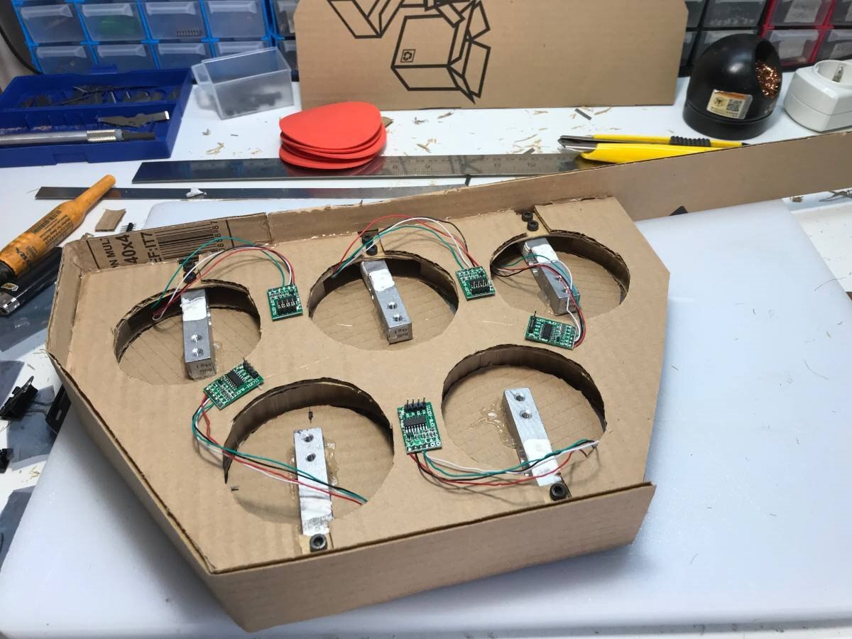

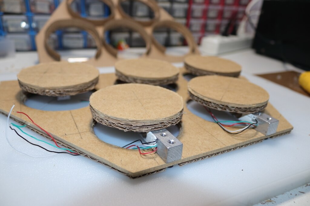

To create the five sensitive pads I have opted for an unconventional solution: a set of five cheap weight sensors. The kit with the sensors, including their A/D amplifiers and converters based on HX711 costs about-5$. All together!
These sensors have a very good excursion, high sensitivity and can measure up to 5kg. All these parameters are in the range needed for the musical alternative use.
The drum A/D HX711 converters and the main connector to the Arduino board

The 3mm MDF base. This will be the support of the weight sensors and pads
Cutting the robust base ...

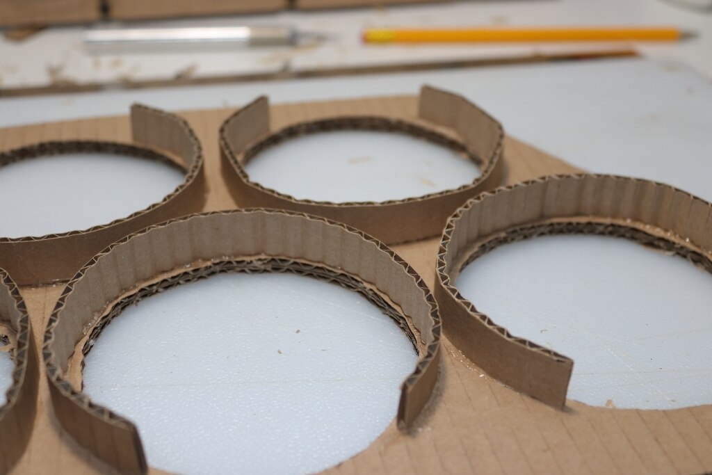

Top view of the bottom side of the pad assembly (top surface)
This will be the surface cover of the structure. The entire forces are discarded on the pads and the sensors support, so this part does not need special robustness.

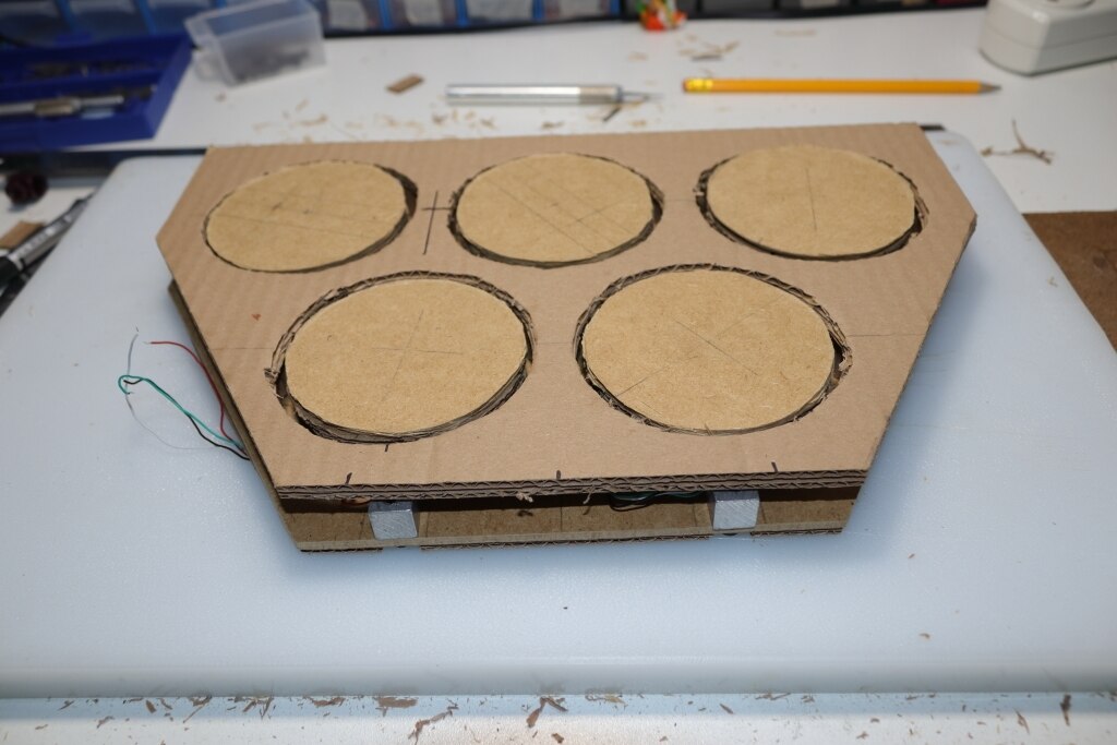

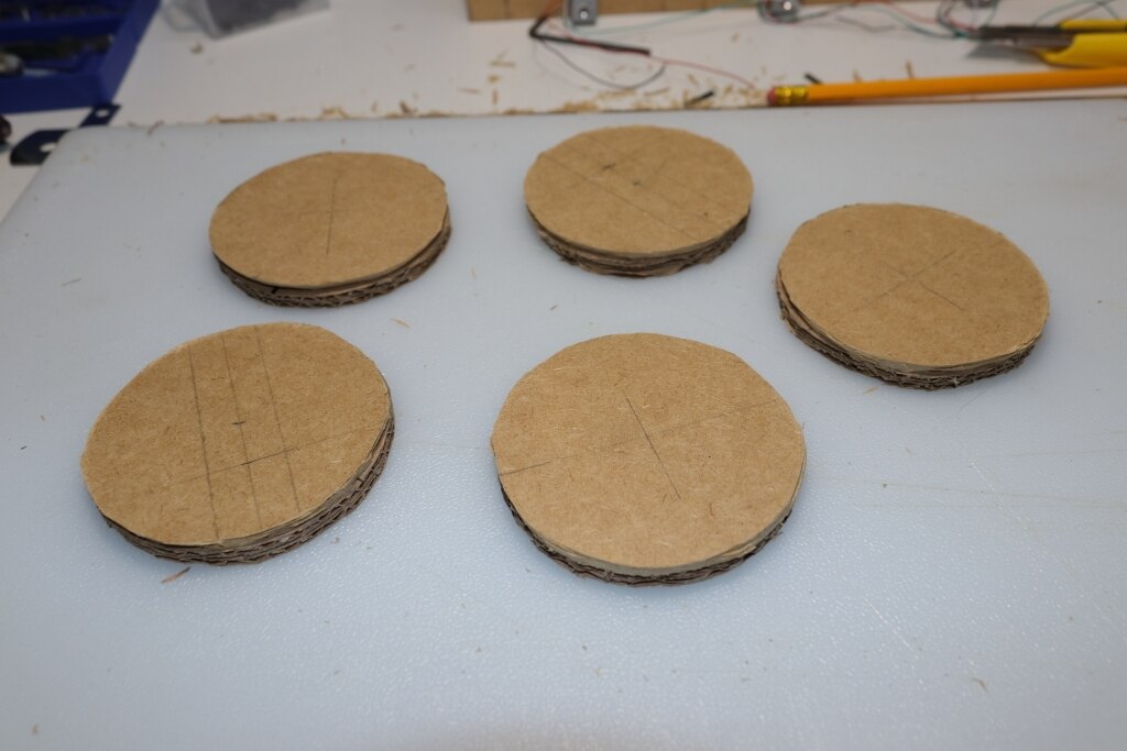

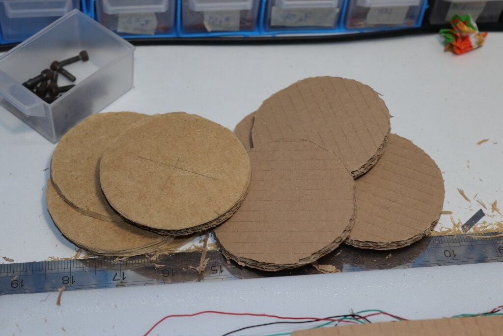

The double-sided pads. The top side is 3mm MDF, exposed to the user interaction forces while the bottom is glued cardboard, fixed on the weight sensors.
The pads ready to be assembled

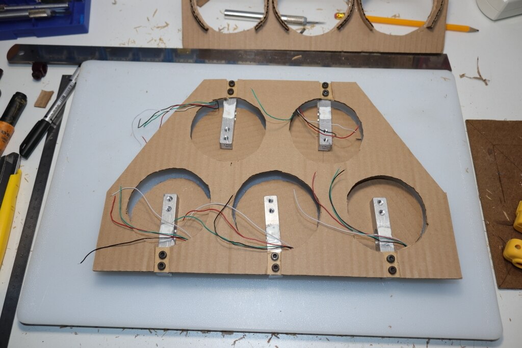

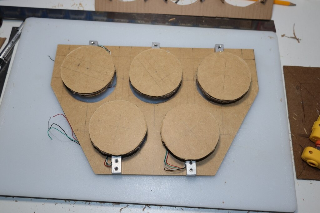

The linear weight sensors screwed to the 3mm MDF base with the pads fixed on top.
Assembled view of the drum pads skeleton. The weight sensors can support up to 5Kg pressure

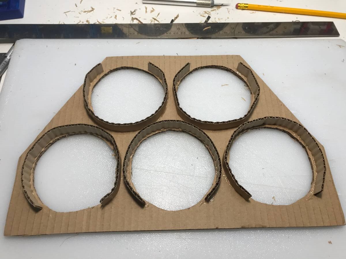

The pads assembled with the cardboard top cover
The 3mm MDF (bottom view) with an extra cardboard sheet glued on it.

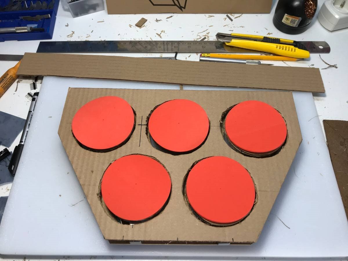

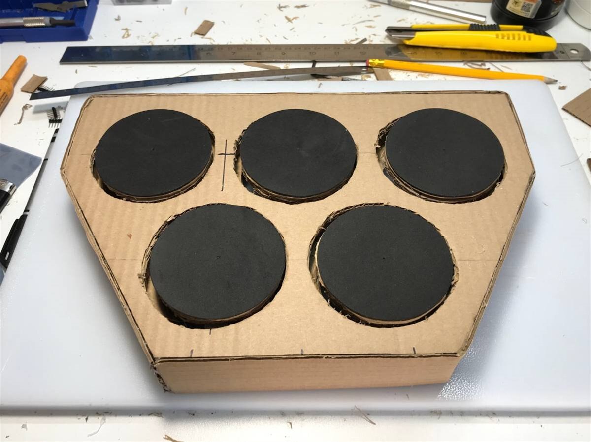

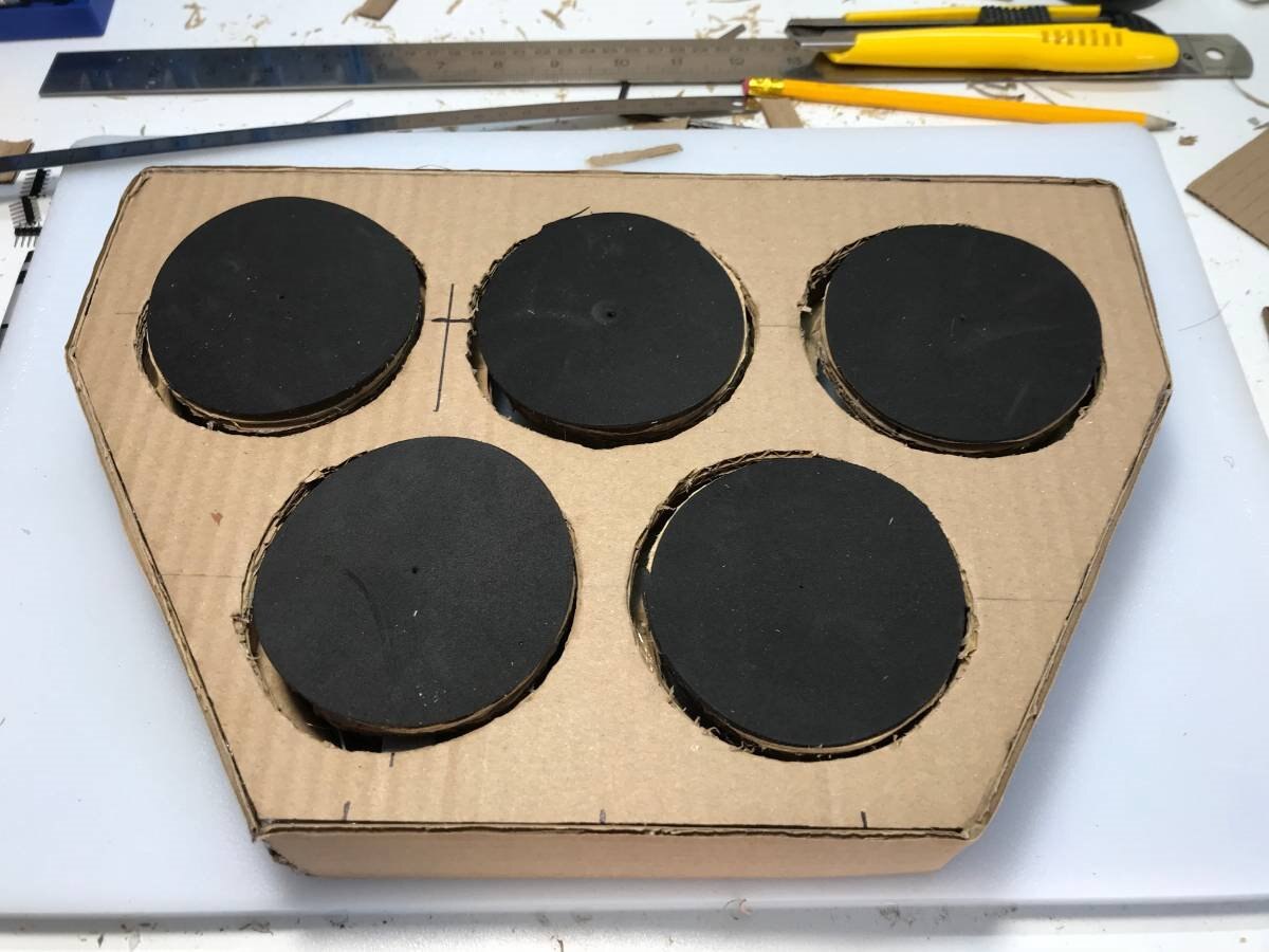

Red pads rubber on top?
Naaa.... Better black, Be serious image

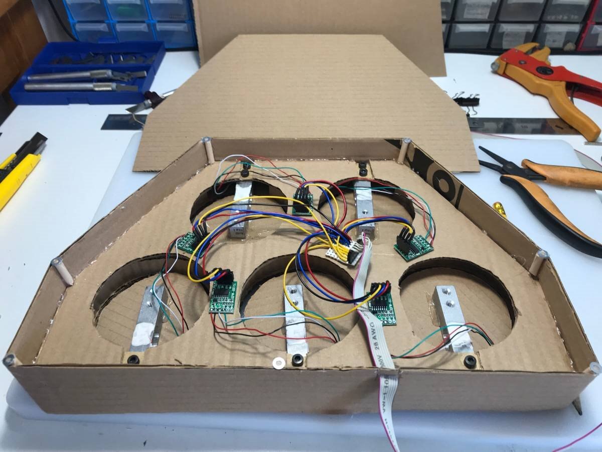

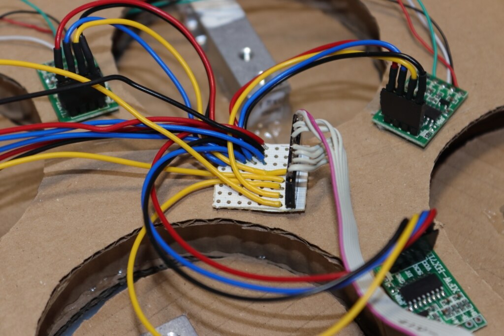

Every pad sensor has its own HX711 A/D amplifier and converter. Around a cardboard border to complete the build
Bottom view of the structure
All te sensors signals collected by a small PCB and connected to the Arduino

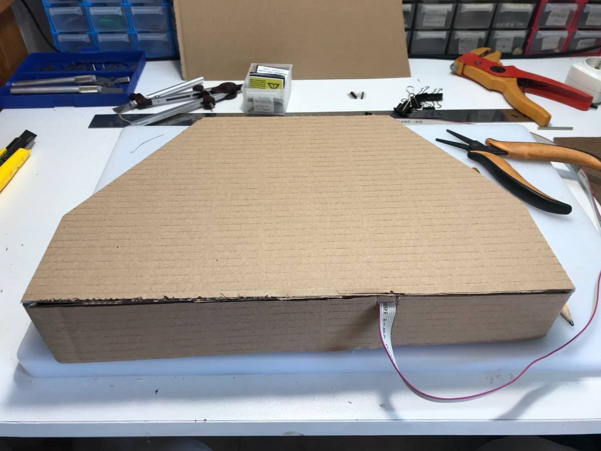

The bottom of the Dum-De-Dum box. Initially the Arduino was external to the box but in its final assembly it is hosted inside the box.
Top view of the finished Dum-De-Dum (the cardboard drum image )

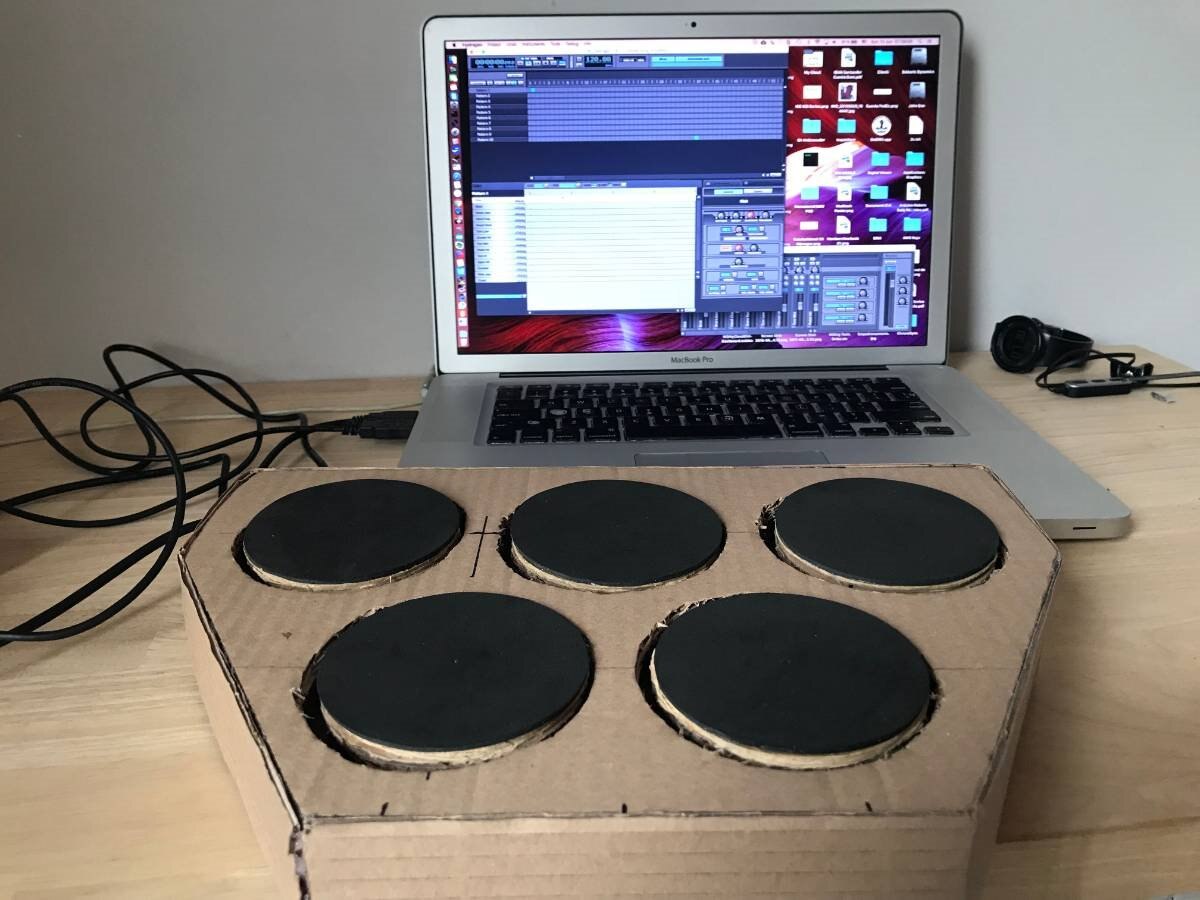

Testing and Playing
The below video shows testing and playing (yes, it's me live playing a random rhythm image ) the Dum-De-Dum. Controlled by an Arduino board, the incoming sensors data are converted to a set of five predefined MIDI notes; the detected pressure intensity for every sensor is converted to a corresponding velocity value sent together with the associated MIDI note. This device can be used for live performances as well as to record rhythm sequences. In the video example the MIDI data are processed by Hydrogen, a great open source multi platform drum application.
The software is available instead on the GitHub repository DumDeDum.
