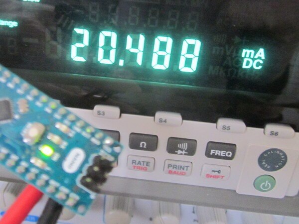

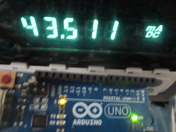

In this week I am testing the solar panels for their current delivery and voltage output under different solar and indoor conditions. This will determine how much load my solar panels can drive and how many devices I can hook up with its power on my solar BOT. And this will determine the selection of the motors to drive the BOT. And a choice between Arduino Nano or Arduino UNO controller should be done.
The power consumption of the Adruino Specifications
Parameters Arduino NanoArduino UNO
Voltage Output3.3V or 5V5V or 3.3V
DC Current per I/O Pin (datasheet)~40mA~ 40 mA
DC Current for 3.3V Pin (datasheet)--~50 mA
In sleep mode (datasheet)--~ 35 mA
Measured Current at no extra load (measured with 10milli-ohm shunt)130mA (powered by mini usb power)300mA (powered by USB A2.0B)
USB Overcurrent Protection (datasheet)-----500mA
The above tests show that Arduino Nano has less power consumption than UNO but is also limited in ports and functionality. But since solar panels are also not able to deliver much current a power hungry controller will not fit the needs of the Solar Bot. So I will carry on further with Arduino Nano.
Fig: Testing Arduino Nano with 10 milli-ohm shunt measuring through 3.3V power pin

  • jc2048
    jc2048 over 8 years ago +4
    The Uno and the Nano are both intended to be 5V boards. The 3v3 header pin is an output regulated down from the 5V. I think they intend it to be used to power circuitry on a shield board (have a look at…
  • snidhi
    snidhi over 8 years ago in reply to jc2048 +3
    I only measured the current directly in the 3V3 and 5V power lines after powering from USB. Cool thanks I will check the I/O lines.
  • snidhi
    snidhi over 8 years ago in reply to nirmal2000 +3
    Thanks
  • jc2048
    The Uno and the Nano are both intended to be 5V boards. The 3v3 header pin is an output regulated down from the 5V. I think they intend it to be used to power circuitry on a shield board (have a look at the schematics).
    These are the supply currents I see if I power each board directly with 5V (ie not bothering with the regulator down from Vin). That's with a program running but no IO attached. The input regulator would only add a milliamp or so to these figures, though it's obviously wasteful of power because of the voltage drop.
  • snidhi
  • snidhi
