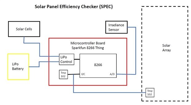

We're at the last day of the Heat is On Challenge.
Here is the initial block diagram of my project:

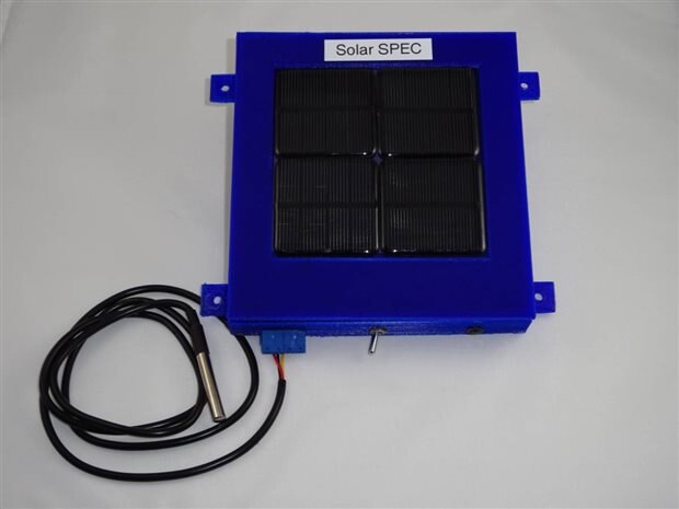

I've implemented all of the hardware elements with the exception of only implementing a single temperature sensor and changing the sensor type to an 18B20 probe.  Unfortunately, I haven't deployed the unit to my rooftop solar array yet because I am still testing and tweaking the design.
SPEC Final Hardware:

Please reference previous blogs for design details.
Summary
I am reasonably happy with the outcome although I know that it is only the beginning.  At least now I have a method of direct feedback of the environment of my solar array.  Only time will tell how useful this information will be.  I would like to eventually get to the point that I could accurately estimate how much total power I should be getting from the array (by using the irradiance and panel temperature).  I'll probably be surprised at how hot the panels are getting.  That's something that I had never considered before.
I need to incorporate some power management in the firmware (at the very least stop transmitting when the irradiance is low).  I'll need to implement that before I deploy the unit.  There were rainy periods last winter where the array would not even generate 1kWh for the full day.
I also realize that my printed PLA case is not rugged enough to survive an extended period on the roof.  I think what I have will allow me enough time to evaluate the design.  When I rev the design I'll try to find an outdoor electrical box that is more rugged.  I'll need to stay with plastic since I'm using WiFi.

    jw0752 over 8 years ago +3
    Hi Ralph, I enjoyed following your project. You may find that the proper coating on the plastic PLA will block the uV light and extend the life of your printed case. I too hope you will followup so we…
    Hi Ralph,
    I enjoyed following your project. You may find that the proper coating on the plastic PLA will block the uV light and extend the life of your printed case. I too hope you will followup so we can see the continuation of your project.
