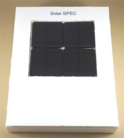

Project Case Mockup:
Here's my initial attempt.  It is 6" x 8" x 1" (W x H x D).  Seems a bit large, so I'll probably shrink it after I locate all of the components.
Haven't decided whether or not to include a display.  The 4 solar cells are inset at the top.  The lower area is for indicators, switches and maybe a display.  Jacks and/or connectors would be on the top or bottom side (probably bottom).  Since this will be outdoors it will need to be reasonably watertight.  And I need to figure out how to attach it to the panel racking so that the cells are in the same plane as the panels.

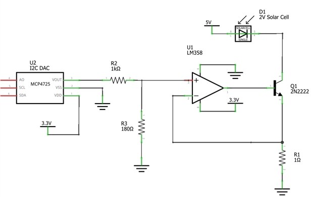

Reference Cell characterization:
I need to characterize the solar cell that I will be using as the irradiance sensor so that I get a reasonable correlation to the Daystar meter.  I am going to build a V-I test circuit that will allow me to quickly generate the V-I curves for different irradiance levels.  Since I am only characterizing single cells, I can limit the range that is required by the circuit.  I am going to use a simple opamp current sink that will be controlled via an I2C DAC driven by a microcontroller (probably an 8266 so that I can measure the load voltage with its ADC and also send the data to a remote logger).  The circuit should have lots of margin since I am only looking for 2V @ 200mA.
