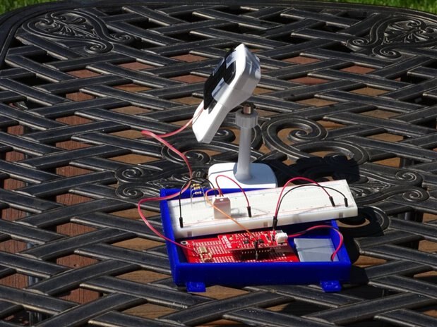

Test setup
For my initial test I wanted to check the accuracy of my irradiance reading against the Daystar meter and also compare the data to my inverter readings.
I set up the unit on my deck which is to the west of my house.  This area gets shadowed by my house in the morning, but one of my array strings also gets shadowed by my neighbors tree in the morning so this location is adequate for my window of comparison.  I just realized that I took this picture before I had correctly configured the tilt on the cell.  I attempted to mimic the panel orientation on the roof.

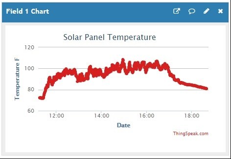

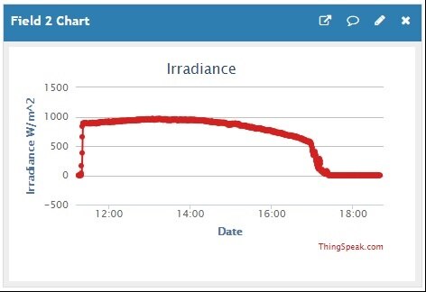

ThingSpeak Plots

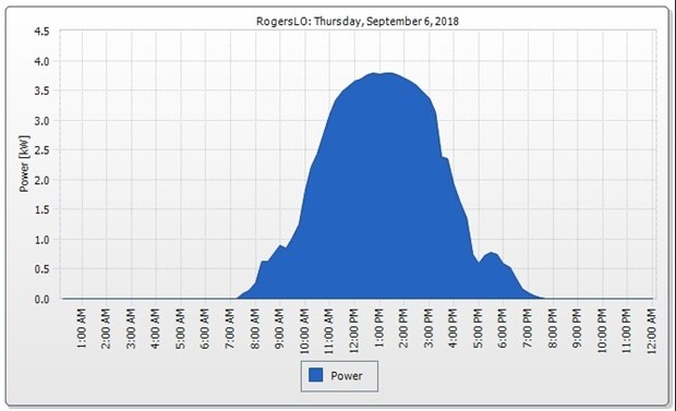

SMA Inverter Plot
From the inverter plot the valid time window for comparison is from 11am to 3pm.  This is Oregon, so the good news and bad news is that there are tall trees and I get shadowing both in the morning and afternoon (except June thru August when the sun is directly overhead).  You can see from the ThingSpeak Irradiance plot that my deck gets shadowing before 11am and after 5pm.

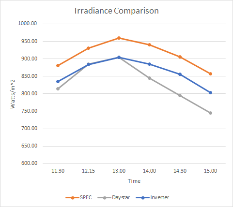

Data Comparison in Excel
I normalized the inverter power numbers so that they would match the peak Daystar reading.  I'm somewhat confused by the data.  I can believe that I have an offset that I need to correct for the SPEC, but I'm not sure why the Daystar readings and the solar array power don't track.  I realize that I don't have the temperature component included yet, but it's more probable that I've made a measurement error (the Daystar reading is not automated).
