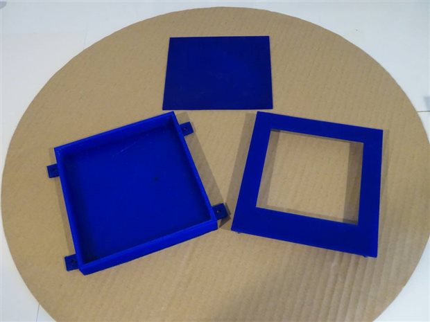

I'm a little behind starting the build of my solar project.  Still having some problems with my 3D printer.  It is starting to show its age (I built the kit 5 years ago).  The heated bed has developed a slight bow, so I'm having issues with prints larger than 100mm x 100mm.  Anyway, I managed to print some functional parts for the case and I've started to assemble the pieces of the unit which is 140mm x 160mm (not including the mounting tabs)..
3D printed case parts (wanted to print in white, but my white filament is bad):

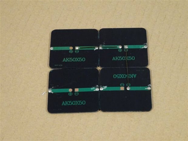

Started wiring the solar cells:

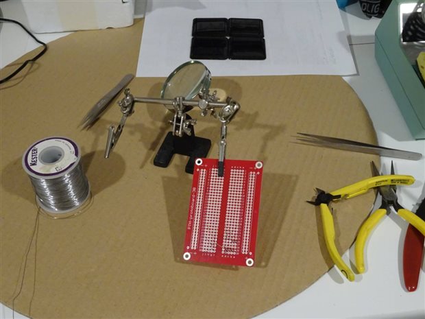

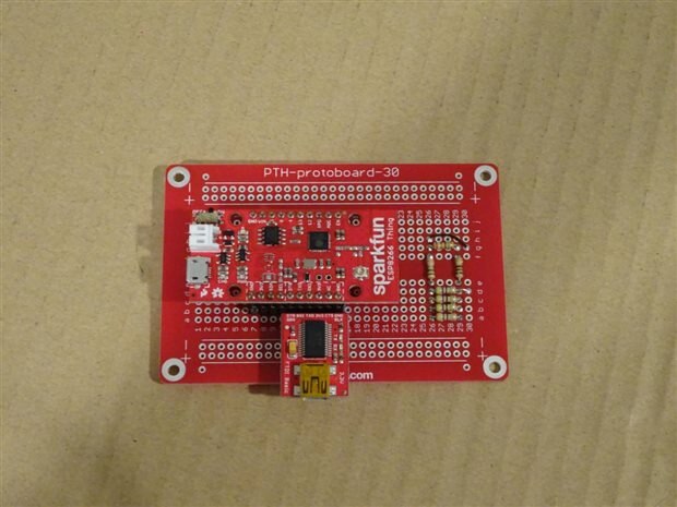

Started assembling the breadboard that holds the 8266 Thing:
Here is the breadboard with the 8266 Thing mounted:
Resistors are for the reference cell load and the A/D input divider.
The small board is the FDTI USB programming interface (it will be removed after I'm done).

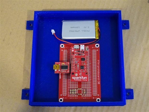

Here is the board assembly and LiPo battery in the case:
I still need to figure out how I want to attach them to the case.

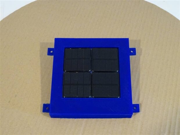

Here is the assembled case with the solar cells:
