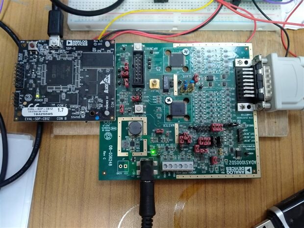

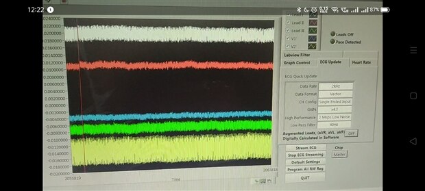

I am working on ADAS1000SDZ EVAL-BOARD, with EVAL-SDP_CB1Z board to test ECG signal or Stream ECG signal on Desktop.
I am trying with External ADAS SPI connection (with J4 Header) as well as. but Still I am Not getting Any Valid Data.
Here I posting Some Photos and Video That I am Getting During Test.

    Jan Cumps over 5 years ago
    Can you check if the metal screws you used do not contact any pins or copper?
    Also verify that they didn't damage the pcb, when screwing them in.

    yes, Metal Screw Not touch with any pins
    thanks
  • nitish378
    nitish378 over 5 years ago in reply to Jan Cumps
    I Have Two ADAS1000SDZ board. I have Checked with Both, still Same Problem
    DAB over 5 years ago
    Are you using battery power?
    It looks to me like you might be getting power supply noise on your DC voltages.
    This is a common problem with medical devices, which is why they have very stringent noise filter requirements.
    You can also get this type of noise from lights.
  • nitish378
    nitish378 over 5 years ago in reply to DAB
    Yes thank you so much sir.
    When I replaced power source I get clear ecg.
