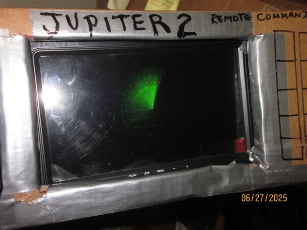

I found a freeware site for radar mp4s , and I lost the link to it, intending to provide the artist credit.  Using MovieMaker to add the sonar ping audio mp4 , https://pixabay.com/sound-effects/search/radar/, (another bit of subtle humor) and looping the radar video for a couple minutes play time rather than strictly relying on RPi for cycling.
Experimenting and getting the VLC to play a video was a challenge in itself, Raspberry Pi 3 had issues updating my big HDMI monitor (I cant read the 7 inch display well enough to write python code on it)  so I replaced it with a RPi4. New/old issue, the RPi4 had been used for a facial recognition demo project, also had old SW,  another round to reformat the SD card, reload raspian, and try to remember the myriad of python libraries I assume are already loaded. No wonder these projects get shelved.

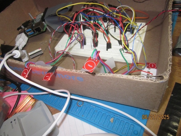

By the way, using Arduino IDE, C code sequencing can be written just like writing a boolean logic equation or its ladder logic equivalent, but python.....no way buster. The Logic_py library didn't cooperate installing, so I changed the input pushbuttons from tp223b to tp223. The logic doesn't work exactly the way I want, but gets the job done.

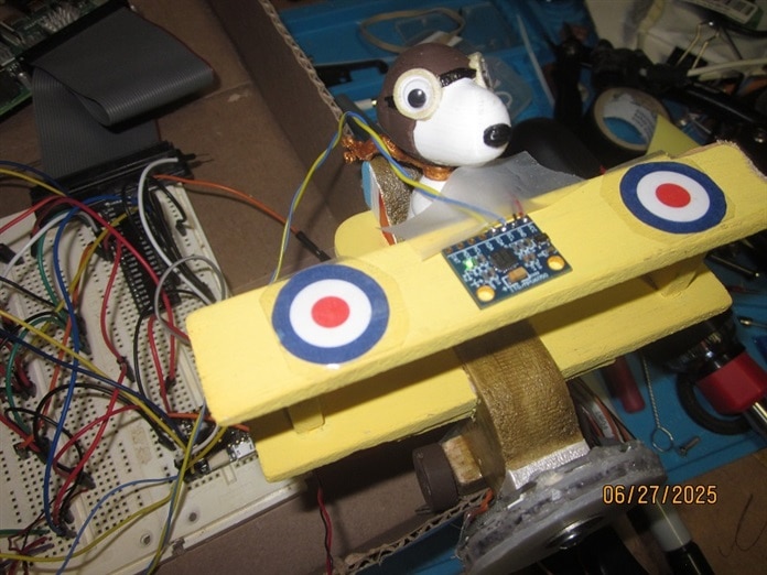

In the meantime, MPU6050 and HMC5883 will be used for sensor data. The RPi can see those on i2c and data can be read from them. That MP6050 open source code is from machinelearning.com , the HMC5883 is from how 2 electronics.com
Another library I wanted to leverage was Logic_Py, it also complained but maybe is not compatible with raspian load or my understanding of python environments ?
bharath5673/inclinometer gauge created an open source code for the inclinometer using openCV , which I did get loaded and it works ! sadly it takes many seconds to load and print the display to the screen, and I hadnt even modified the gyro sensor variables to it yet. Its a nice example, and I may have to use tKinter (and my no knowledge learnng curve) .

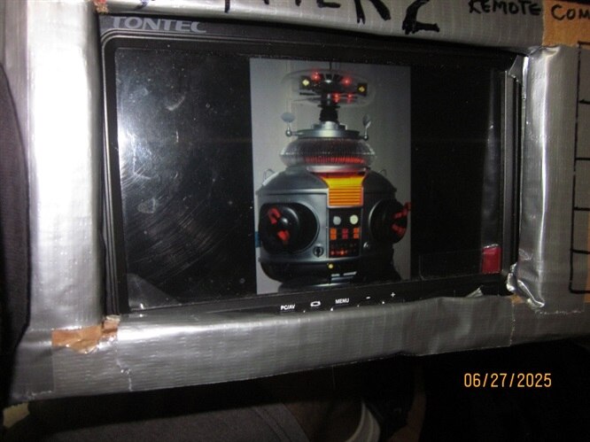

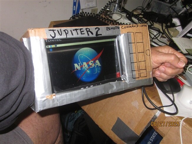

Leap to the Present State of the Forearm mounted Command Console
Here is a video of the functioning mockup and functioning of 2 videos controlled by TP223 touchswitches and some photos. The video also shows live data of MPU6050 and HMC5883
https://youtu.be/g07QjJwAnh8
