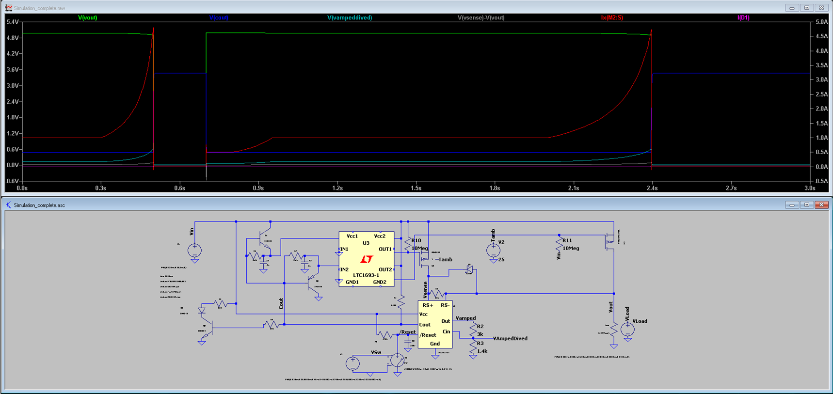

I don’t exactly remember how I ended up selecting the MAX4373 but looking at its datasheet, my “cost cutter” mind thought that I could measure the series resistor of a MOSFET and thus save on components count as over current signaled by the comparator would then simply turn off the N Channel MOSFET. But what came up quite rapidly was that this is an almost impossible task, especially because of the requirement to drive the N channel MOSFET from the high side, which brought the LTC1693 chip into the picture.
And because coming by precision shunt resistors for large loads was very expensive, there are two MOSFETs in parallel, both in series with the load, so that a small part of the current is going through a relatively large resistor used as the sensing element for MAX4373.
As this was quite a step up from the circuits I had created before, I decided to simulate them and LTSpice was at the time the only viable option for a hobbyist not capable of forking hundreds of dollars just for software.
For reference here are the LTSpice results for the 5V over current protection:
LTSpice Simulation
This was discussed in NNTP newsgroups but this is also about that time that I heard of Element14 and that I registered to start asking questions about my little project. Sadly, but not surprisingly, there are no traces of this anywhere to be found easily.
The discussion led to a partial redesign where I would use an ATX supply instead of AT which was already old even in 2010. This meant losing the built-in -5V but that’s something that I solved by placing a 79L05 on the -12V line with just stricter current limits on it.
And for good measure, I also added a voltage reference with a LT1460 chip alongside a variable voltage/current source based on the “Lab supply” typical application described in the LT3080 datasheet.

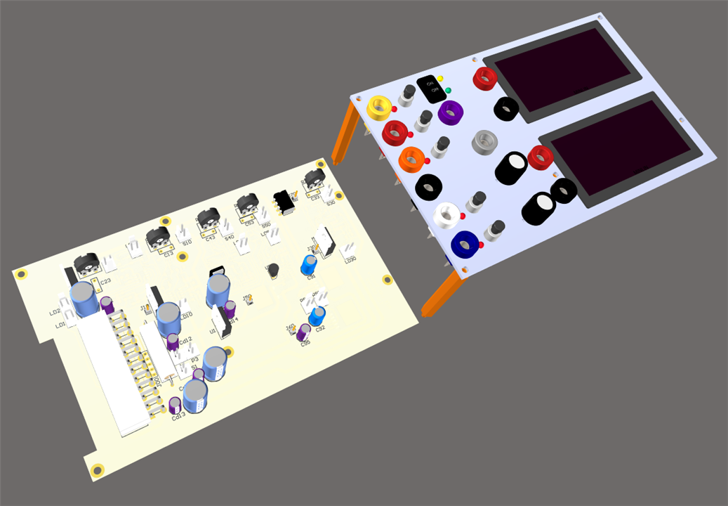

With all this settled, I decided to design my own PCB for it, along with full 3D models so that I could “view” the result before I ordered parts for it. This was because of being burnt before on other projects where components would collide with buttons or were not getting out of the case the way I wanted things to work, which lead me to the following 3D render of the setup:

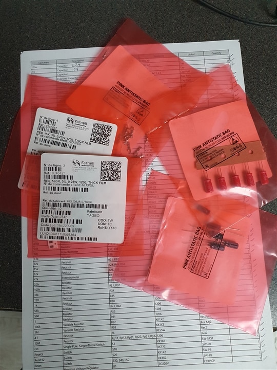

To my great surprise, only four references were missing! But I also discovered that I failed basic math in 2010 as I ordered 20 crimp contacts for the 20 2-pin connectors that I need…
One order on the Farnell website later, I was able to check every item on that list:

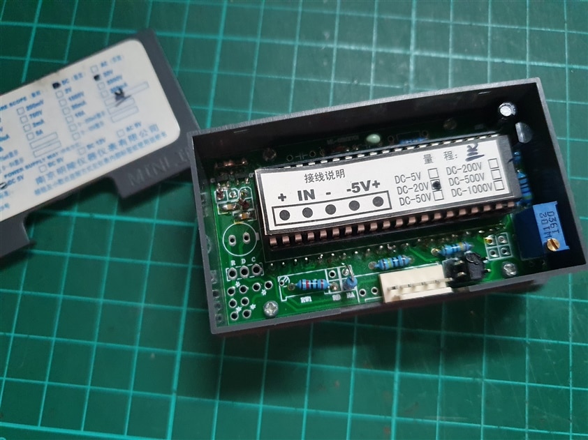

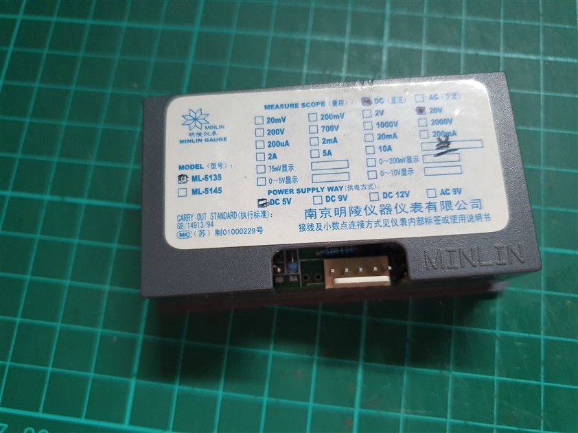

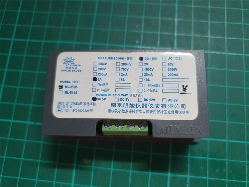

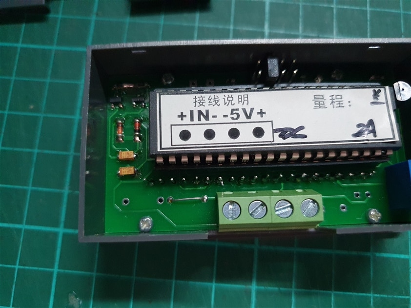

Next step was to identify the wiring of the two “meter” modules. As you can see on the pictures below, there are no markings on the outside of the housing to indicate pin assignments:
 I knew from a distant memory that I had gathered that information when I bought them, but I could not remember it, nor a place where I could have written it down. As a last resort, I decided to delicately pry them open in order to “trace” the pins to whatever is inside. But luck was with me on that one as there is a sticker inside that gives exactly that information:

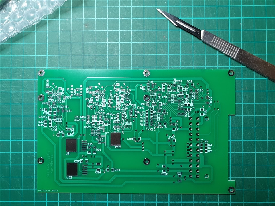

But for the PCB, I still was in the mood for going the old way with toner transfer and H2O2 + HCl etching. This worked very well for me in the past, albeit on simple circuits. But the traces complexity and the fact that the laser printer is on the verge of dying made me look for other options.
In 2010, that meant paying about 150€ for a custom-made PCB but the landscape has changed quite a lot during the past 15 years and it’s now really cheap to get those online for a tenth of the cost! Here is the board, as produced overseas and sent to me in about 15 days:
Before assembling, and just to get scared, I installed the latest LTSpice version and reran the simulation shown above and… it only gave me flat lines! Let’s hope that’s just a glitch with the new version!

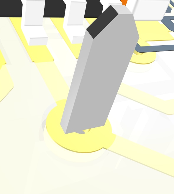

What came up quite early in the assembly phase is that most thru hole pads had a too small opening when compared to what the component itself needed. Some were due to margin errors, but for some, it was definitely a problem between the chair and the keyboard as it was quite clear on the 3D view that it would not fit:
And so here is the first step, redrilling most holes. Sadly, for the potentiometer legs shown above, this meant the pad was completely destroyed in the process! I thus had to expose the copper trace next to them to allow soldering the component, which I did with a fiber glass pen. I had never used such a tool, it’s much easier to use than trying to scrap the protective layer with a scalpel blade.
To make sure I did not forget any holes, I dug up the pack of unused transparent sheets that I used during my student years (twenty-five years ago…) and made a reference that I could place above of the bottom layer.

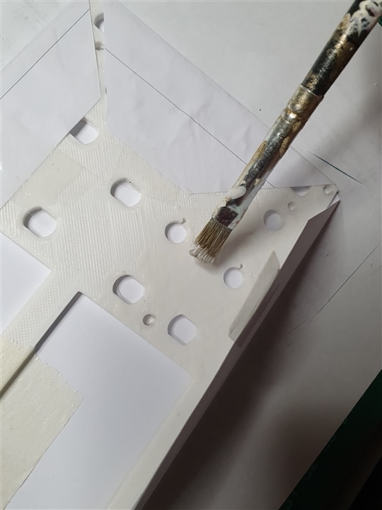

And with all that, it’s time to construct the front panel. First thing is to add nice looking markings next to each connector. I went with what I have at and, being a laser printer that gave me a nice sheet of paper that I wrapped around the front face and glued in the back:
And while the wood glue is drying quite fast, I wanted to make sure it would not come off later on so I sandwiched the panel between two of the five PCB that I ordered and added pressure for a whole night:
I knew that it was worth keeping those books from my student years!

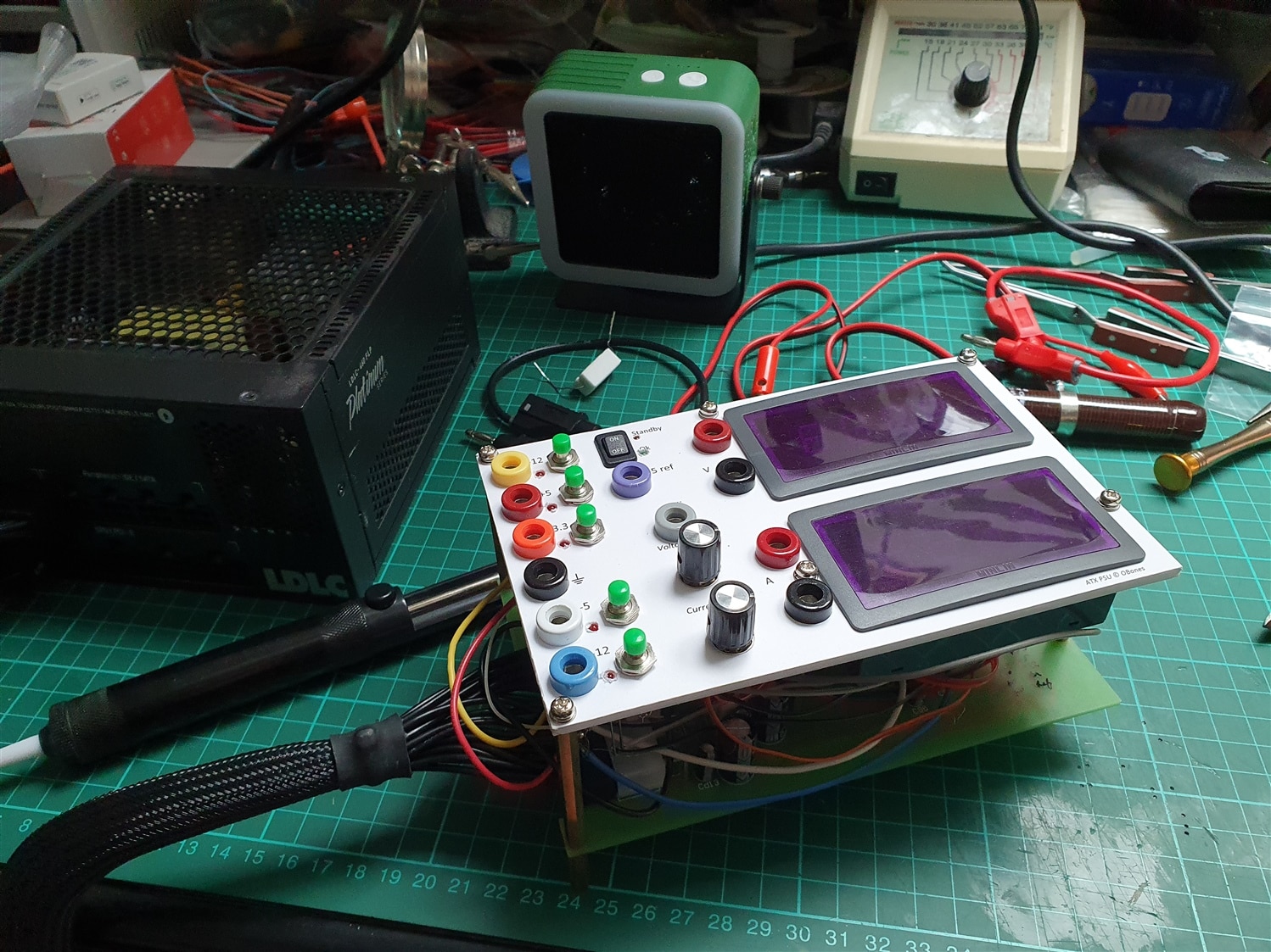

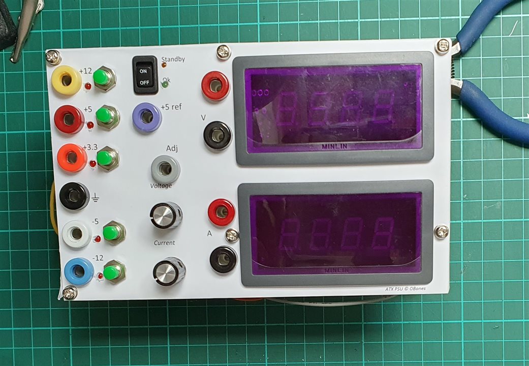

Now, we can place everything on the panel:
In the end, this gives a nice-looking panel:
Powering it up
With everything attached, after a quick check that no power rail is directly touching the GND pins, it’s time to plug the ATX connector and see if this works.
But one thing that came up immediately is that the “male” ATX connector has a detachable 2x2 part with a protruding plastic bit to keep it in place. This is usual on those connectors to be compatible both with ATX20 and ATX24 motherboards, but I did not anticipate it to be so big that it would prevent the connector from fully mating the female part. Running the notch in the PCB up to just beneath the connector would have been a good idea.
Luckily, I had another left over ATX supply where the protruding plastic part is much smaller and was thus able to plug it, turn on the power on the PSU and… it did not go “poof”!
As seen in the video, the -5V fault signal is on but the voltage is still there, meaning that the control circuit for this part is not working.
The voltage and current meters were bought specifically as the “4 wire” versions with the assurance from the seller that they were capable of measuring voltage /current unrelated to their power source. Sadly, this is not the case because leaving the “GND” part floating does not prevent them from working, and we don’t read 7V when using +5 as the reference when measuring the +12V line.
The +5V Ref signal is read as less than +5V when the datasheet says it should be within +- 0.075% to the expected reference, meaning the voltmeter is, unsurprisingly, a bit off in its measurements.

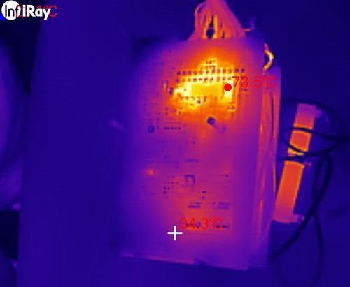

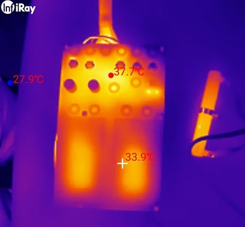

Using the thermal camera from the “Tools and Techniques for Photovoltaic Systems and Solar Arrays” webinar, I can clearly see one hot spot:
image image image
As my office is under the roof and the weather is hot those days, room temperature is at 28°C. But it’s quite obvious the load resistor is very hot, which surprised me as I did not expect the 5W resistor to reach more than 150°C!
In the original order from 15 years ago, I also placed a 3ohms 50W variable resistor to act as a test load. In this thermal video, we can see it heating up when connected to the +5V line, quickly reaching 40°C:
Looking again at the load resistor value, I saw that with 4.7ohms on a 5V line, it meant about 6W going through it, a 20% increase to its rated power. In a stroke of genius, I had also ordered a 27ohms 5W resistor in 2010 and so made a quick replacement. With 5 times less current going through, the dissipated heat is much more manageable.
