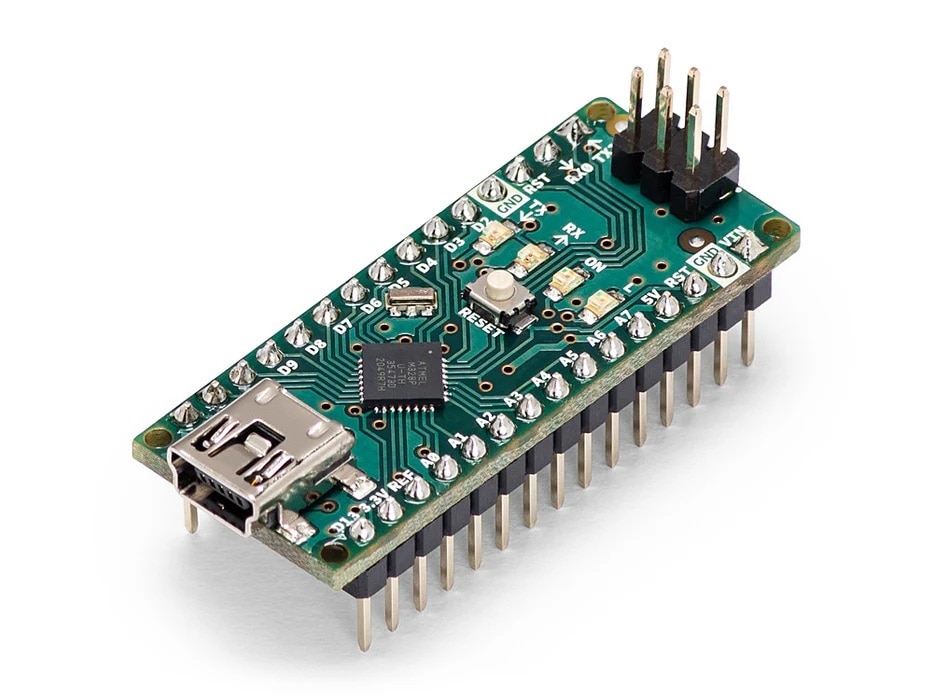

  1. Arduino Nano

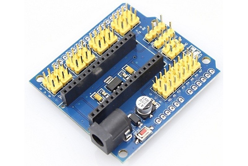

  2. Arduino Nano I/O Shield (Recommended but not mandatory)

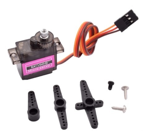

  3. Micro Servo SG90 (Metal Gear is recommended)

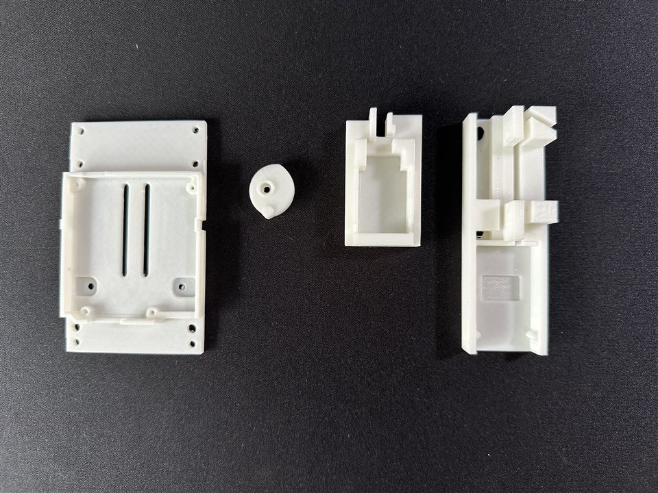

3D Design & Printing

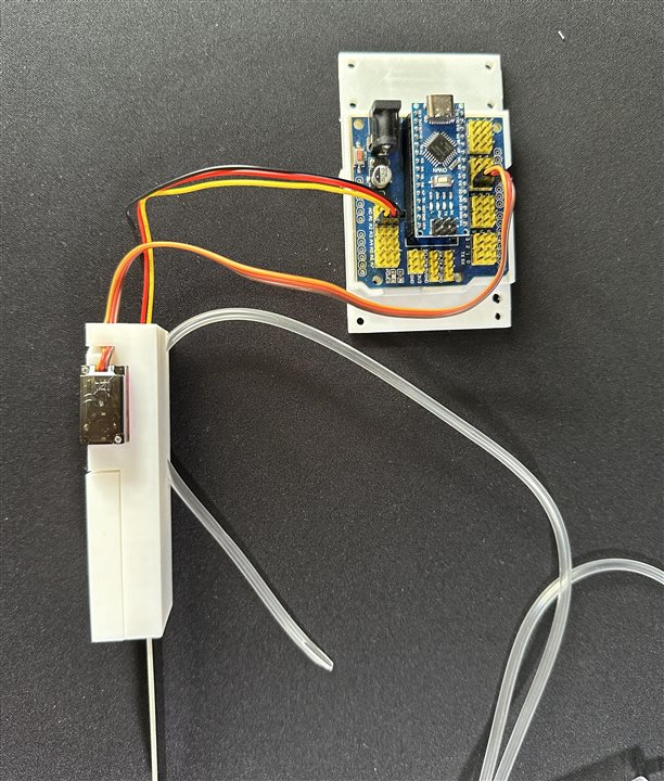

Watering can be done at a regular interval or can be based on the soil moisture. I took the second option to save the water and for this a moisture sensor is required. So, I made a 3D model for housing the sensor, a micro servo motor and a path for the water pipe. The logic is that, moisture sensor will read the moisture content of the plant pot and based on the moisture content the servo motor will rotate to block or allow the water flow through the water pipe.
I designed all the 3D file in Tinkercad.com because this is a platform where you can make a 3D design without any training. I uploaded all the design files in thingiverse.com. You can download the file from the link below:
https://www.thingiverse.com/thing:7057009

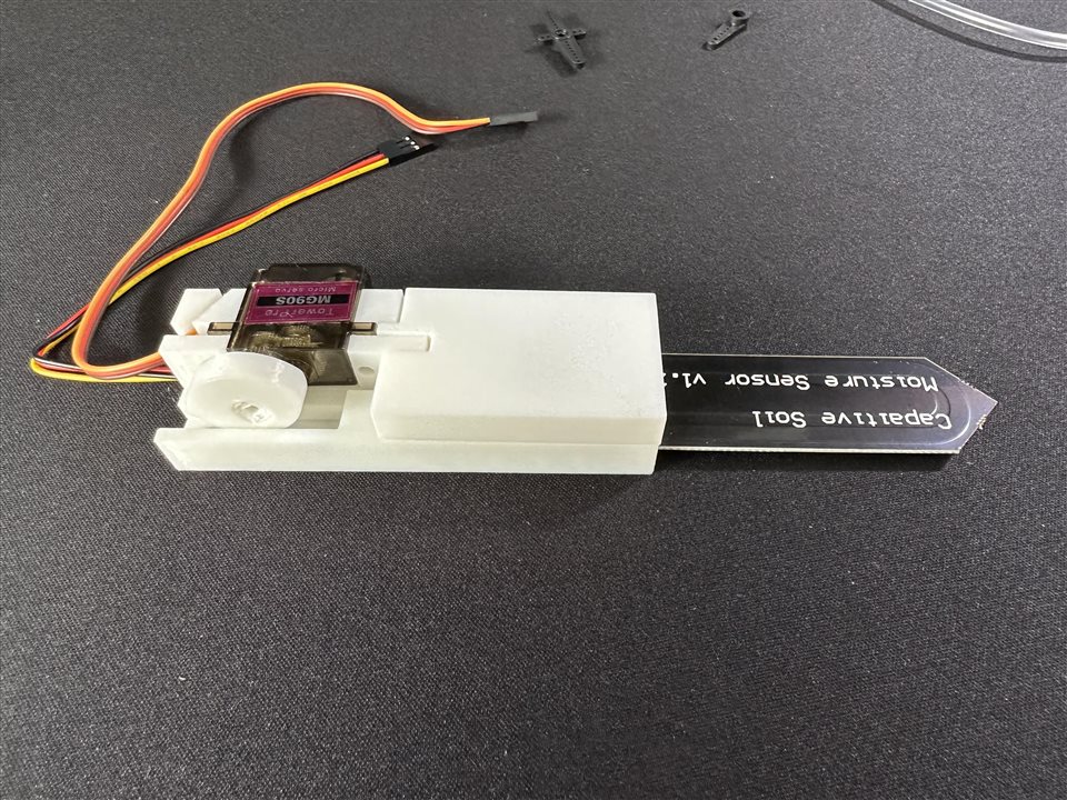

After 3D printing and collecting all the other parts, the next thing is the assemble the parts. Assembling is very easy and I uploaded a assembly video in a later step. To assemble follow the steps below:

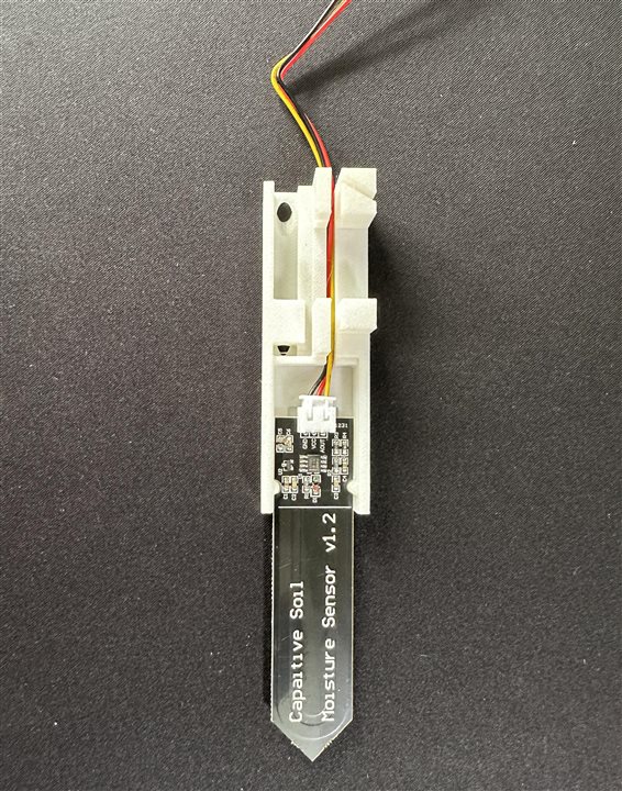

First you need to insert the capacitive soil moisture sensor to the 3D printed base as shown in the images below:

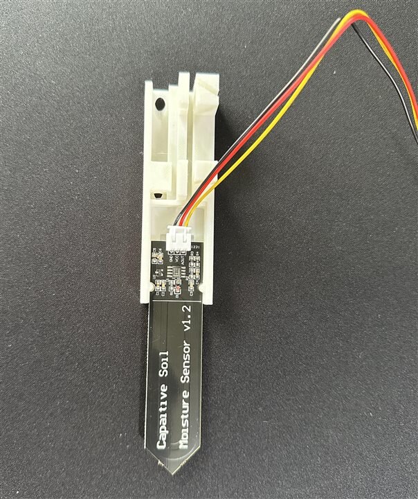

Organize the sensor cable as shown in the image below:

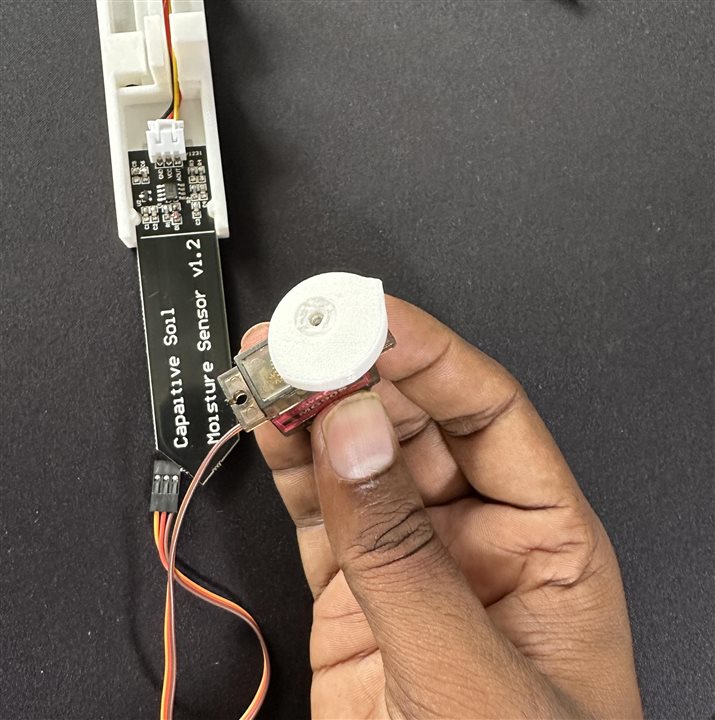

The next step is to insert the pully to the servo motor and adding the screw.
Then you need to place the servo motor to the servo slot and fixed it in the position with two screws:
Now you can place the top cover as shown in the image below:

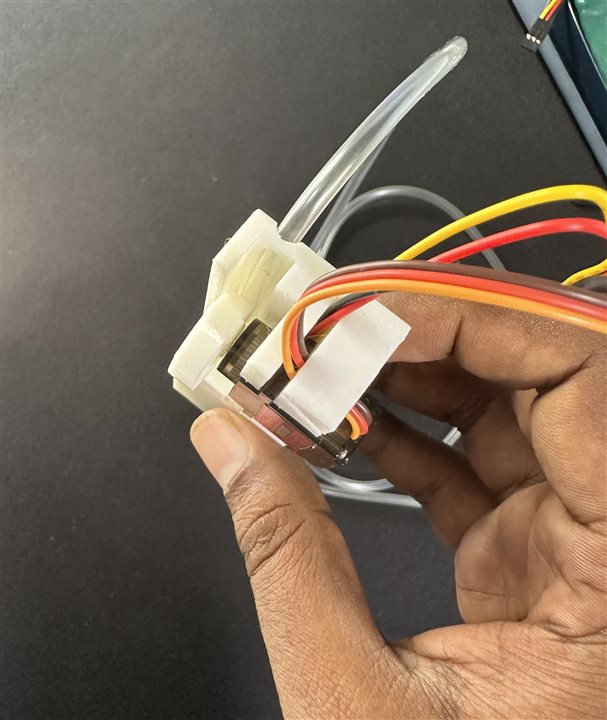

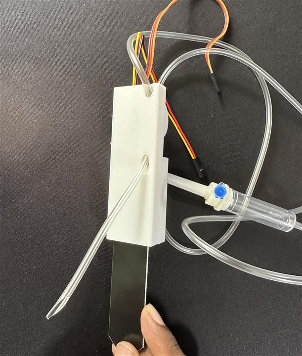

Finally you need to insert the water pipe under the servo pully for testing purpose. Inserting the water pipe is very easy. You just need to push the pipe through the top hole towards the the bottom hole. It will automatically follow the path.
Connecting & Testing

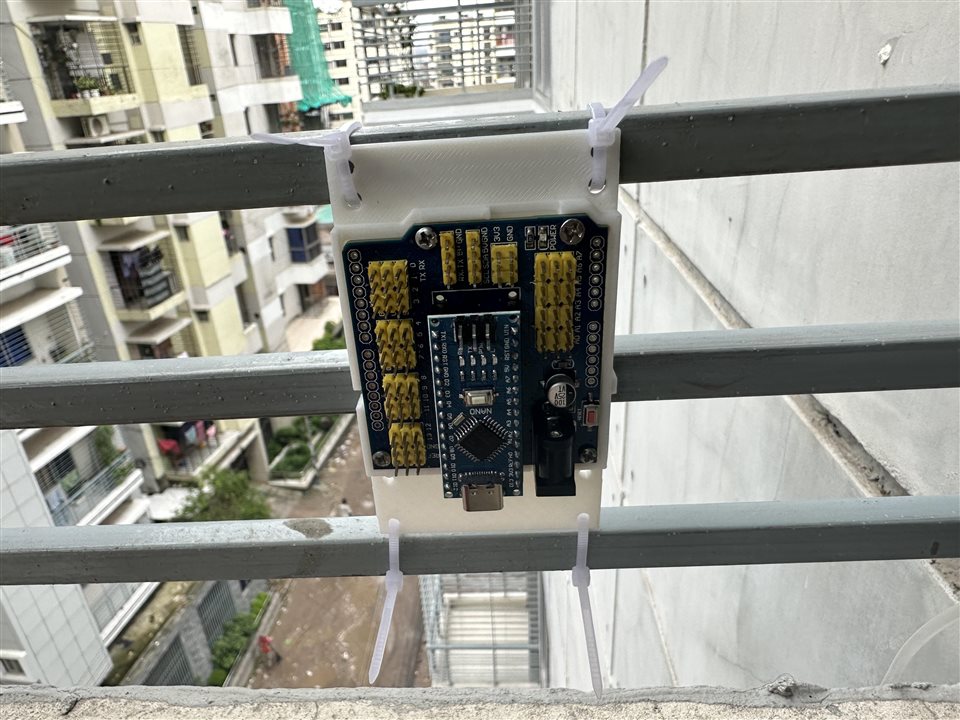

Senor unit assembling is completed and now we can test it by attaching with the Arduino Nano. For avoid any soldering I used Arduino Nano I/O shield for connecting servo and the sensor. We can use up to 8 sensor units for 8 plants using a single nano i/o shield. We need 8 analog pins for eight sensors and eight digital pins for attaching 8 servo motors. For each sensor unit we can use any analog port (A0 to A7) and any digital port. You just need to modify the Arduino code accordingly.
I make the system for my two plants and I used A0 and D8 for first sensor using and A1 and D9 for second sensor unit. Each plant pot needs a separate sensor unit for independently watering the plant.

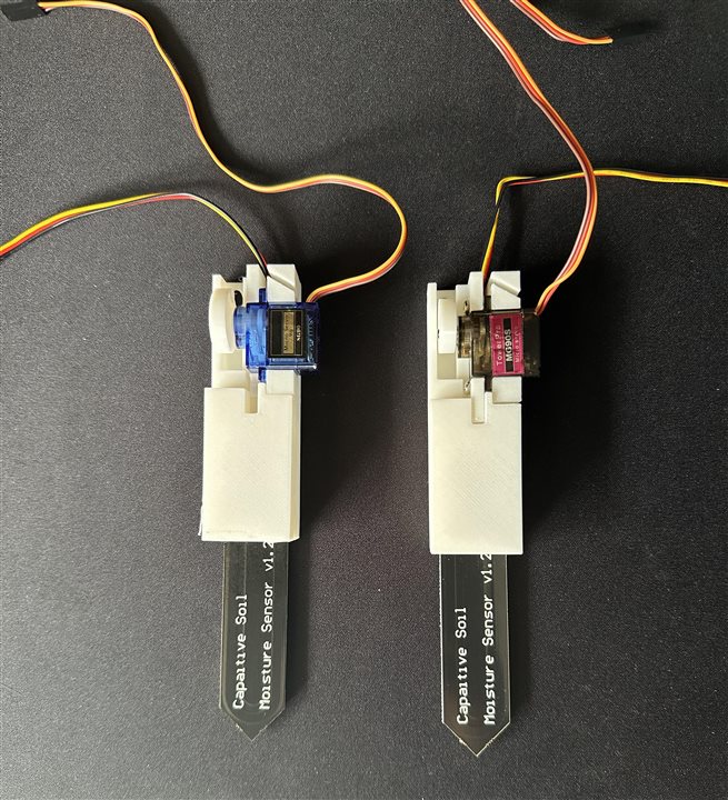

My two sensor units after assembly:
I also made a 3D base for the Nano IO shield so that I can place it at any convenient place.

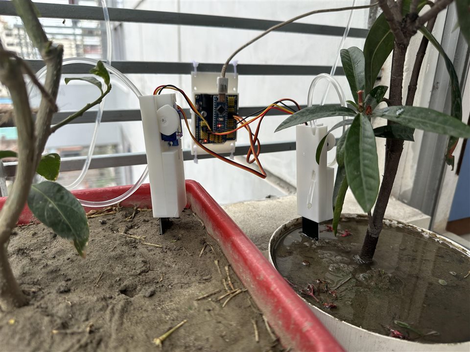

Installation of the Sensor Unit
After preparing all the sensor units I installed the system to my plant. I used two sensor units for my two plant. I placed the plant in my balcony. So, I fixed the arduino unit to my balcony grill with zip tie. Then, I inserted one sensor unit to each plant pot.
Finally, I connected the sensor cable and servo cable to the corresponding port of the nano io shield as mention in the previous step.
I inserted the sensors to my plant pots as illustrated below:

For providing the water to plant pot we need to store the water in a pot first. I placed the water pot is placed at a height so that water fall to the plant pot due to gravity. As, I used a plastic water bottle, I made two small holes for inserting two pipes. Every saline set has a spike with the pipe and I inserted that spike through the hole. To avoid any water leakage, I used some hot glue to tightly fixed the spike to the hole and fill any small gap.

    A nice project that a lot of people could benefit from. Gone are the days of going on your holidays only to return to a house of dead plants.
    Do you find that the latency between delivering the water and the sensor detecting a change is an issue at all ? I notice that the plant on the right looks like it has a lot of water on top.
    Delivering the water in shorter pulses with a longer delay between sensor reads might allow more time for the water to soak in and reach the sensor.
