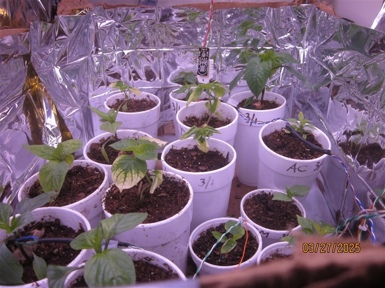

A bit of a brag: June 28 2025 photos of the pepper plants here. They got off to a great start this and the best crop of peppers Ive ever had are close at hand.

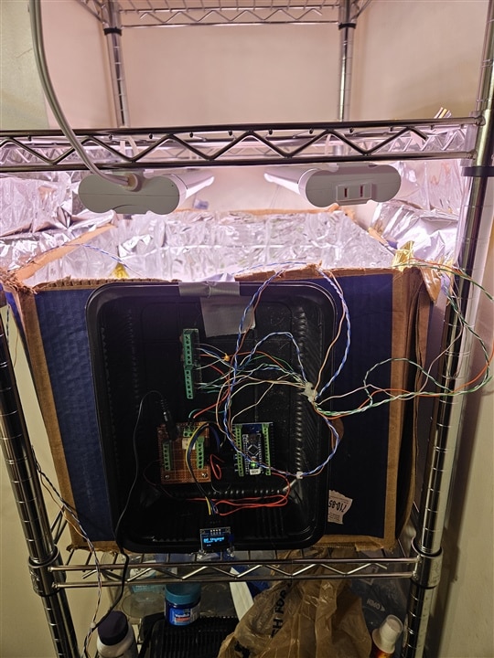

Keeping in line with the online advice to grow the Perfect Pepper from seed,  my Grow System has 2 boxes:
one for seeds to germinate , and a second seedling box for development and hardening.

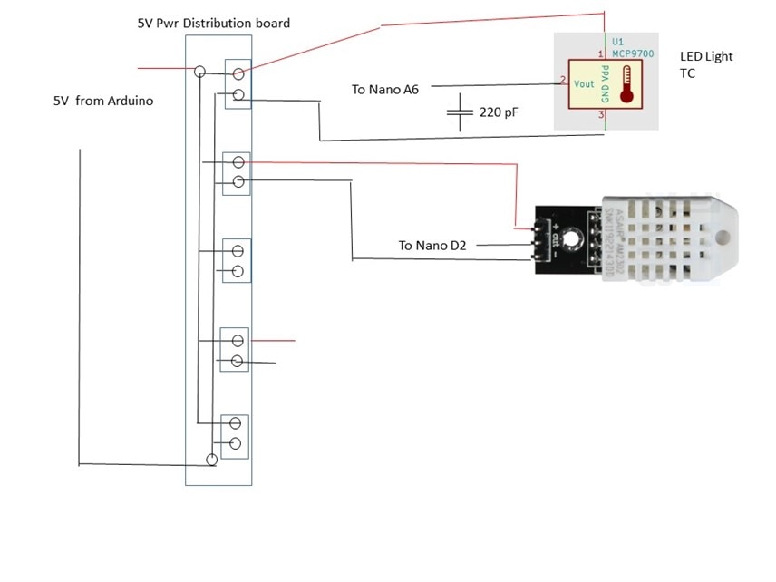

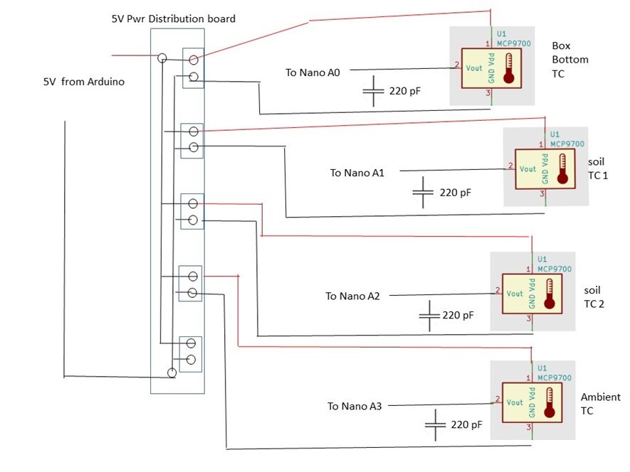

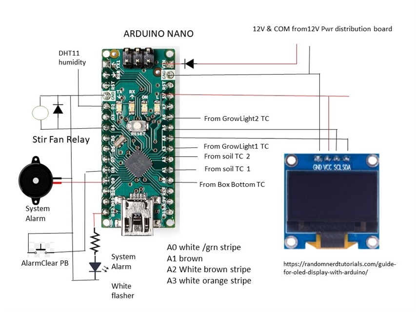

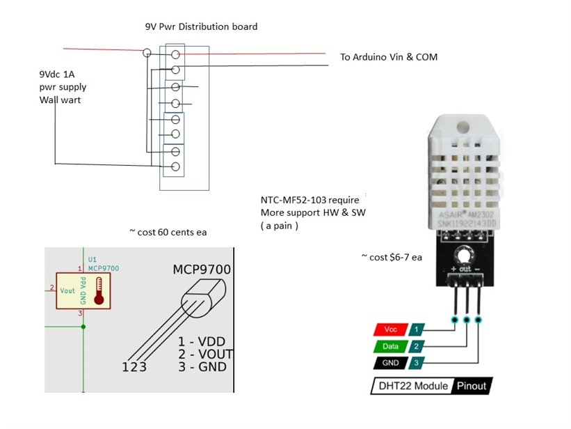

The Germination Box Monitoring System Schematics:
image  image

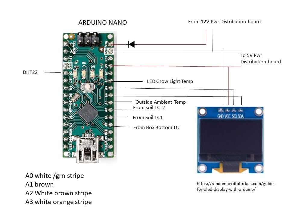

The is the Development Box Monioring System schematics:

Start with the Arduino Nano & MCP9700As -

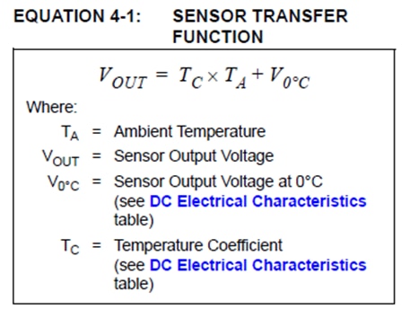

1st surprise – MCP9700A thermal sensor is the  -40C to 125C model.  So…….-40 is 0V and 125C=5V ?
NO !!!    0C is ~ 500mV and 125C =~ 1.7V
My desired measurement range is 5C to 45C or so……500mV to 1Vdc  on the Arduino Analog input.
It is important to read the components datasheet first !

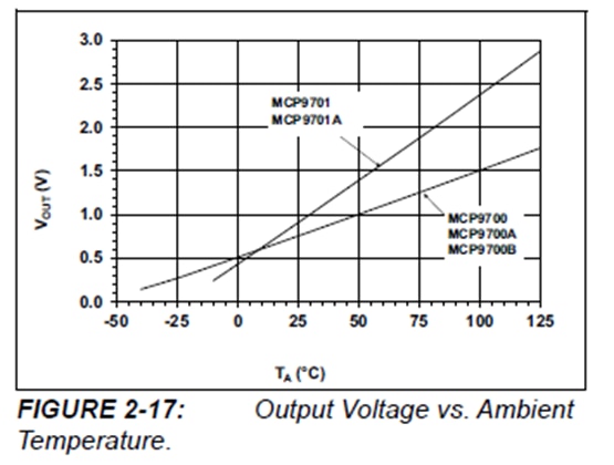

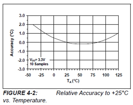

Accuracy:
Optimized for Analog-to-Digital Converters (ADCs):
- 10.0 mV/°C (typical) (MCP9700/9700A/
9700B)TA = -40°C to +125°C TACY -2.0 ±1 +2.0 °C MCP9700A
2nd shocking surprise -  with 5V = 1023 counts on the analog inputs , resolution is ~ 50 mV per count, 0C =~counts  50C ~ 200 counts a too touchy on the resolution , my spiderman senses tingle, this will not do. Lets make the resolution counts better.
3rd surprise – increase analog input count resolution - setup the Arduino Nano to use the analog internal reference for 1 PU  1023 counts = ~ 1.5V. After a lot of measurements, offset measurements, and scale factor fudging discovered the real 1 PU volts is  ~ 1.4V.  Its a much better match for the range of MCP9700As useage.
4th surprise – Tried using the Arduino Minima which can be configured for a 14 bit analog, 1 PU = 16383 counts. Much better accuracy, but doesn’t perform any better for this application. Using the analog reference , the count range for 500mV – 1V is much better, but doesn’t add any true value this project having +- 1 degree F  is more than plenty accuracy.
5th surprise – Added DHT22 humidity sensor to hardening box, expected it to mostly read ambient room humidity, which it did, unless the plants had just been watered. Adding DHT11 to the germination box, discovered the small stirring fan made a huge difference in humidity, it tended to dry out the internal air as this box was more sealed to hold in the lamp heat.
6th surprise – Some MCP9700A leads weren’t completely covered with heat shrink tube or hot glue. Those sensors started to give bad readings and one failed. The combination of moisture and fertilized soil helped those leads corrode pretty quickly. Removing the corrosion brought the readings back on some, but one sensor had a lead totally eaten thru and broke off.
7th Gotcha - Temperature readings skyrocket when a thermistor lead opens. Some of the wiring had extra slack, wire loops dangled from the Germination Box and the table where the box sat. The temptation was too much for my furry friends. They had to snack on the yummy light gauge wire of the thermistors.  I had to get more serious with the tyraps and not leave room on the table top lest they be tempted to play and chew on more thermistor wires.

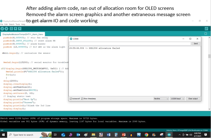

 10th surprise – OLED SSD1315 screen limit. Had to remove a couple redundant print to OLED screens to alleviate this fault. It also crashed the Arduino.

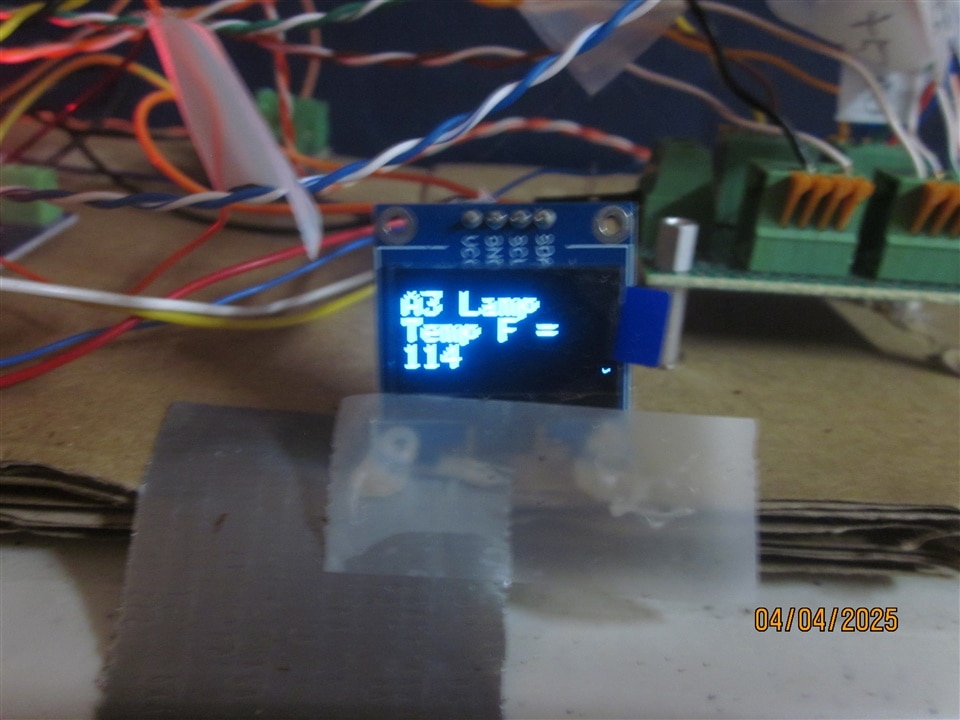

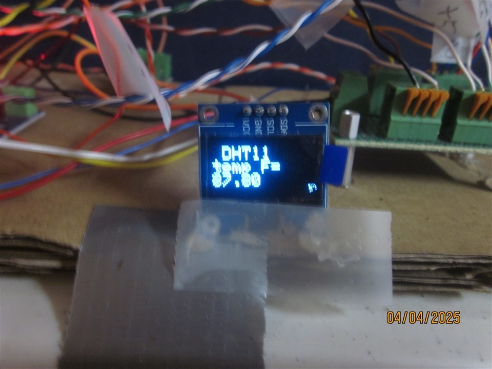

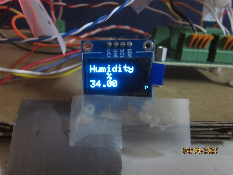

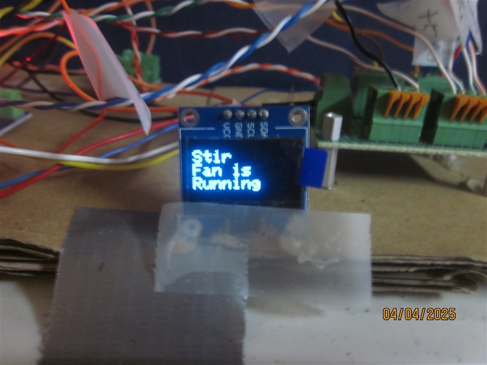

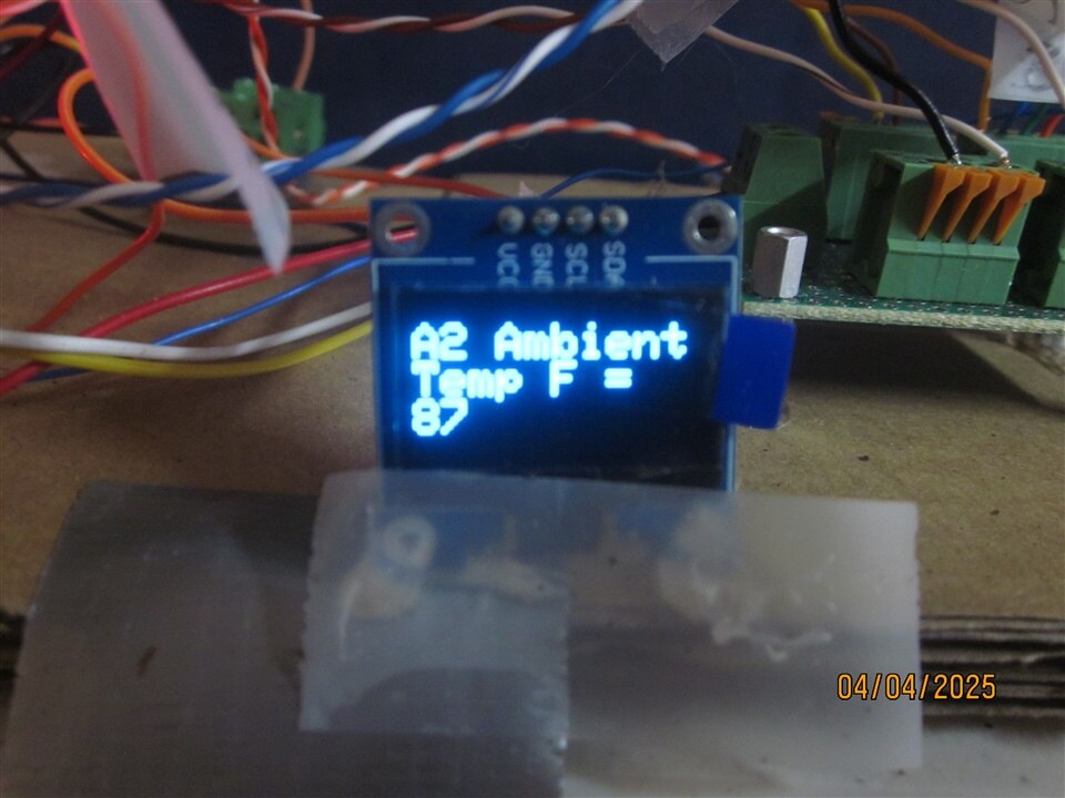

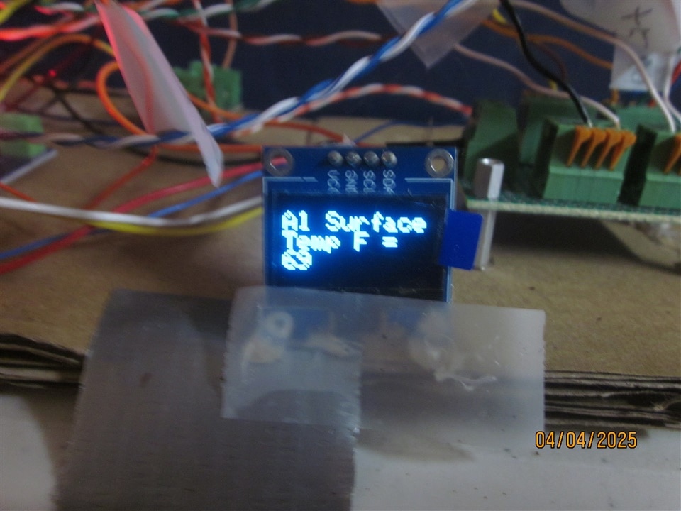

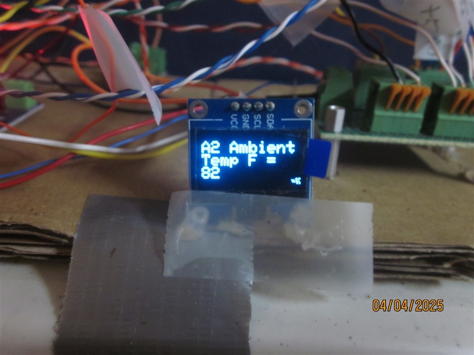

Photos of the Germination Box Monitor Screens:
Photos of the Development Box Monitor Screens:
imageimageimage    image

        display.println("A0 Bottom");
        display.println("Temp F =");
        display.println(A0_TF);
        display.display();
       delay(ScreenOnTime);// for reading display

  display.println("A1 Surface");
  display.println(A1_TF);
  display.display();
      delay(ScreenOnTime); //for reading display

  display.println("A2 Ambient");
  display.println(A2_TF);
  display.display();

        if (StirFanRelayOn==HIGH)
              display.clearDisplay();
              delay(ScreenClearDelay);
              display.setCursor(0, 10);
            // Display static text
            display.println("Stir");
            display.println("Fan is");
            display.println("Running");
            display.display();
            else
            display.println("Stir Fan");
            display.println("  is   ");
            display.println(" OFF  ");
            display.display();

The Seedling Development Box Arduino Code:
// this code is for the nano !! The Seedling Development/Hardening Box
// MCP9700AETO is an analog device whose output varies linear with temp -40C to 125C
// -40C = ~ .2V    0 C ~ .5V   20C ~ .8V   50C ~ 1.4V
// analogRead input natively has 5V = 1023 counts, 53.8 mV per count
// using analogReference = internal, can change the 1PU on the analog to ~1.1V  we shall
// MCP temperature transfer function Vout = Tcoefficient*Temperature + Vout@0C
// Vout@0C == 500mV   Tcoefficient = 10mV per degree C
// transfer function  (Vout-500mV)/10mV = Temperature C
// https://randomnerdtutorials.com/guide-for-oled-display-with-arduino/
// A4 & A5 are reserved for the SSD1306 screen  A4(SDA), A5(SCL)
// https://www.electroschematics.com/arduino-dht22-am2302-tutorial-library/
#include "DHT.h"
#define DHTPIN 2     // what pin we're connected to
#define DHTTYPE DHT22   // DHT 22  (AM2302)
DHT dht(DHTPIN, DHTTYPE);
int A0counts=0;
int A1counts=0;
int A2counts=0;
int A3counts=0;
int A6counts=0;
float A0millivolts =0;
float A1millivolts =0;
float A2millivolts =0;
float A3millivolts =0;
float A6millivolts =0;
int A0_TC;
int A0_TF;
int A1_TC;
int A1_TF;
int A2_TF;
int A2_TC;
int A3_TF;
int A3_TC;
int A6_TC;
int A6_TF;
int DHTtempF;
int ScreenOnTime=3000;
int ScreenClearDelay=250;
//int StirFanRelayOn = LOW; // preset Fan relay state
//int StirFanRelayOff = HIGH;//preset Fan Relay State
//int StirFanOnTempThr = 90; // when stir fan turns on from A3
//int StirFanOffTempThr = 75; // when stir fan turns off from A2
int A0_0C_offset = -10;// mV offset measured at 0C
int A1_0C_offset = -1;// mV offset measured at 0C
int A2_0C_offset = -3;// mV offset measured at 0C
int A3_0C_offset = -1;// mV offset measured at 0C
int A6_0C_offset = 0;// mV offset measured at 0C
#include <SPI.h>
#include <Wire.h>
#include <Adafruit_GFX.h>
#include <Adafruit_SSD1306.h>
#define SCREEN_WIDTH 128 // OLED display width, in pixels
#define SCREEN_HEIGHT 64 // OLED display height, in pixels
// Declaration for an SSD1306 display connected to I2C (SDA, SCL pins)
#define OLED_RESET     -1 // Reset pin # (or -1 if sharing Arduino reset pin)
Adafruit_SSD1306 display(SCREEN_WIDTH, SCREEN_HEIGHT, &Wire, OLED_RESET);
void setup()
 analogReference(INTERNAL);
  pinMode(A0, INPUT); //thermocouple 1
  pinMode(A1, INPUT); //thermocouple 2
  pinMode(A2, INPUT); //thermocouple 3
  pinMode(A3, INPUT); //thermocouple 4
  pinMode(A6, INPUT); //thermocouple 6
 dht.begin();
  Serial.begin(115200); // serial monitor for troubleshooting
if(!display.begin(SSD1306_SWITCHCAPVCC, 0x3C)) { // Address 0x3D for 128x64
    Serial.println(F("SSD1306 allocation failed"));
    for(;;);
  delay(2000);
  display.setTextSize(2);
  display.setTextColor(WHITE);
  display.println("Hardening");
  display.println("  Box ");
    display.println("Monitor");
  display.display();
void loop() {
/// read input thermistors
delay (500); // thermisters have a 500ms time constant
      ///// yea, I should make it a loop, easier this way to rework IO if needed
      ///  read
      A0counts= (analogRead(A0)+ A0_0C_offset);  // read the input pin
      //delay(500);
         // Serial.println("A0 cnts value =");
         // Serial.println(A0counts);
          // calculate inputs volts
      A0millivolts=((A0counts*1060.0)/1023.0);//
           // Serial.println("A0 millivolts =");
           // Serial.println(A0millivolts);
            //delay(1000); //for reading
      A0_TC=((A0millivolts-500)/(10));
            //Serial.println("A0 temperature C =");
             //Serial.println(A0_TC);
      A0_TF=(((A0_TC*9)/(5))+32 );
       //      Serial.println("A0 temperature F =");
       //    Serial.println(A0_TF);
      // delay(100); //for reading monitor
  display.display();
      A1counts= (analogRead(A1)+A1_0C_offset);  // read the input pin
      delay(500);
      //Serial.println("A1 value =");
      //Serial.println(A1counts);
      A1millivolts=((A1counts*1060.0)/1023.0);// yes, introducing a 3.3% error by using 5000 mV/1000 cnts rather than 1023 cnts, so so much cleaner
      A1_TC=((A1millivolts-500)/(10));
      A1_TF=(((A1_TC*9)/(5))+32 );
 //     Serial.println("A1 temperature F =");
  //    Serial.println(A1_TF);
  display.println("A1 Soil");
  display.display();
      A2counts= (analogRead(A2)+ A2_0C_offset);  // read the input pin
      //Serial.println("A2 value =");
      //Serial.println(A2counts);
      A2millivolts=((A2counts*1050.0)/1023.0);// yes, introducing a 3.3% error by using 5000 mV/1000 cnts rather than 1023 cnts, so so much cleaner
      A2_TC=((A2millivolts-500)/(10));
      A2_TF=(((A2_TC*9)/(5))+32 );
      //Serial.println("A2 temperature F =");
      //Serial.println(A2_TF);
    delay(500);
  display.println("A2 Soil");
  display.display();
 // if ((A2_TF < StirFanOffTempThr )&(StirFanRelayOn==HIGH))
 //     { digitalWrite(4,LOW);
 //     StirFanRelayOn=LOW;
 //         display.clearDisplay();
//    delay(ScreenClearDelay);
//    display.setCursor(0, 10);
//  display.println("STIR FAN");
//  display.println("OFF");
 // display.println(A3_TF);
 // display.display();
//  delay(ScreenOnTime); //for reading display
      A3counts= (analogRead(A3)+ A3_0C_offset);  // read the input pin
      delay(500);
      //Serial.println("A3 value =");
      //Serial.println(A3counts);
      A3millivolts=((A3counts*1050.0)/1023.0);// yes, introducing a 3.3% error by using 5000 mV/1000 cnts rather than 1023 cnts, so so much cleaner
      A3_TC=((A3millivolts-500)/(10));
      A3_TF=(((A3_TC*9)/(5))+32 );
      //Serial.println("A3 temperature F =");
      //serial.println(A3_TF);

      A6counts= (analogRead(A6)+A6_0C_offset);  // read the input pin
      delay(500);
      //Serial.print("A6 cnts =");
      //Serial.println(A6counts);
      A6millivolts=((A6counts*1050.0)/1023.0);//
      A6_TC=((A6millivolts-500)/(10));
      A6_TF=(((A6_TC*9)/(5))+32 );
      //Serial.println("A6 temperature F =");
      //Serial.println(A6_TF);
      delay(100); //for
  display.println("A6 Lamp");
  display.println(A6_TF);
  display.display();
///////////////////////////// DHT22 humidity sensor ////////
// Reading temperature or humidity takes about 250 milliseconds!
  // Sensor readings may also be up to 2 seconds 'old' (its a very slow sensor)
  float DHThumidity = dht.readHumidity();
  // Read temperature as Celsius
  float DHTtemperatureC = dht.readTemperature();//temp is in C
             Serial.print("Humidity: ");
            Serial.print(DHThumidity);
            Serial.print(" %\t");
            Serial.print("Temperature: ");
            Serial.print(DHTtemperatureC);
            Serial.println(" *C ");
  DHTtempF=(((DHTtemperatureC*9)/(5))+32 );
  // Check if any reads failed and exit early (to try again).
  if (isnan(DHThumidity) || isnan(DHTtemperatureC)) {
    Serial.println("Failed to read from DHT sensor!");
    return;
  display.println("Humidity");
  display.println("   % ");
  display.println(DHThumidity);
  display.display();
  display.println("DHT22");
  display.println("Temp F= ");
  display.println(DHTtempF);
  display.display();
