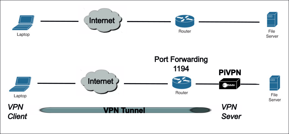

For this project the goal was to have people connect over the Internet to a web service on a server within the company. Data moving over the Internet is publicly available. If the laptop was in a public space using WiFi to connect, the data is more exposed.
A virtual private network (VPN) is a secure connection using encryption between two ends points. Think of it as a private tunnel through the Internet between the laptop and the file server. Data travelling in the tunnel is encrypted. If it is examined by the public it is unreadable.
In the example one endpoint is the laptop is running VPN Client software. The other endpoint a Raspberry Pi computer running VPN Server software. The Client VPN establishes a connection to the PiVPN server. The client encrypts data before being sent into the Internet. The VPN Server receives the encrypted traffic, decrypts it and forwards it the destination. The end to end encryption creates a secure private tunnel between the endpoints.
PiVPN is a software configuration on a Raspberry Pi using open-source protocols to create a VPN Server. Two VPN are supported OpenVPN and WireGuard . This project is using OpenVPN. Running a shell script after installing an operating systems (O/S) carries you through the software installs and configuration steps to secure the VPN.

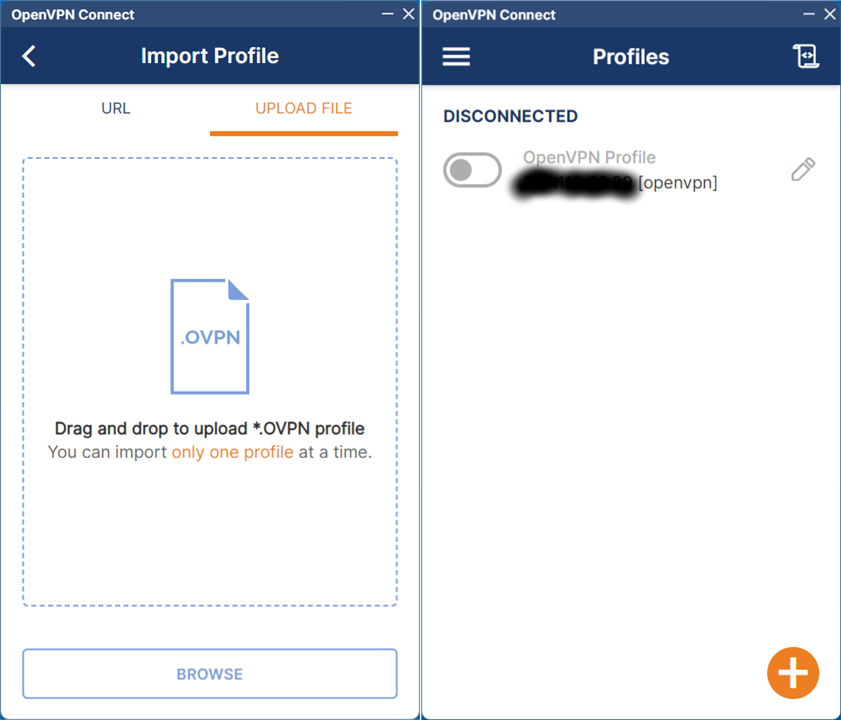

I copied the file to a laptop running Windows 11 Pro. The file was then uploaded in OpenVPN Connect client software.
Here is the logfile entry post a successful connection with the client. The ISP public IP for the router has been replaced with www.xxx.yyy.zzz

Router Configuration
For the configuration to work the routers port forwarding needed to be configured. The VPN Client connects to the router on port 1194 defined in the VPN configuration. The router through port forwarding is told what to do with the connection request, ie forward to PiVPN server.
Using the port number, protocol supported and IP of the VPN Server the router can be configured to forward the connection request.
