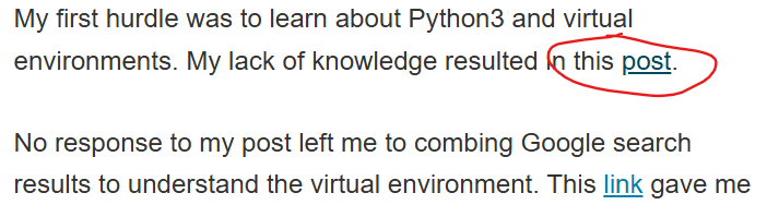

The Billboard code was developed in Python version 2. The default Python language on the Raspberry Pi O/S is Python version 3. My skills with Python are more of a resurrectionist than a programmer. The instruction to duplicate the Billboard environment using Python3 didn’t work.
My first hurdle was to learn about Python3 and virtual environments. My lack of knowledge resulted in this post.
No response to my post left me to combing Google search results to understand the virtual environment. This link gave me the much needed insight to start assembling the software components to build a script.

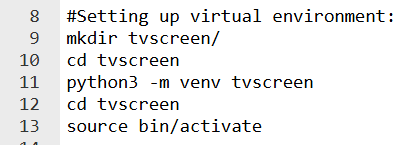

#Setting up virtual environment:
mkdir tvscreen/
cd tvscreen
python3 -m venv tvscreen
cd tvscreen
source bin/activate

    colporteur over 1 year ago in reply to beacon_dave +1
    I posted at E14 my python environment issues figuring someone would have played in the space. The last time I looked there was nothing. Without a response I then set about discovering what I needed to…
  • colporteur
    Without a response I then set about discovering what I needed to learn and finding the resources to do that. I was successful (I figure) because I got my project to work in a python virtual environment. The commands I used for the virtual environment are what I listed. It does little to describe the learning. In addition there are the changes needed in a python script shebang line to have it run in the environment.
    I have since used the python venv knowledge in another project. It was great to build on prior learning. Since retiring I don't keep up with changes. Python3 looks to have created some structure in the language. I'm believe my lack of exposure is a short coming. 3.1 was the last time I played in Python. At that time 3 was so frustrating I stayed in 2.7. Now 3 seemed to be smoother. I would improve if I played more with it, for sure.
    I confess the project required considerable effort to complete. On three separate occasions I was ready to throw in the towel. I just didn't know what I didn't know. My best before date since retiring had finally caught up with me. I kept at it and got it working. There is a satisfaction in that.

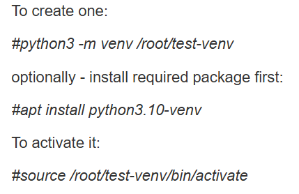

    Great that you are making progress.
    I'm a bit confused by your comment though:
    That post you link to at:
    /technologies/experts/f/forum/53848/i-don-t-understand-python-venv/215638
    appears to tell you to do what you actually ended up doing.
    JWx posted in their comment:
    /technologies/experts/f/forum/53848/i-don-t-understand-python-venv/215633
    ( which is the same as the documentation at:
    https://packaging.python.org/en/latest/guides/installing-using-pip-and-virtual-environments/#create-and-use-virtual-environments )
    which appears to be the same steps as you took:
    Were there any other steps you had to take to resolve the issue that you were having, that haven't been listed in your post ?
