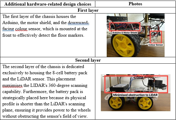

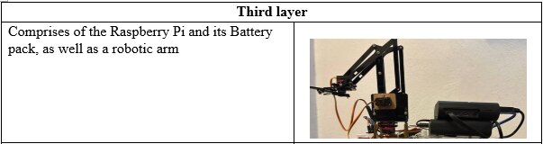

Hardware Design:

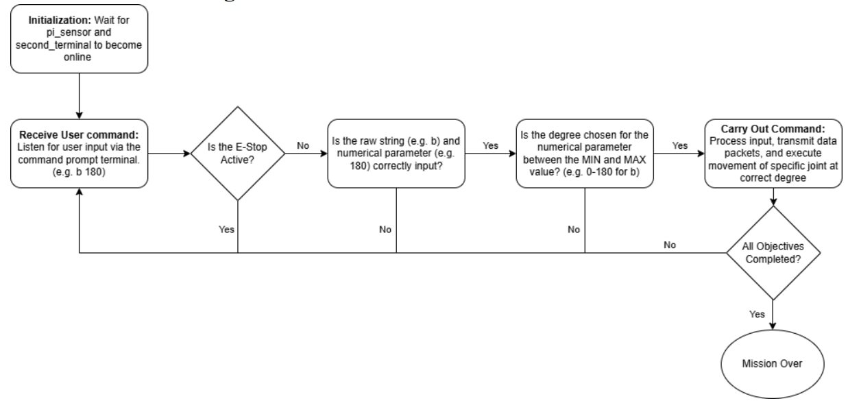

Software Design
High-Level Software Algorithm Flowchart for Arm Control
High-Level Software Algorithm Flowchart for Color Sensor

2. Receive User Command (The full list of inputs are provided below)
  • E-Stop Safety Architecture (“e”): The system continuously monitors for software safety triggers. When “e” command is sent, a two-step halt sequence occurs:
    • Pi (High-Level): Instantly updates its global state to block any new movement commands from being queued, while simultaneously transmitting a priority halt packet to the Arduino.
    • Arduino (Low-Level): Upon receipt, the Arduino immediately sets its internal E-Stop state to active, stopping all motor and servo PWM signals. It ignores all subsequent movement packets and sends an acknowledgment packet back to the Pi.
  • Chassis Locomotion (“w”, “a”, “s”, “d”): Directional keys are passed with a duration parameter.
    • Use case: [value]. For example, “w 5000” makes the robot move forward for 5000 milliseconds
  • Velocity Control (“v”): Adjusts the global chassis speed using an 8-bit parameter
    • Use case: [value]. e.g. “v 255” makes the robot move at max speed
    • The effective duty cycle percentage is calculated via 255 × 100% and implemented using the AFMotor library on the Arduino. Firmware-level limiters automatically cap values exceeding 255.
  • Arm Manipulation (“sh”, “b”, “el”, “gr”): Controls the shoulder, base, elbow, and gripper respectively. (This process will be elaborated in the next section)
    • Use case: [value]. e.g. “b 180” makes the base turn toward the 180° direction.
    • Software limiters restrict the inputs to valid physical ranges, preventing hardware strain and self-collision.
  • Colour Detection (“c”): Triggers the TCS3200 sensor to process an RGB frequency reading of the floor marker. (This process will be elaborated in the next section)

  1. Physical Integration & LiDAR Field of View (FoV):
    One of my primary hardware oversights was the initial mounting position of my 360° LiDAR unit. I placed the sensor where chassis wiring and structural supports partially obstructed its laser sweep. Because a core mission objective was submitting an accurate, hand-drawn map of the unknown base layout, this oversight was critically damaging. The obstructions created blind spots in my SLAM mapping, causing the robot to misinterpret its distance from walls or fail to detect them entirely, risking heavy penalties for environmental collisions. Moving forward, I implemented a strict "clearance-first" design rule for the third layer of the chassis, ensuring the sensor’s optical path remained entirely unobstructed by objects.
