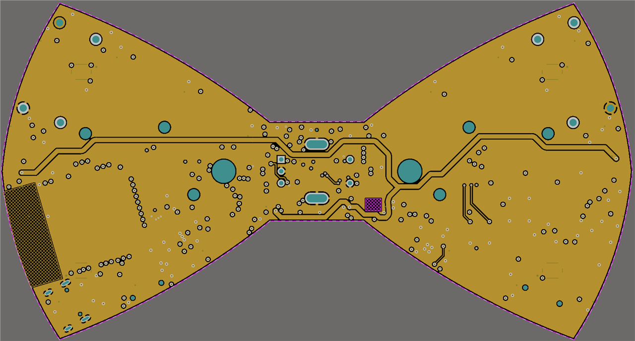

3.1 Why 4 Layers?
One look and the answer is pretty obvious Sweat smile
The simplest reason is that the bowtie form factor is unforgiving. Every IC, connector, button, and Neopixel had to fit within the outline of a standard bowtie. With almost 200 components on the board, a 2-layer board simply couldn't route cleanly.
The 4-layer stack up also allowed me to provide a dedicated power and ground plane in the inner layers which helped greatly with routing as well as keeping high speed digital signals well maintained. Even with 4 layers though, routing was challenging to ensure no cross overs, solid ground planes under SPI and I2C signals, and maintaining a critical keep out underneath the ESP32-S3 antenna.

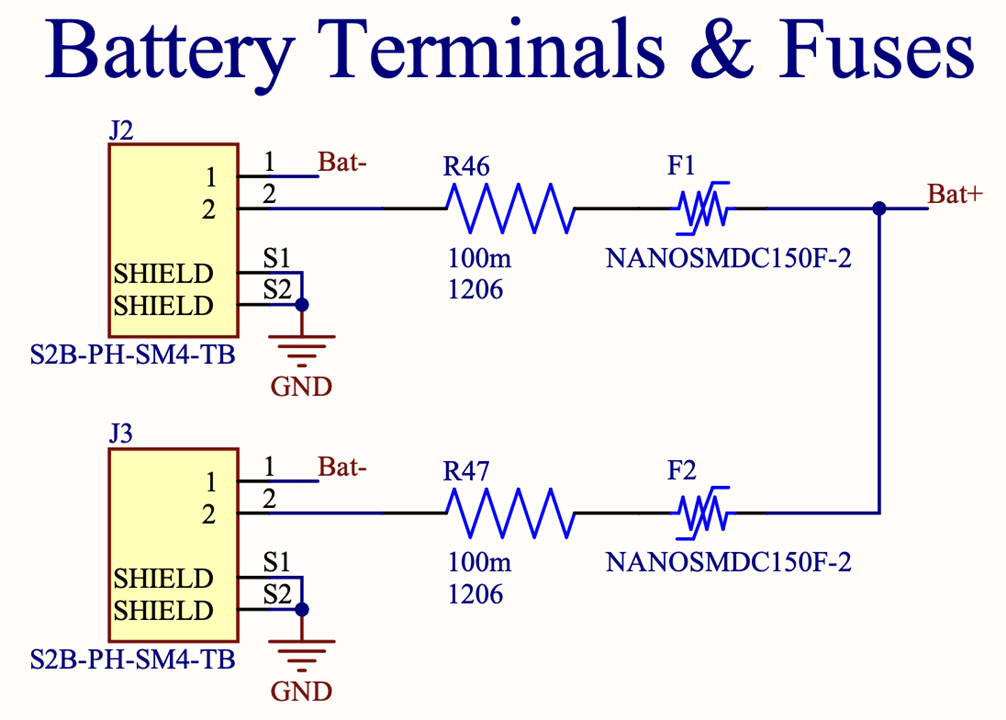

Power Management
LiPo batteries were the natural choice for a wearable. They're lightweight, rechargeable, and energy-dense enough to power the ESP32-S3, audio circuits, and 20 NeoPixels comfortably. Two 1000mAh cells wired in parallel double the capacity while keeping the voltage at 3.7V nominal, which feeds cleanly into the onboard LDO.
But LiPo batteries demand respect. Overcharge them and they swell. Over-discharge them and you permanently damage the cell. To handle both, the DW01A battery protection IC monitors the battery continuously, controlling a dual N-channel FS8205 MOSFET sitting in the battery's negative path. If the DW01A detects an over-charge or over-discharge condition, it opens the appropriate FET and cuts current in that direction, protecting both the battery and anything connected to it.
Each battery also has its own dedicated Resettable Polyfuse (F1, F2) right at the connector. The polyfuses act as a first line of defense, if current draw spikes beyond a safe threshold, they trip and self-reset once the fault clears, no replacement needed.
Charging is handled by the TP4056, with a 1.2kΩ PROG resistor setting the charge current, and green/red status LEDs indicating standby and active charging states.
The more interesting design challenge was power selection. The rule for LiPo safety is simple: never let the battery charge and power the load through the same path simultaneously. So my circuit enforces this elegantly using a Schottky diode (D7) and a P-Channel MOSFET (Q2).
When USB is plugged in, VCC is present. The Schottky diode conducts, pulling Q2's gate up toward VCC which is higher than Bat+, bringing VGS close to zero and turning Q2 off. The battery is completely disconnected from the load path. USB powers the device directly, and the TP4056 charges the battery independently on its own path.
When USB is removed, Q2's gate is pulled to ground through R9, making VGS sufficiently negative to turn Q2 on, and the battery takes over powering the device.
The result: plug in USB and the bowtie is simultaneously powered, programmable via USB Serial/JTAG, and charging its batteries. All three happen at once, with no risk of the battery and USB fighting each other on the load path.

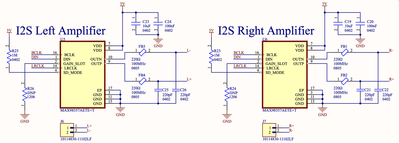

Audio Output
V1 Audio Output Design
The first version's audio schematic originally had a separate DAC and Audio amplifier which from the datasheets looked promising, but it effectively failed due to two reasons. First the compact design of the PCB made it difficult to isolate analog and digital grounds with so many other signals running between layers and all over the board, so noise filtering was basically inexistent. Secondly, the DAC I selected was an obsolete component and I simply had not known because I was testing it out on breadboard where it had it's own breakout board, but the IC by itself was nowhere to be found. (I proceeded to order the PCBs knowing the part was obsolete hoping I could desolder the IC from the breakout board and resolder it to my board, but that also failed so it was a hopeless case) The redesign fixed it by having the DAC and Amplifier all in one IC (eliminating the need to struggle with separate grounds) and of course it's a much more popular chip that was in stock.
V2 Audio Output Design
Now on V2, playback runs through two MAX98357A filterless Class D I2S amplifiers (one per speaker) with built in DAC that take digital audio directly from the ESP32-S3. They each output up to 3.2W and need very few external components which was perfect for a limited board space like this bowtie.

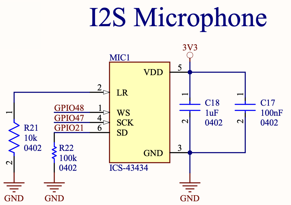

Audio Input
The ICS43434 is a high-performance I2S MEMS microphone chosen specifically for its omnidirectional pickup pattern. On a bowtie, the user isn't holding the mic up to their mouth, so the microphone needed to pick up voice reliably from chest height in a noisy room. Keeping the signal in the I2S digital domain all the way to the ESP32 also avoids the noise floor problems that come with analog mic routing across a dense board.
3.4 PCB Layout
Top Layer: Primary Signal and Power routing; A dense layer with MCU, I2S, SPI, and power management traces
Inner Layer 1: Dedicated ground plane, left unbroken under high speed traces when possible as well as connecting battery grounds together
Inner Layer 2: Dedicated power plane for clean 3.3V distribution as well as 5V rail distribution for Neopixels and Audio Amplifiers
Bottom Layer: Secondary signal routing and ground fills; Sparser than top layer but handles overflow and assists in getting signals from point to point
The stackup wasn't arbitrary. Having dedicated ground and power planes on the two inner layers means every signal trace on the outer layers has a reference plane immediately adjacent on both sides. This keeps trace impedance controlled, reduces crosstalk between sensitive signals, and gives the audio circuits a clean ground reference throughout.

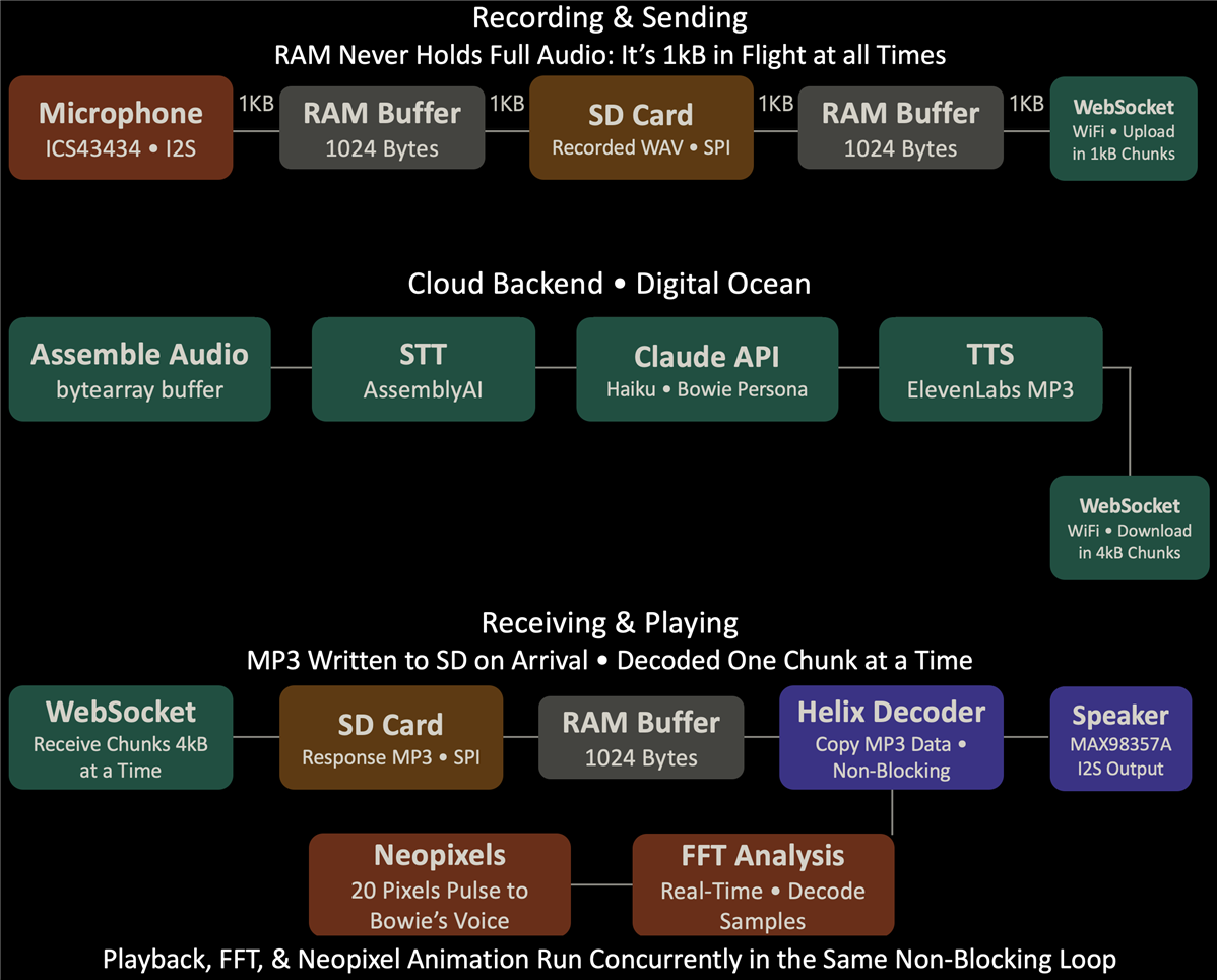

Section 4: The Audio Pipeline
Getting audio to flow reliably end-to-end on a memory-constrained device was the most challenging part of this project. The ESP32-S3 has limited RAM, which means you can't just record audio into a buffer, hold it in memory, and send it as the recording alone would overflow. Everything had to be designed around streaming to and from the SD card, with the RAM acting only as a small in-flight buffer at any given time.
4.1 Recording — Chunk by Chunk
When the button is held, the firmware reads raw I2S samples from the ICS43434 microphone in 1024-byte chunks and writes them directly to the SD card. Nothing accumulates in RAM. The WAV header is written with a placeholder size first, then patched at the end once the final byte count is known:

4.2 Sending — Streaming Off the SD Card
Rather than reading the entire WAV into memory before sending, the firmware reads it back off the SD card in 1024-byte chunks and sends each one immediately over the WebSocket. Memory usage stays flat regardless of recording length:

4.3 Backend — Assembling and Processing the Audio
On the server side, the audio arrives as a stream of binary WebSocket chunks. The backend accumulates them into a bytearray until the AUDIO_COMPLETE signal arrives, then runs the full AI pipeline:

4.4 Receiving and Playing — Non-Blocking Decode
Audio is sent back as an MP3 rather than WAV to reduce the time it takes to send. When the MP3 arrives back on the device, chunks are written to the SD card as they come in via the WebSocket callback. Once MP3_COMPLETE is received, playback begins, but critically, it's non-blocking. The Helix MP3 decoder processes one small chunk per loop iteration via copier.copy(), which means the main loop stays responsive and the full MP3 is never loaded into RAM at once:

The FFT runs on the decoded audio samples in real time during playback, driving the 20 Neopixels to animate the bowtie visually by pulsing to Bowie's voice.
