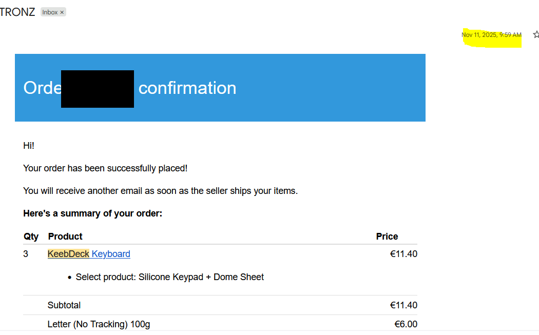

In Nov 2025, I saw a post on hackster - https://www.hackster.io/news/solder-party-launches-the-keebdeck-a-compact-silicone-keyboard-for-space-constrained-projects-06d01d8d106f that a querty silicone keyboard had been released. I have been a big fan of QWERTY Keyboards, I do most of my typing on Keychron K10 Keyboard. But for my electronics project, I have been limited to using the CardKB from M5Stack https://shop.m5stack.com/products/cardkb-mini-keyboard?srsltid=AfmBOop73BkcZFg_WyZXwfYKMJ5xfTu4PyH3gwLlfR26xpvQzGUErWHu . it did not have any silicone cover or any keymap printed on user facing surface. So this looked so amazing that i impulsively purchased it without thinking or planning for making a project out of it.

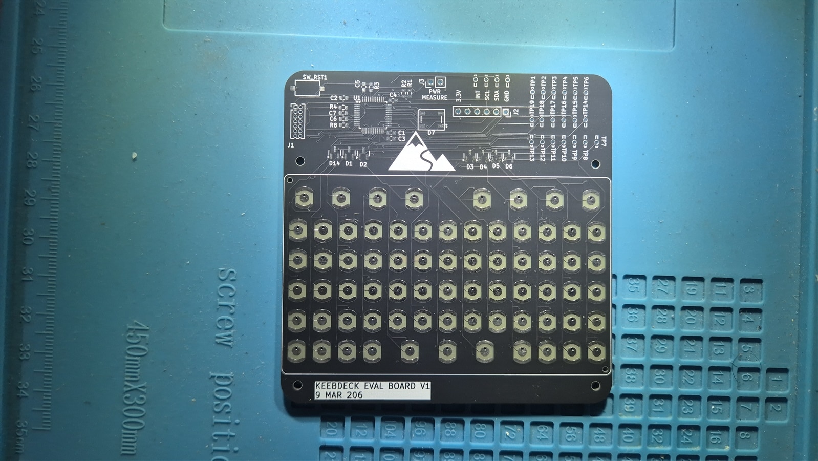

It came in around a month, and i forgot about it, until this spring clean competition came. So I quickly started making the PCB for it. My requirements were
  1. Use Row-Column Scanning to identify the key pressed
  2. Work as a I2C Slave to share the key pressed, along with an interrupt pin
  3. Sleep and be woken up by the key press without missing the key pressed
  4. Also debounce and ensure keypress are not duplicated unnecessary
And for the the MCU i went for STM32U Series. It is extremely low power, I have been exposed to STM32 L and F series, but U series takes power saving even a step further. Even though there are subtle changes in the HAL functions, I still will go with the STM32 HAL Programming
Here is where i did something extremely un-necessary. I modified the footprint of the Keyboard from the one provided in their github repo. The aim was to add ghost preventing diodes. But, it turned out be a disaster as i forgot to wire them properly,
So I had to make another one. But no experiments this time, Stuck to the original footprint.
In this i also added ability for backlighting, although it was a stretch goal for me.

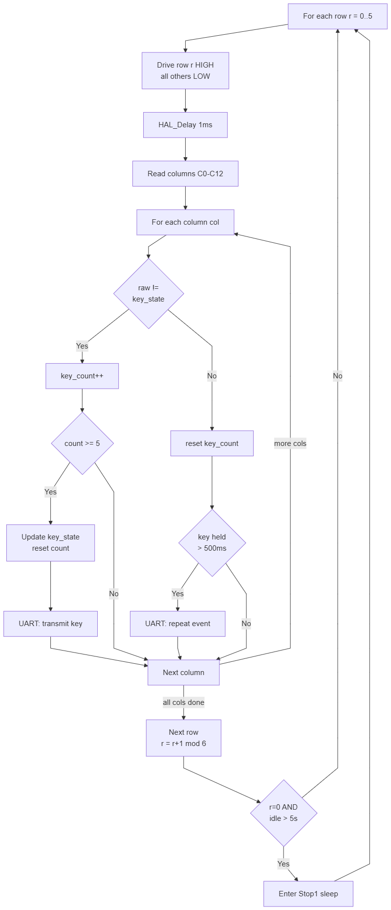

How the Matrix Scan Works
The scan loop is a simple row-at-a-time approach. Each pass through the superloop services one row, then advances to the next. A full 6-row cycle therefore takes 6 loop iterations.
/* Drive only row r HIGH, all others LOW */
for (int i = 0; i < 6; i++)
    HAL_GPIO_WritePin(row_ports[i], row_pins[i], (i == r) ? GPIO_PIN_SET : GPIO_PIN_RESET);
HAL_Delay(1); /* settle */
/* Read all 13 columns */
uint8_t c[13];
c[0]  = HAL_GPIO_ReadPin(C0_GPIO_Port,  C0_Pin)  ? 1 : 0;
/* ... c[1] through c[12] similarly ... */
For each key position, debounce runs as a counter: the raw signal has to agree for DEBOUNCE_COUNT (5) consecutive reads before the state is accepted. Once stable, a key-press fires a USART2 print of the key name. Key-held repeat fires after REPEAT_DELAY_MS (500 ms) and then every REPEAT_RATE_MS (50 ms).
if (c[col] != key_state[r][col])
    if (++key_count[r][col] >= DEBOUNCE_COUNT)
        key_state[r][col] = c[col];
        key_count[r][col] = 0;
        if (c[col])
            /* key pressed — log it */
            char buf[16];
            int len = snprintf(buf, sizeof(buf), "%s\r\n", keymap[r][col]);
            HAL_UART_Transmit(&huart2, (uint8_t *)buf, len, 50);
Stop1 Sleep and Wakeup
After 5 seconds of no key activity, the firmware puts the MCU into Stop1 mode. Before sleeping, all rows are driven HIGH — this is what arms the wakeup path through the BAT54C. A 10 ms settle delay flushes any transient that might have been captured during the row-HIGH transition, then both the EXTI pending bit and the NVIC pending bit are cleared so a glitch can't cause an immediate false wakeup:
HAL_Delay(10);
wakeup_edge = 0;
__HAL_GPIO_EXTI_CLEAR_IT(GPIO_PIN_0);
NVIC_ClearPendingIRQ(EXTI0_1_IRQn);
on Cortex-M0+, a pending SysTick interrupt will cause WFI to return immediately without entering Stop1 at all. HAL_SuspendTick() takes care of this:
HAL_SuspendTick();
HAL_PWREx_EnterSTOP1Mode(PWR_STOPENTRY_WFI);
/* --- wakes here on PA0 EXTI --- */
SystemClock_Config();   /* restore HSI 16 MHz — Stop1 kills the clock */
HAL_ResumeTick();
HSI is stopped in Stop1, so SystemClock_Config() must be called after wakeup to restore the 16 MHz clock before any HAL function that needs SysTick timing is used (including HAL_UART_Transmit). I learned this the hard way when the UART came back as garbage after the first wakeup.
After wakeup, the debounce counters are primed to DEBOUNCE_COUNT - 1 so the key that triggered the wakeup registers on the very first scan pass rather than sitting through 5 more cycles of debounce while still held:
memset(key_count, DEBOUNCE_COUNT - 1, sizeof(key_count));

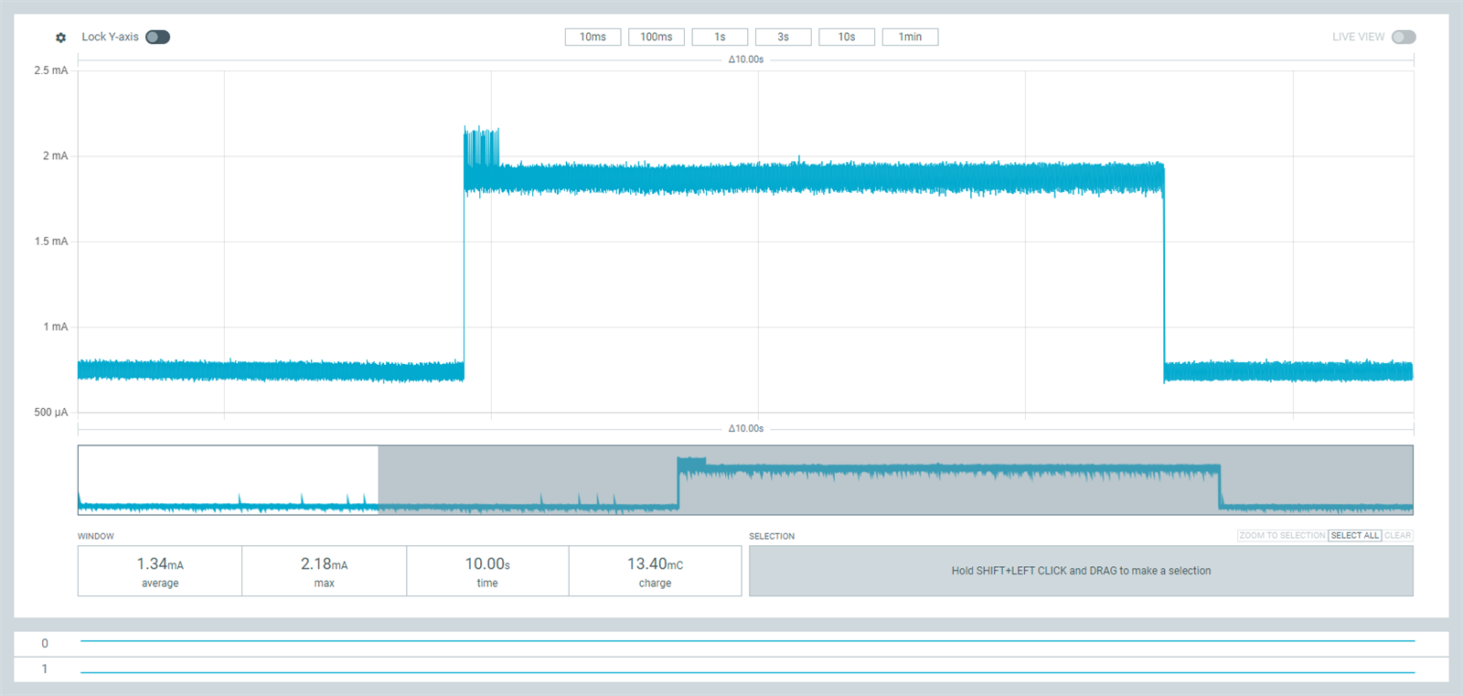

Power Analysis
Using Nordic PPK2, I checked the power consumption
While running, it took 1.34mA and while sleeping it took 0.74mA. I know for a fact, that with further optimization, i can bring it down even more. But that is for another time.
