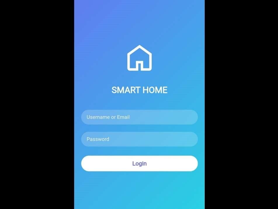

Access Control: Just because someone is on the local Wi-Fi doesn't mean they should have control over the house's appliances. I implemented a login page to secure the dashboard from unauthorized users on the same network.

LOGIN PAGE

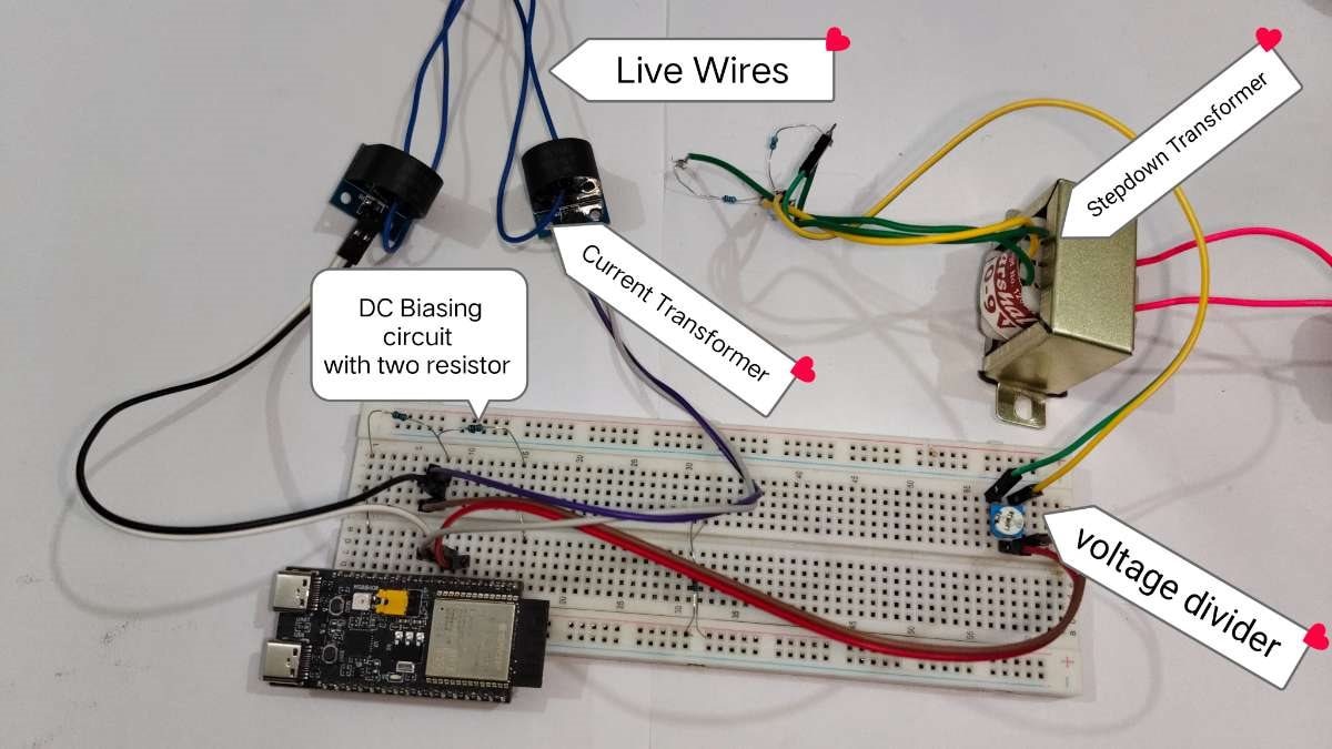

A current transformer and stepdown transformer is connected to ESP32 C6 with
The circuit is very simple, A step-down transformer output is connected to voltage divider (potentiometer) to reduce the voltage, which then feeds to DC biasing network—using two resistors to lift the AC wave to 1.65V—before entering the ESP32's analog pin.
Simultaneously, a Current Transformers (CT) clamps around the live wire to induce a signal representing the load current. This CT output is passed through a similar DC biasing circuit to shift the AC signal above 0V making it compatible for ESP32's analog analog measurement.

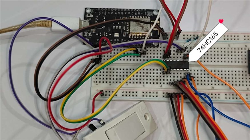

 Using 74hc165 shift register to read 8 physical switch with only using 3 gpio pin of esp8266
