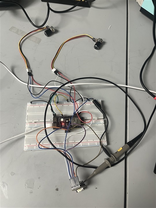

This project existed as a working breadboard prototype for longer than I'd like to admit. The ESP32-S3 devkit was wired to a PCM5102A stereo DAC breakout board via jumper wires, with potentiometers dangling off the side and a scope probe clipped to the output. My firmware worked and the signals looked right on the oscilloscope, but then it sat on my desk doing nothing for 6 months.
Breadboard prototype - ESP32-S3 devkit, PCM5102A breakout, potentiometers, and oscilloscope probe.

During devkit testing, the left channel output on the PCM5102A breakout was found to be non-functional, a hardware fault on the module, confirmed by swapping the channels in software. A bench signal generator was substituted as the left-channel reference, which was enough to validate the algorithm, I²S configuration, and oscilloscope output before committing to PCB layout.
Rigol DS1102E showing early firmware output - CH1 yellow (signal generator reference), CH2 blue (PCM5102A OUTR), both at 210Hz.

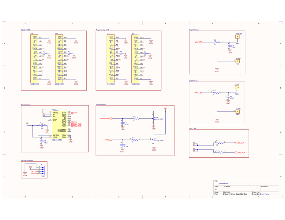

Step 2: Schematic Design in Altium Designer
With the firmware validated, the schematic was captured in Altium Designer across four sheets.
Sheet 1 — Input/Output
Dual USB-C connectors: one for programming via the CP2102-GMR USB-to-UART bridge, one for USB audio (speaker) mode. Phase and frequency potentiometer inputs with RC filtering. DAC output headers with 1kΩ series resistors and 15nF shunt capacitors forming a first-order low-pass filter (cutoff ~10.6kHz). USB D+/D− data lines with 22Ω series resistors for the USB audio path.

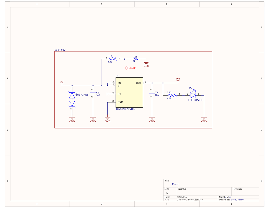

Sheet 2 — Power
5V to 3.3V regulation via the TLV75733PDYDR LDO. The LDO was chosen over a buck converter specifically for noise: a switching regulator at hundreds of kHz would inject noise directly onto the PCM5102A analog output rail. A TVS diode on the 5V input clamps inductive spikes from USB hot-plug events before they reach the LDO. The EN pin is controlled via a resistor divider tied to the PCM5102A XSMT soft-mute signal, so the LDO and DAC enable and mute together.

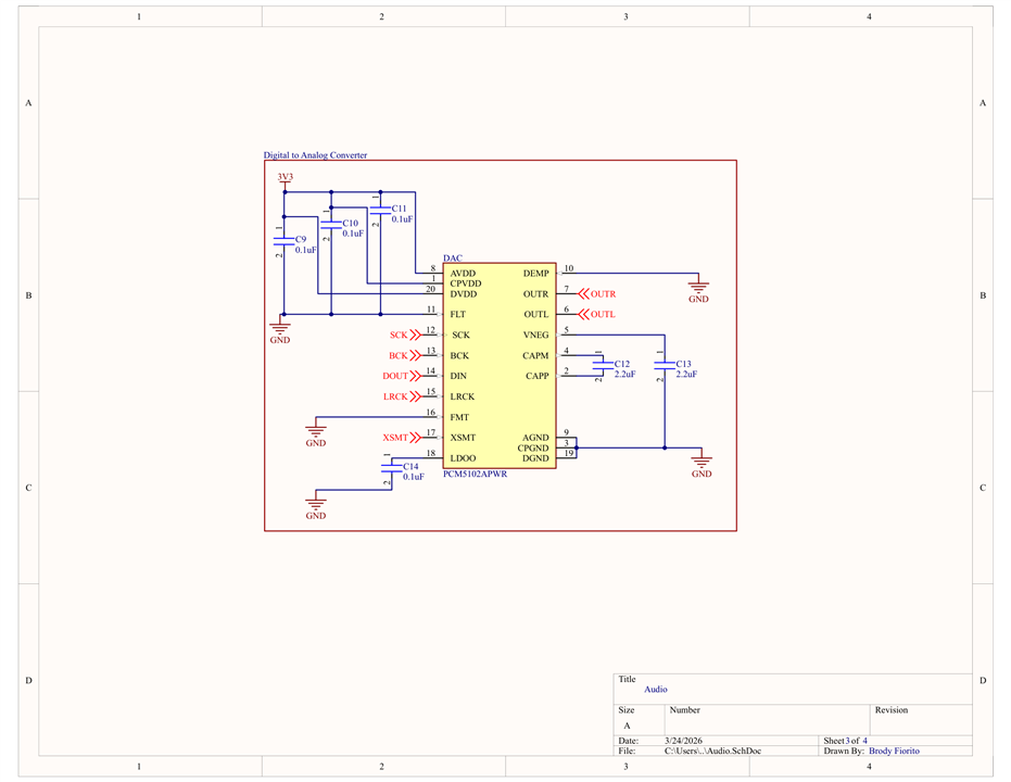

Sheet 3 — Audio
PCM5102A receiving I²S signals (SCK, BCK, DOUT, LRCK) from the ESP32-S3. AVDD, CPVDD, and DVDD all supplied from 3.3V with decoupling. Charge pump capacitors on CAPP and CAPM, the internal charge pump eliminates the need for a negative supply rail. Left and right analog outputs routed to the output header section.

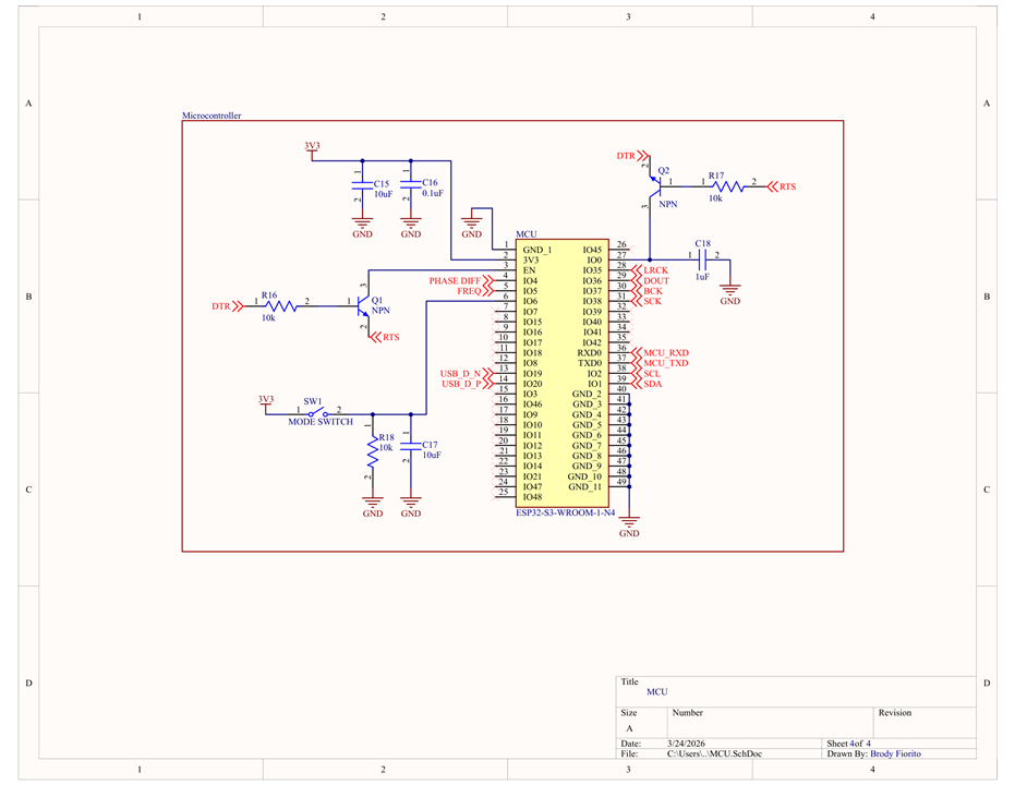

Sheet 4 — MCU
ESP32-S3-WROOM-1-N4 with I²S signals routed to the DAC, UART RX/TX to the CP2102 bridge via an auto-reset circuit. The auto-reset circuit uses NPN transistors driven by RTS and DTR to control the ESP32-S3 EN and IO0 pins, enabling automatic bootloader entry without pressing buttons. USB D+/D− broken out for USB audio mode. ADC inputs for the potentiometers. Mode switch with pull-down resistor and debounce capacitor. I²C lines for the OLED display.

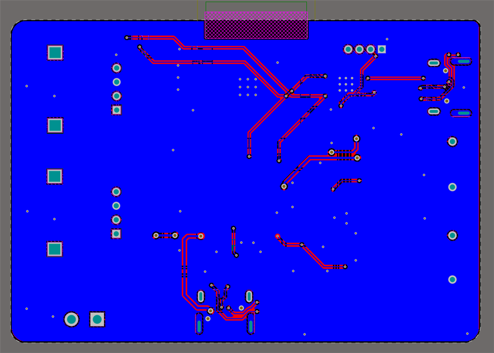

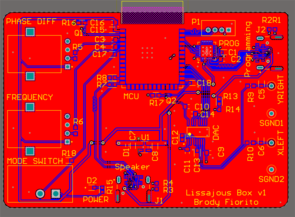

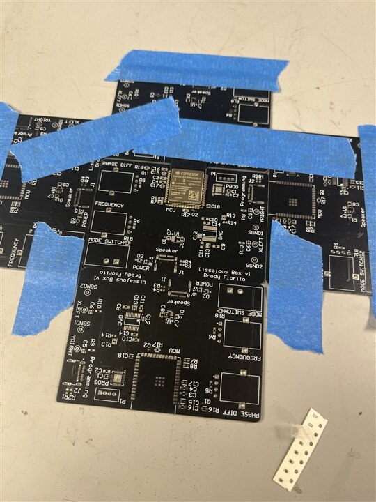

Step 3: PCB Layout
The board is 84mm × 57.7mm, 2-layer, 1.6mm FR4 with HASL finish.
Placement was driven by analog isolation: the PCM5102A and analog output network sit on the right edge of the board, as far as possible from the ESP32 and power circuitry. Decoupling capacitors sit directly at each IC's power pins. The CP2102 is adjacent to the programming USB-C connector to keep the USB differential pair short. The ESP32-S3 module antenna keepout area is free of copper pours and routing on both layers.
Routing keeps analog output traces away from digital and power traces for the full board length. Signal traces crossing power traces do so at 90° to minimize inter-layer capacitive coupling.
Ground is handled by continuous copper pours on both layers connected by stitching vias across the board, reducing ground impedance and keeping return current loops short.
Top Copper Layer
Bottom Copper Layer
The PCB was fabricated by JLCPCB. Components were ordered from Mouser.
Step 4: Assembly
Components were placed and soldered by hand. The passives and ICs were placed with solder paste and reflowed. Through-hole components (the potentiometers, slide switch, and output headers) were hand-soldered after reflow.
PCB after solder paste application.
Board after reflow, with ICs and passives soldered
One issue surfaced during assembly: the NPN auto-reset transistors (SOT-1123 package) were lost during reflow and couldn't be recovered by hand soldering due to the package size. The auto-reset circuit is non-functional on this revision. Manually pulling EN and BOOT High/Low is required to enter the bootloader. This is documented for a future revision; every other circuit on the board is functional.

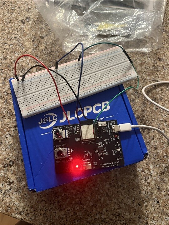

Step 5: Firmware Flash and Bring-Up
Before plugging it into my laptop, I made a few checks to make sure it wasn't going to blow up on me.
I started with a basic continuity check across all the IC pins to ensure there was no bridging between solder joints that could cause any shorts. A short across power rails could fry every chip on the board before I could realize what was going on. I mainly found them on the usb-c and programming chip. I fixed them using an iron, some flux, and wick.
After fixing all the shorts, I attempted powering the board with a 200mA current limit on a 12V power supply before jumping to my laptop. The power led came on, the current draw looked normal, and I confirmed the voltages of power rails.
With those confirmed, the firmware was flashed via manual bootloader over the programming usb-c and I looked at a few things to confirm output:
  • Mode Switch - Enumerates as a usb audio device in one position, and switches to signal output in the other.
  • Potentiometer Control - Frequency and phase difference pots step correctly through all 8 positions on each pot. EMA and hysteresis working properly
  • DAC - Both channels confirmed working by oscilloscope
