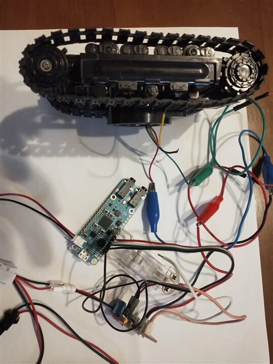

1.3 Current Phase: Voice-Controlled Navigation
The current phase uses a KWS (Keyword Spotting) model instead of visual AI. The rover moves based on voice commands detected by the on-board microphone. The project is named "Deaf Rover" because sometimes it misses commands like a deaf person, and occasionally moves randomly on its own.

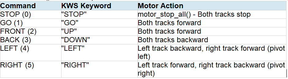

  • Keyword-to-Command mapping: UP->FRONT, DOWN->BACK, LEFT->LEFT, RIGHT->RIGHT, STOP->STOP, GO->GO
  • Low confidence or "Unknown" class keeps the previous command unchanged

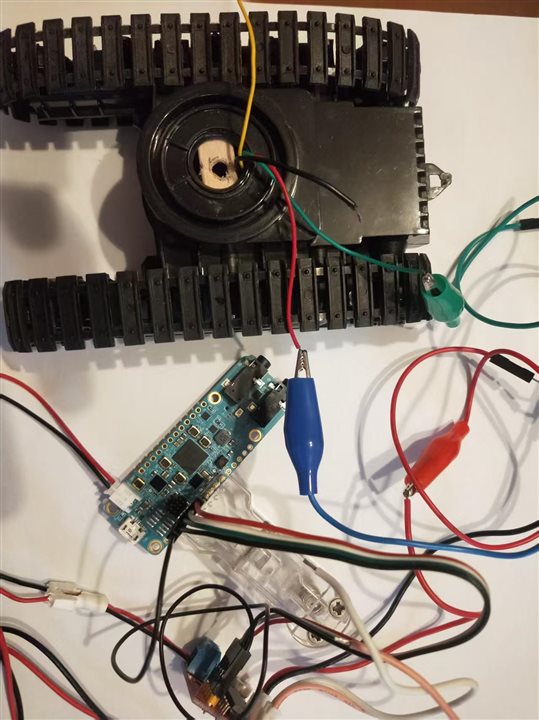

2.6 Motor Control & Safety
Before any motor action, a Bump Check reads P0.7:
  • Triggered: Forces EMERGENCY STOP via motor_stop_all() (all GPIO OFF), then returns to main loop
  • Clear: Passes to madrover(cmd) dispatcher, which calls:
    • STOP (cmd=0): P2.3=P2.4=P1.1=P1.0 = 0
    • GO/FRONT (cmd=1,2): Both tracks forward (A: P2.3=1 P2.4=0, B: P1.1=1 P1.0=0)
    • BACK (cmd=3): Both tracks backward (A: P2.3=0 P2.4=1, B: P1.1=0 P1.0=1)
    • LEFT (cmd=4): Pivot left (A backward, B forward)
    • RIGHT (cmd=5): Pivot right (A forward, B backward)

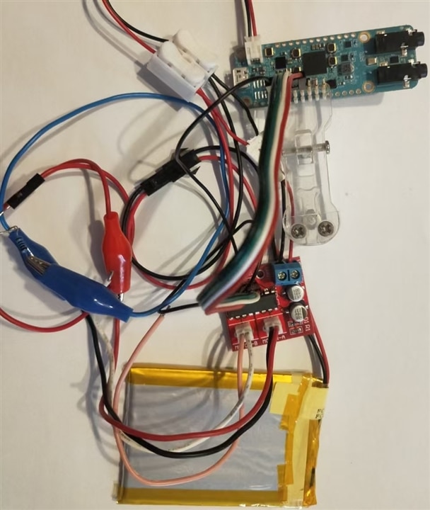

3 Hardware

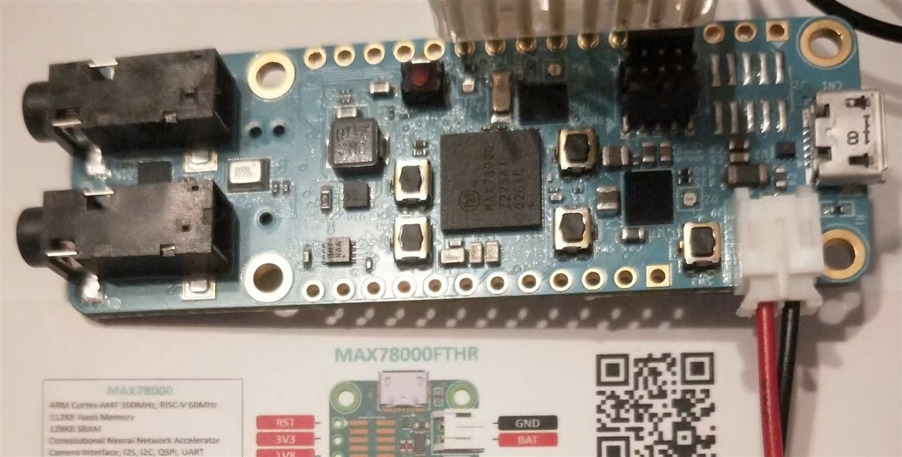

3.1 MAX78000FTHR - AI Microcontroller Board
Role in Project KWS inference, motor control, bump detection
The MAX78000FTHR is the central processing unit of the Deaf Rover. It is an ultra-low-power AI microcontroller from Analog Devices (formerly Maxim Integrated) in the Feather form factor (25.4mm x 50.8mm). The board integrates three processing elements: an ARM Cortex-M4F at 100MHz for application logic, a 32-bit RISC-V core at 50MHz for data movement, and a dedicated hardware CNN accelerator with 64 parallel 8-bit processors capable of 28.8 GOPS. It features 1.5MB flash, 512KB SRAM, an on-board MEMS microphone connected via I2S, and supports multiple low-power modes. The CNN accelerator can execute inference in microseconds and return to sleep, enabling battery-powered always-on keyword spotting.
On board MIC is used in this project as voice detecting source.

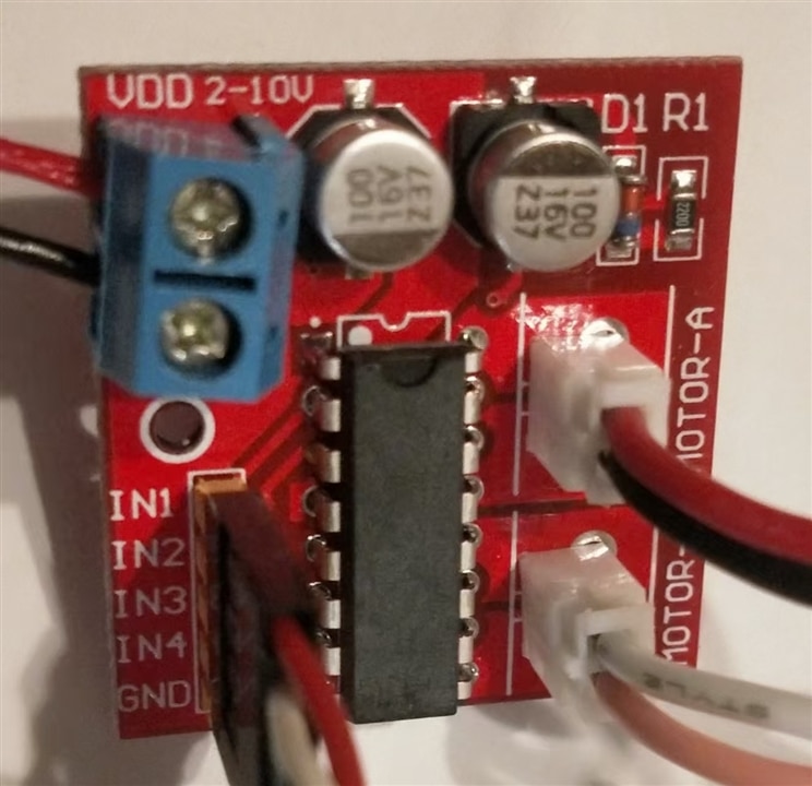

3.2 H-Bridge Motor Driver Module
The H-Bridge motor driver module controls the two DC motors for the tracked chassis. It uses an L293D 16-pin DIP IC that provides dual H-bridge outputs for bidirectional motor control. The module accepts 2-10V DC input for motor power and TTL-level logic inputs from the MAX78000 GPIO pins. It has two 100uF electrolytic capacitors for power supply filtering and includes flyback protection diodes. The module features two 2-pin JST connectors (MOTOR-A and MOTOR-B) for motor output and a 5-pin header (IN1-IN4, GND) for control signals.

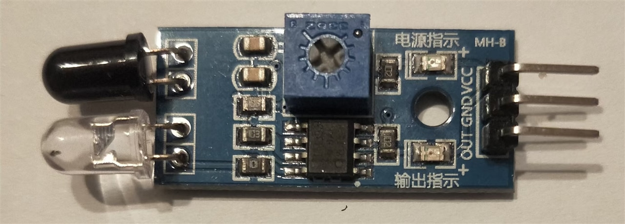

3.3 MH-B IR Obstacle Detection Sensor
Role in Project Emergency stop when obstacle detected
The MH-B IR obstacle sensor provides collision detection for the Deaf Rover. It operates using active infrared reflection: an IR LED emits infrared light, and when an object is within range, the reflected light is detected by an IR photodiode. An LM393 dual comparator IC processes the signal against a threshold set by the onboard 10k ohm potentiometer. The module outputs a digital HIGH/LOW signal on its OUT pin. It has two indicator LEDs: a power indicator and an output indicator that lights when an obstacle is detected. The module connects via a 3-pin header (VCC, GND, OUT) and operates on 3.3V-5V DC with a detection range of approximately 2-30cm, adjustable via the potentiometer.
3.4 LiPo Battery Pack
A single-cell Lithium Polymer (LiPo) pouch cell battery provides portable power for the Deaf Rover. The battery has a nominal voltage of 3.7V, which is fed to the MAX78000FTHR board (operating range 2.0-3.6V) and to the H-Bridge motor driver via a DC-DC boost converter to step up to 5V for motor operation.
3.5   Materials Summary
1 MAX78000FTHR Board 1 AI MCU + CNN + On-board Mic + GPIO
2 H-Bridge Motor Driver (L293D) 1 Dual H-bridge for 2 DC motors
3 MH-B IR Obstacle Sensor 1 Bump/collision detection
4 Tracked Chassis + 2x DC Motors 1 Mobile robot base with differential drive
5 LiPo Battery 3.7V 1 Portable power source
6 USB-C Cable 1 Programming and debug via SWD

4.3Pin Definitions and Hardware Mapping
The motor control system uses GPIO pins defined in board.h, led.h, and pb.h.
The mapping is as follows:
Bump Detect -- P0.7 BUMP_ALERT, (PB[2]) Digital Input
Motor A -- Left Track P2.3, P2.4 LC_MOTORA, RC_MOTORA Digital Output
Motor B -- Right Track P1.1, P1.0 LC_MOTORB, RC_MOTORB Digital Output

4.5 Command Mapping and madrover() Logic
The madrover() function maps voice commands to motor actions. It first checks the bump sensor (P0.7) for safety:

4.6 Bump Sensor Safety Logic
The bump sensor on P0.7 (BUMP_ALERT) provides collision detection. The logic is:
1. Before executing any command, check PB_Get(BUMP_ALERT)
2. If bump sensor is triggered (returns 1), immediately call motor_stop_all()
3. Print "BUMP_ALERT is Trigger" message and force command to STOP
4. This safety check runs both before and after CNN inference

                //v_commands[NUMBEROFCOMMONDS][5] = {"STOP", "GO", "FRONT", "BACK", "LEFT",  "RIGHT", };
                //keywords[NUM_OUTPUTS][10] = { "UP",    "DOWN", "LEFT",   "RIGHT", "STOP",  "GO",  "YES",   "NO",   "ON",     "OFF",   "ONE",   "TWO",
                //                         "THREE", "FOUR", "FIVE",   "SIX",   "SEVEN", "EIGHT", "NINE",  "ZERO", "Unknown" };
                //command = 0;    //uint8_t command = 0;
                if (PB_Get(BUMP_ALERT) == 1){
                    command = 0;
                    printf("\n!!!!!! BUMP_ALERT is Trigger!!!!!!!!!!!!!\n");
                    madrover(command); //Stop the ROVER if it works, check bumps first.
                switch (out_class) {
                case 4:
                    command = 0;
                    break;
                case 5:
                    command = 1;
                    break;
                case 0:
                    command = 2;
                    break;
                case 1:
                    command = 3;
                    break;
                case 2:
                    command = 4;
                    break;
                case 3:
                    command = 5;
                    break;
                //case 20:
                    //Unknow, command = 0;
                    //printf("Unknown, keep command: %d and ", command);
                    //break;
                default:
                    //command = 0;
                    printf("Non_kws, keep command: %d and ", command);
                    //LED_Off(LED_RED);
                    break;
                madrover(command); //TURN ON the ROVER if it works
                Max = 0;
                Min = 0;
    while (1) {}

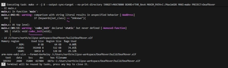

4.8 Build and run the program
Build and download the code
run the code and get feedback from uart terminal

5.1 Hardware Assembly
The hardware assembly consists of:
1. MAX78000FTHR board - Main AI controller with on-board microphone
2. H-Bridge Motor Driver - Controls two DC motors for track movement
3. LiPo Battery - Power source (3.7V nominal)
4. IR Obstacle Sensor - Connected to P0.7 for bump detection
5.2  Test with Tracked Chassis - Two independent tracks with DC motors

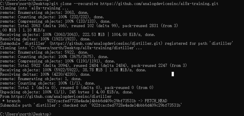

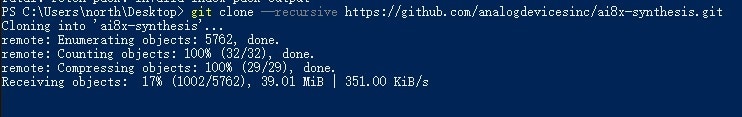

6.4  Two Cli tool for Model training and systhesis for MAX78000 core
Download two toolset from github
Then run with python code under \Script for different models provided.
One can customized model, if customized dataset is prepared. Readme explain clearly how to do.

⦁ Detects 6 movement commands (STOP, GO, FRONT, BACK, LEFT, RIGHT)
