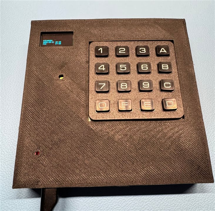

Figure 1: Final desktop workday tracker built from previously unused hardware.
Figure 2: Demonstration of the finished device registering workday events.

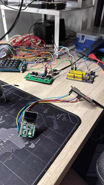

At the same time, I had several forgotten components sitting unused in drawers:
  • A matrix keypad that I had bought years ago and never used.
  • A small SPI OLED display that I had unsuccessfully experimented with using Arduino.
  • An ESP32 development board that had recently become my playground for learning Embedded C and FreeRTOS.
Individually, all of them worked. Together, they had never become a real project.
When the Spring Clean competition appeared, it felt like the perfect excuse to revisit this forgotten hardware and finally give it a purpose.
What started as a cleanup exercise ended up becoming a fully functional embedded product that I now use every day.
ForgottenSPIOLEDForgottenHW
Figure 3: The forgotten hardware that inspired this project — an SPI OLED display, a matrix keypad and an ESP32 development board waiting for a real purpose.

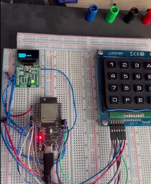

BreadBoard
Figure 4: Early breadboard prototype used for firmware and hardware validation.

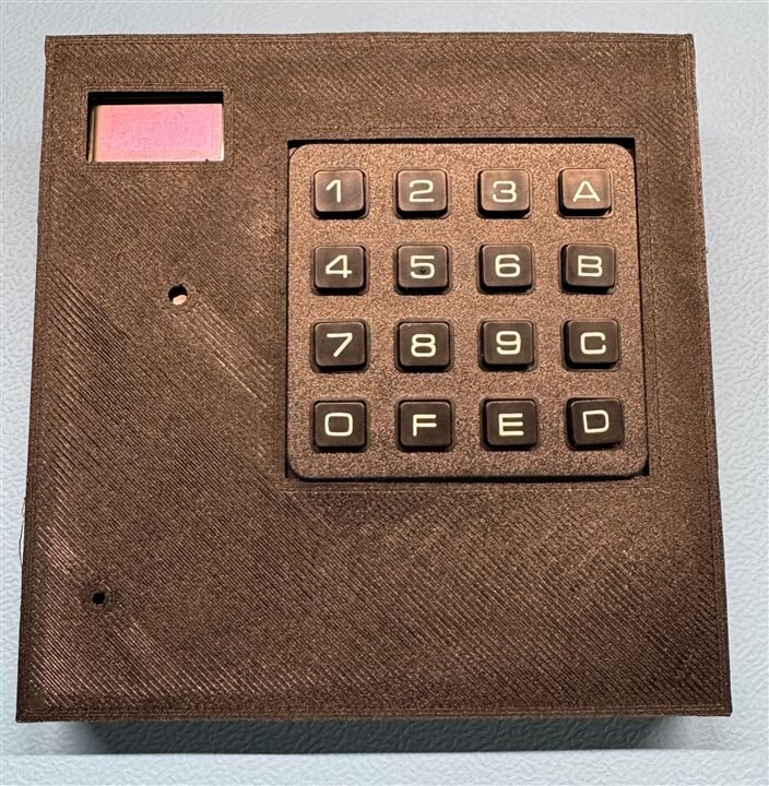

The final step was designing and printing a dedicated enclosure.

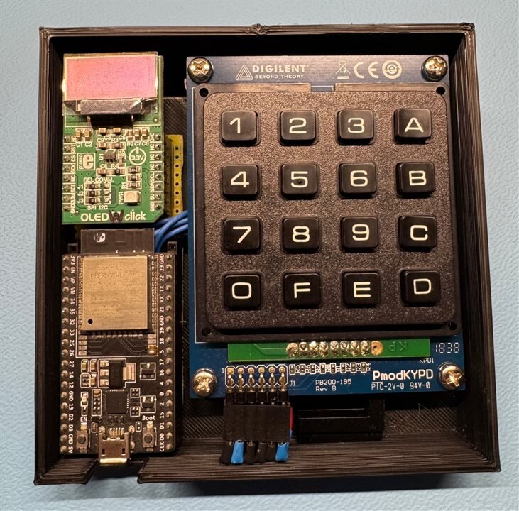

The enclosure integrates:
  • OLED display
  • Matrix keypad
  • ESP32 board
  • Internal wiring
This transformed the project from a collection of development boards into a standalone embedded device.
Several iterations were required to:
  • Align the OLED correctly
  • Fit the keypad dimensions
  • Improve cable routing
  • Simplify assembly
The result is compact, portable and robust enough for daily use.

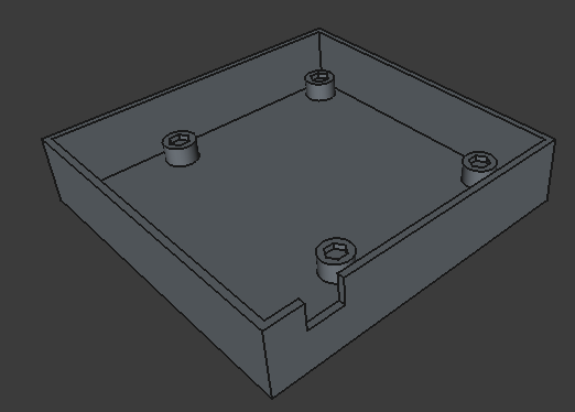

EnclosureDesignBase
Figure 5: Initial enclosure design used to define the overall mechanical layout.

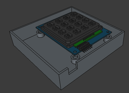

EnclosureDesignBaseKeyPadFitting
Figure 6: Keypad integration and dimensional validation during enclosure development.

AssembledWithoutLid
Figure 8: Internal assembly showing component placement and wiring.
Final
Figure 9: Finished device ready for daily operation.

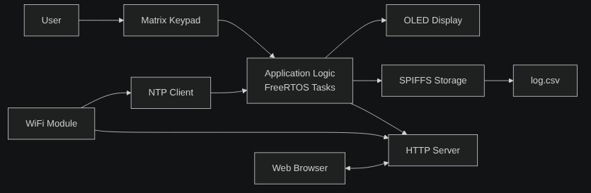

6. Firmware Architecture
The firmware was completely reorganized using a modular architecture.
6.1. Main Modules
The firmware was organized into independent modules:
  • wifi
  • keypad
  • oled
  • storage
  • ntp
  • httpServer
  • common
The system runs on FreeRTOS and uses tasks and synchronization primitives to keep the application responsive.
6.2. Features
  • Event-driven Wi-Fi management
  • Automatic network retry
  • Persistent CSV logging
  • HTTP log download
  • OLED framebuffer rendering
  • NTP synchronization
  • Concurrent task execution
Modules
Figure 10: High-level firmware architecture showing the main software modules.

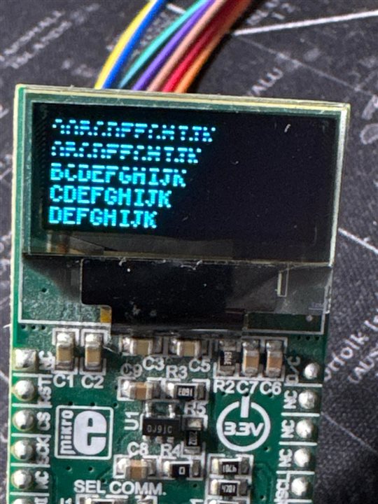

8. The Unexpected OLED Challenge
One of the most interesting surprises came from the OLED display.
The display was not fully functional. Part of the visible area was damaged and unusable. Replacing it would have been the easiest solution.
Instead, I decided to adapt the software. I mapped the remaining functional area of the display and redesigned the rendering layer so that all drawing functions automatically respect the usable region.
As a result:
  • The application never attempts to draw outside the valid area.
  • The OLED abstraction hides the hardware limitation.
  • The rest of the firmware remains completely unaware of the display damage.
This ended up becoming one of the most satisfying engineering challenges of the entire project.
DamagedOLED
Figure 11: Damaged OLED display used during development. The software was adapted to operate only within the functional display area.
FunctionalOLED1
Figure 12: Functional OLED rendering after adapting the software to the usable display region (Example 1).
FunctionalOLED2
Figure 13: Functional OLED rendering after adapting the software to the usable display region (Example 2).
FunctionalOLED3
Figure 14: Functional OLED rendering after adapting the software to the usable display region (Example 3).

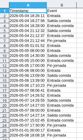

9. Storage and HTTP Logging
Events are stored inside SPIFFS as CSV files.
Example:
2026-05-22 08:01:00,Entrada
2026-05-22 13:12:00,Salida comida
2026-05-22 14:05:00,Entrada comida
2026-05-22 18:10:00,Fin jornada
The device also includes a lightweight HTTP server exposing:
  • Current status
  • Downloadable logs
  • JSON information
This allows the device to be monitored directly from a browser.
Log.csv
Figure 15: CSV event log generated and stored in SPIFFS.
