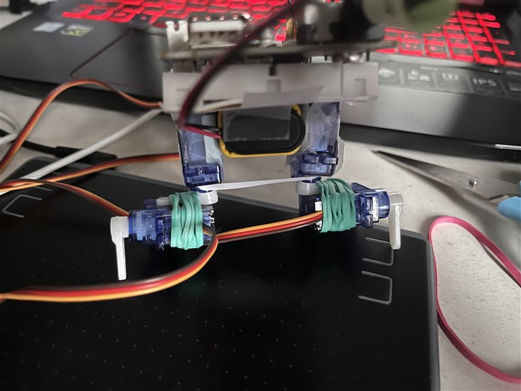

I had to redesign the legs so that there were only 3 servo motors. One servo acts as an axis of rotation to control the direction of the spinning wheels, and the other two spins (moving Murphy forward). This is an improvement from Murphy 1.0 since now it can turn away from obstacles.
I didn’t have any hot glue gun and scotch tape didn’t work to keep the 2 servo motors attached to the axis, so I used elastic bands instead.

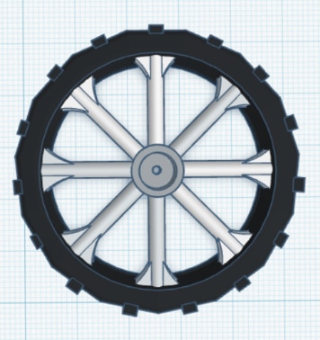

Next, I needed wheels. For Murphy 1.0, I reused water bottle caps for wheels since I didn’t have access to a 3D printer, but recently I’ve learned that my local library has a 3D printer that the public can use. I designed this simple wheel on TinkerCAD for the first time ever

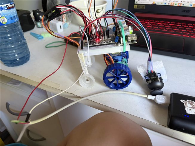

Then, while playing around with my prototype, I realized that it was having trouble turning and was quite unstable because of how there was no back leg support. It could only stand up since I was pulling the joystick module up.
Since I didn’t have a strong enough current to make 2 more wheels for the back, I decided to just make it out of bottle caps again. I designed 3d back legs that had holes for the wheels to screw into.
However, when I added the hind legs on, they just fell off every time. It’s hard to use scotch tape to tape on plastic onto plastic & elastic bands wouldn’t work. So, I had to make a plan 2. I made something like a cape for the back that had 2 water bottle caps on it. This gave better back support, but this is only temporary. In the future, I’d probably add a section connecting the 2 back legs, so the breadboard can sit comfortably on top, something like this. I don’t have enough money to print it out again though.

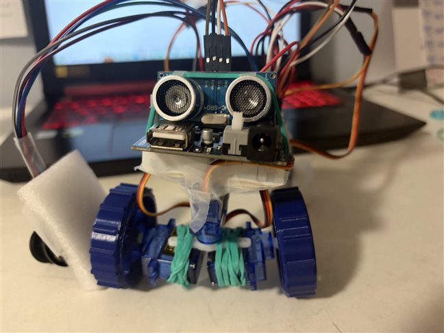

I was also hoping to use another ESP32 to make my joystick Bluetooth but sadly my package got delayed before this competition’s deadline. So this is my final Murphy 2.0, her full name is Ellie Scott Murphy. Ellie for elastic band, Scott for scotch tape, and Murphy since me and my friend both adore the actor Cillian Murphy
I know this is a bit simple but this has been my favourite electronics project by far & I learned so much. When I have a bigger budget I’ll make a Murphy 3.0 with the correct servo motors + a real face
This is now my final Murphy 2.0 ! It can move forward, backwards, rotate,  + As something extra, I decided to add an ultrasonic sensor to notice when Murphy 2.0 got too close to an obstacle, so I could stop it. The ultrasonic sensor is connected to 2 blue LED’s so it’s easy for me to notice. The LED's can also be turned on by pressing the button on the joystick Slight smile
