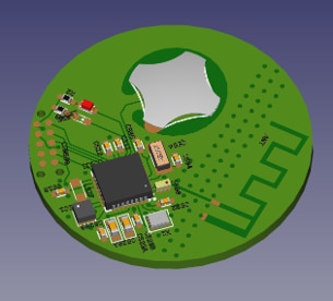

A long time ago I wanted to make a Bluetooth connected pill reminder. A device that goes on the bottle cap of a pill bottle. Goal was to make a device that can detect if a pill bottle was opened and also trigger an alarm (visually on the bottle but also in an app on the phone) if too much time has elapsed since the last opening. I made a PCB and derived a firmware from the TI example project but struggled with the phone (Android) app. I somehow forgot about it and always searched for an excuse to finish it. This Spring Challenge looked like it was just the right time to do it.
PCB

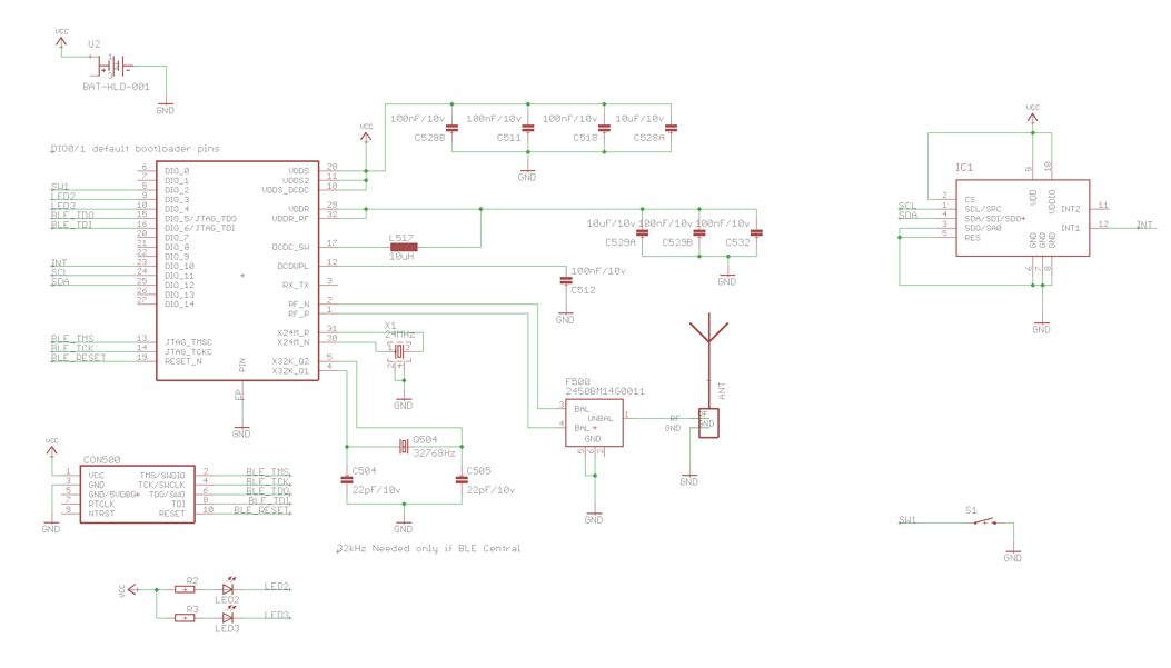

The board is based on the CC2640R2F and is simplified variant of the LAUNCHXL-CC2640R2 evaluation board (no SPI, one button) plus an accelerometer. I don’t have much to say here other than the Tag connect pinout was wrong and only one bodge wire was needed. Blush The balun seemed to work ok for a beginner in RF design.
