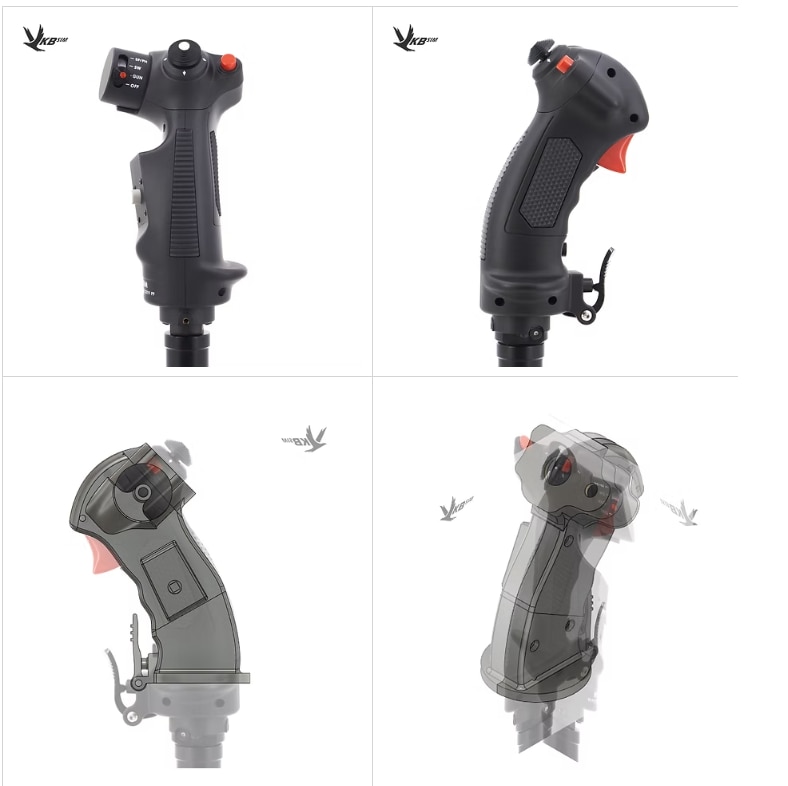

Section 1: Inspiration
After searching around online for reference designs, I came across the Gladiator NXT EVO F-14 Combat Edition (https://vkbsimcontrollers.com/products/gladiator-nxt-evo-space-combat-edition-right-hand-us) — a modern aggressive-looking grip that I wanted to use as design inspiration. Around the same time I had a vintage CH Products FlightStick Pro from an earlier project, so I deconstructed the handle to see what was inside and work out how to design something that would fit the existing base and utilize some of the existing axes/trim knobs
Target games: MetalStorm (PC) and general flight sim use for games like Star Wars Squadrons.

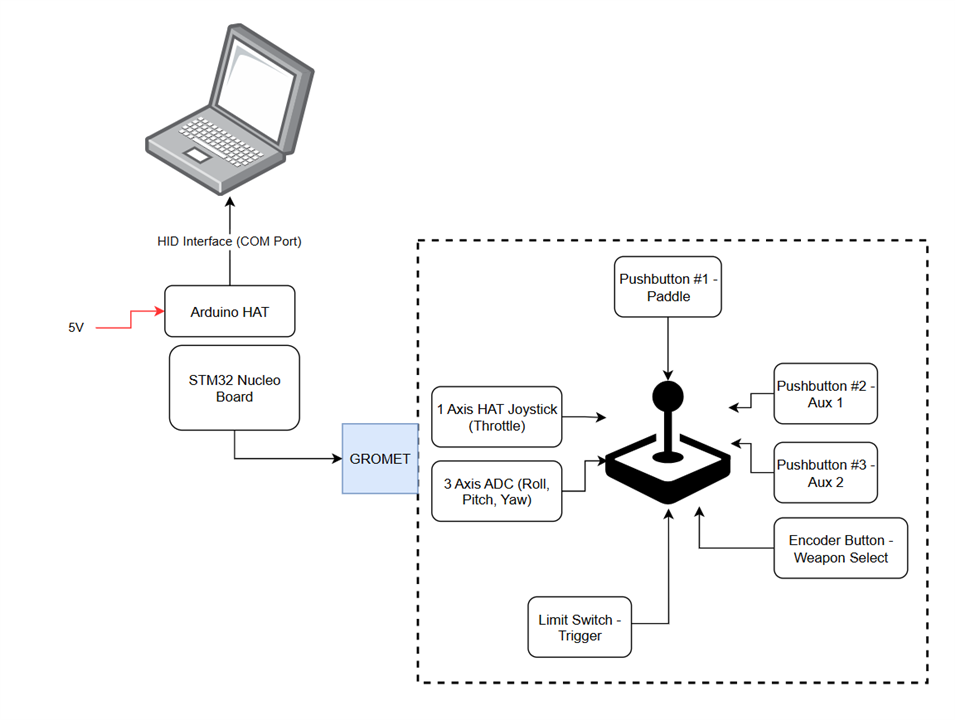

Block Diagram
This block diagram aims to illustrate the major connections and interfaces in this prototype setup

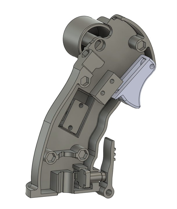

3.1 Mechanical Design
The major difficulties in this design were to get geometry and ergonomics of this flight stick correct and large enough for assembly of internal components, manufacture design and repairs. As a prototype, this was a fun and the most creative part of the design in my opinion.
3.1.1 Flight Stick Body Design
Using Fusion360, I found refence side and rear photos for the F-14 joystick to give the angular shape and design I wanted. Then using the Canvas feature in Fusion360, I began to create the profiles to suit this joystick (top 2 are the original veiws and the bottom 2 are the CAD geometry overlayed onto it) to then be split into two halves for printing and then work out how to locate and mount the other hardware like pushbuttons and encoder internally. This took a long time to get just right, guessing the overall length was around 12-14cm for grip height and nominal sizing. I had to leave space and construction points for the paddle (lower button) and the trigger which was a seperate assembly.

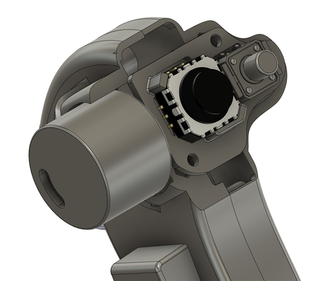

3.1.2 Internal Component Integration
This was the tricky part as some items were not necessarily able to be screwed directly to the body and had to be positioned as part of final assembly, such as the hats on the pushbuttons. The tolerance and bend radius of some of the cables were also considered in the CAD. Being two 'halves', each shell had different parts to be designed, one to act as the 'bottom' of the shell and one to be the 'top' part of the shell - where the screws would enter from. Also, the socket head M3 screws were chosen to give a nice flush appearance and better ergonomics. Some CAD of the other portions such as the control HAT, encoder and the trigger sub-assembly part were also put together and/or glued in. the CAD is not perfect but its manufacturable.

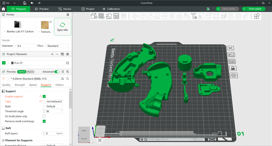

3.1.3 Time to 3D Print!
I borrowed my office 3D printer (Bambu Labs) and was lucky to be able to print the two halves and various bits and pieces such as the throttle pull trigger, hats for the momentary pushbutton and paddle were sorted out easily.

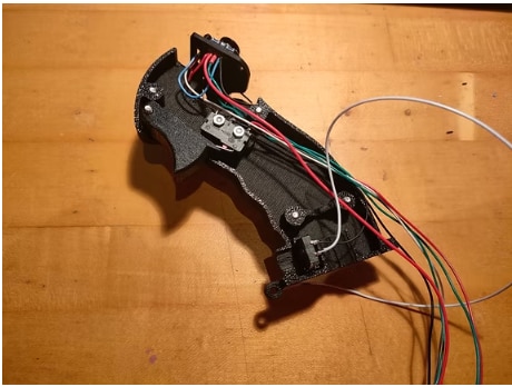

3.2 Wiring the Assembly
With all the parts printed, it was time to start assembly of the hardware. The use of the Arduino HAT on top of the STM32 Nucleo Board made it easy to check wiring as majority of the wires were female jumper wires. Basically all the cables (ground chained together, switch IO, 3.3V power etc) had to run from the parts in the flight stick internal body down through the flight stick base then into a grommet of sorts to be exposed for STM32 nucleo board connection.
image image

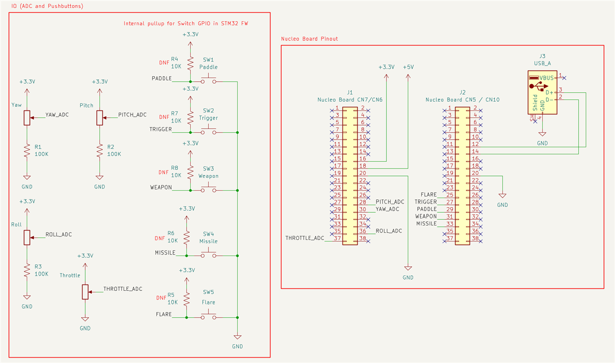

Here is basic schematic in KiCAD to show the electrical connections on the Nucleo board (for possible later full PCBA design, just schematic capture for now):
Eventually all the wires were soldered up and fed out through the grommet to be connected into the Nucleo board (see image below) with each IO pinout carefully labelled to avoid confusion and make debugging easier. Intention was to mainly perform physical pin checking with Nucleo board pinout vs STM32 CUBE IDE mapping

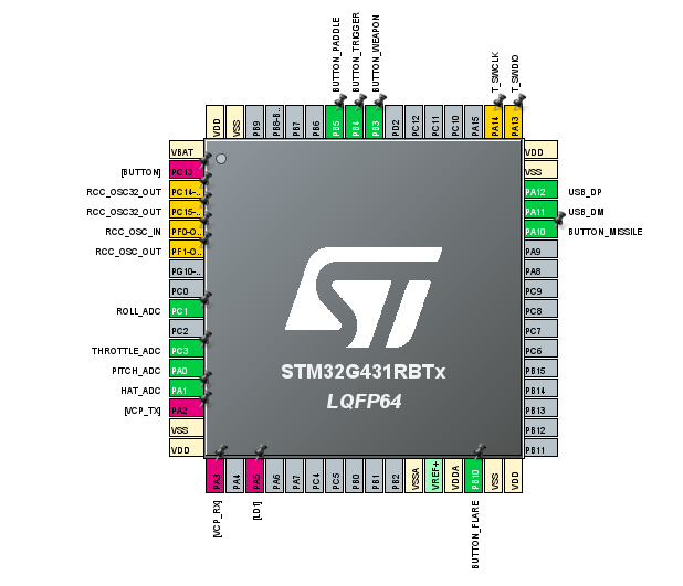

Mapping is as follows in the STM32 CUBE IDE:
ADC Inputs (ADC1, DMA circular)
Signal IOC Label STM32 Pin ADC Channel Nucleo Connector
Pitch PITCH_ADC PA0 ADC1_IN1 CN8 pin 1 (A0)
Yaw HAT_ADC* PA1 ADC1_IN2 CN8 pin 2 (A1)
Roll ROLL_ADC PC1 ADC1_IN7 CN8 pin 5 (A4)
Throttle THROTTLE_ADC PC3 ADC1_IN9 CN8 pin 6 (A5)
Buttons (GPIO_Input, internal pullup, active low)
Signal STM32 Pin Nucleo Connector
BUTTON_MISSILE PA10 CN9 pin 3 (D3)
BUTTON_FLARE PB10 CN9 pin 7 (D6)
BUTTON_WEAPON PB3 CN9 pin 5 (D4)
BUTTON_TRIGGER PB4 CN9 pin 6 (D5)
BUTTON_PADDLE PB5 CN9 pin 4 (D3)

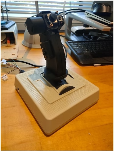

Section 4: Prototype Assembly - It Works!
The rough assembly of the components was done. With the software setup and now flashed onto the Nucleo board, it was time to test it out on the computer. The simplest test was to use the USB Game Controller dialog box and see if it appeared as a HID device - ie check all 4 axes and all buttons worked. Moving the three axes on the vintage joystick panel and the buttons and HAT joystick on the flight stick and all bars and buttons activated as required.

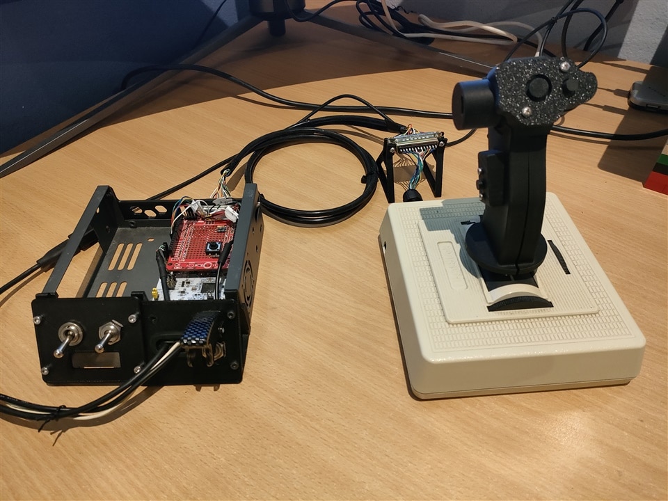

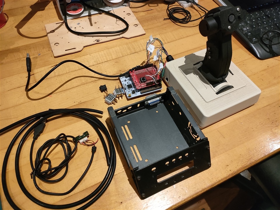

Section 5: The Spring Clean: Finishing It Off (Finally)
This is where the project had been stuck for a while....

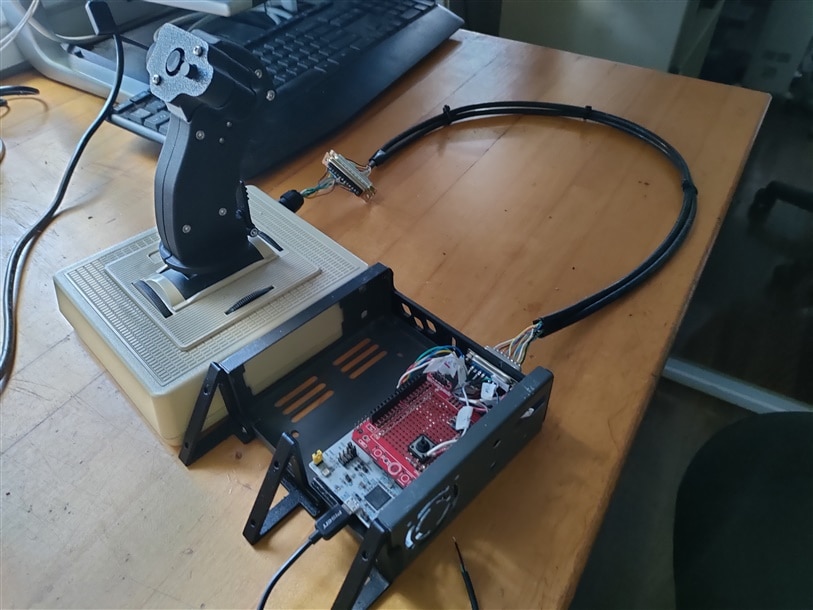

The core electronics were working — firmware tested, axes responding, buttons registering. But the physical build was far from done. Wiring was basic jumper wires straight into the Nucleo board, the enclosure was open, nothing was strain-relieved and the whole thing felt fragile to use. Not something you'd want to actually game with. The spring clean goal was to turn a working proof-of-concept into a finished, rugged controller you could actually pick up and use.

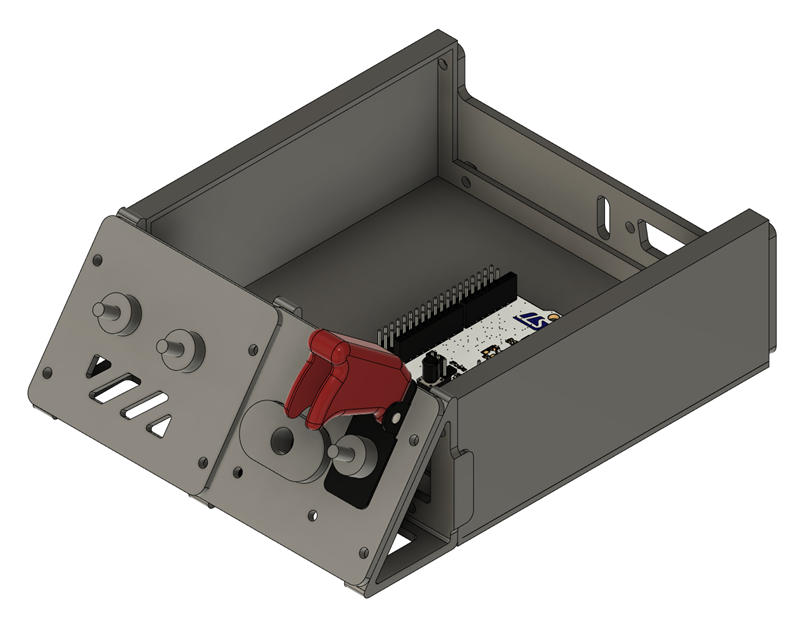

I had an old chassis box from another project which I wanted to use to house some items and make it more complete as a proper flight joystick base structure. Here is the current state of the setup. Ready for the tinkering and final spring clean up and assembly!
The Finishing Touches:

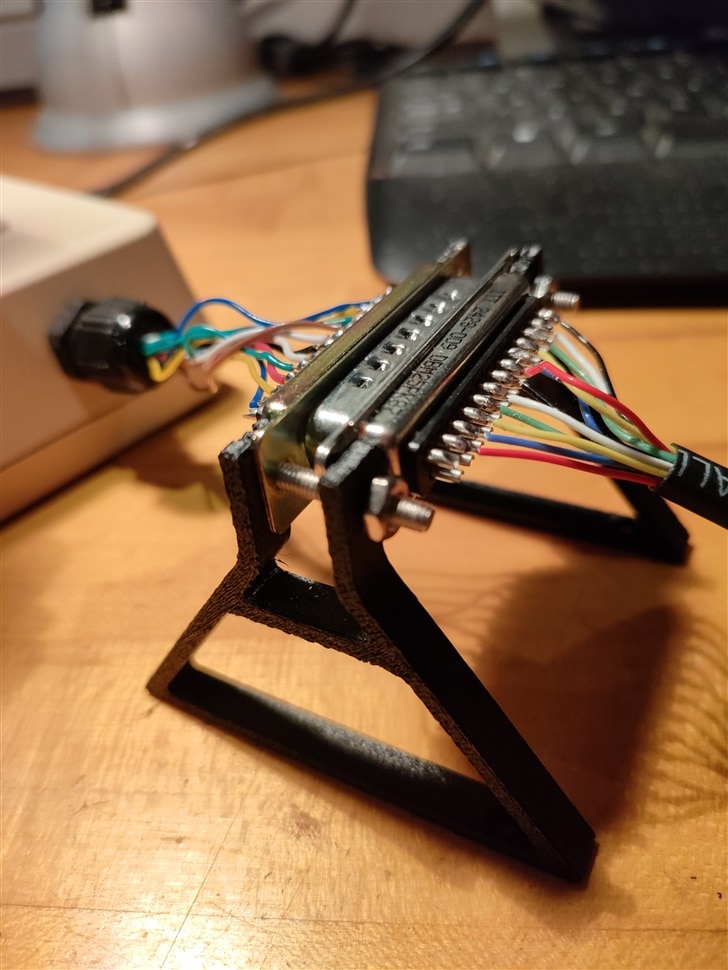

1. Proper extension wiring and making overall wiring more robust. The original wiring was basic — short jumper leads going directly into the Nucleo board headers. Fine for bench testing but not practical for a handheld controller. The grip needs to move freely, which means proper extension cables with enough length to not stress the connections. Replaced the jumper leads with soldered extensions, added heat shrink throughout and made sure nothing was pulling on any connector when the grip moves through its range of motion.
2. Strain relief Every cable exit point through the grip body and base needed proper strain relief so that normal use doesn't gradually work connections loose. An initial grommet was used but since I was intending to use some Dsub 9 pin or Dsub 15 pin connectors, it would be nicer to package these up in a more user-friendly and compact way with some 3D printed parts.
I designed some new parts to better strain relief the cables and tidy up the whole setup, using a spare grommet and a cool guarded arming switch, see CAD below for the assembly, the overall cable was also made more robust with some spare 25pin dsub and spare 15pin dsub connectors used to extend the cable between the joystick itself and the control box for more user friendly lengths. GrabCAD Nucleo board CAD citation - https://grabcad.com/library/stm32-nucleo-64-1. (by Shai Rogel). Gradually finalizing 3D printed components to make the whole setup more rugged and improve connectivity. Add some supports for the 25pin Dsub for the joystick external wires to avoid stress on the cables and also cable-tied the extended harness to make it cleaner. I decided to modify the second front panel to include positions for some tactile rugged switches for future IO.
The final assembled HID joystick! Custom vintage joystick flight stick with Dsub extension cable into the 'control' box with the USB and 5V power for the whole gaming setup. Due to some last minute power issues, the STM32 board was not powering up through the power switch so I added the wall-wart 5V/3A supply into the board for final testing.
Testing on computer and with Star Wars Squadrons (see video) - was a satisfying experience! Phew phew phew (can be heard over the tactile buttons)
