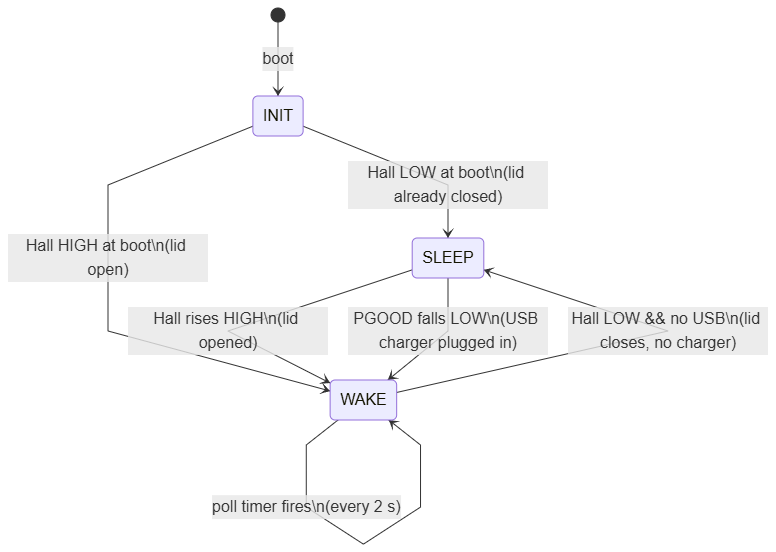

State machine
The system has two states: awake and asleep. The hall effect switch (AH1806) tells us which one to be in.
The hall switch (PA0) is active-low: LOW = magnet present = lid closed, HIGH = no magnet = lid open. The firmware reads the GPIO pin directly in the main loop — no debounce state machine needed because we re-read on every iteration. If the pin is LOW and there's no USB, we enter Stop 2 mode immediately.
If USB is plugged in while the lid is closed, the PGOOD interrupt wakes the MCU and the USB-present check keeps it awake so the display shows the charging state. This way you can plug in and monitor overnight without opening the case.
Sleep implementation
Stop 2 on the STM32U031 cuts the main voltage regulator but keeps SRAM, GPIO output latches and the EXTI logic alive. The target is under 15 µA for the MCU. The LP5907 LDO (always-on) adds ~75 µA quiescent, which dominates.
Thing to note, just like my keebdeck keyboard project, a pending SysTick interrupt causes WFI to return immediately without entering Stop 2. You must call HAL_SuspendTick() first and HAL_ResumeTick() after the clock restore. I learned this from a keyboard firmware project on the same MCU family; without it, the chip never actually sleeps.
Similarly, all EXTI pending bits must be cleared before WFI. I write both EXTI->RPR1 and EXTI->FPR1 directly rather than using the HAL macro, which only clears one direction depending on the version.
The SSD1306 must be re-initialised after wakeup because the AO3401 cuts its VCC during sleep. The other I²C peripherals (ADS1115, OPT3001, MAX17048) stay powered through LP5907 and their register values survive Stop 2 — they need no reinit.

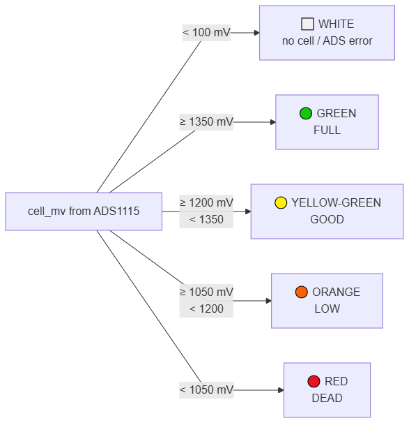

Voltage to LED colour
Each of the six WS2812B-4020 LEDs corresponds to one Decapo cell. The mapping has four levels, identical on both the LED and the OLED battery icon:
The white state is important: if an ADS1115 chip fails to init, the two cells it would have read stay at 0 mV in the buffer. The < 100 mV guard catches this and lights those LEDs white rather than red, so the user can distinguish "dead battery" from "no battery in this slot" at a glance.
The thresholds are for NiMH chemistry (nominal 1.2 V). Adjust BAT_THRESH_* in battery_map.h once the actual Decapo chemistry and the resistor divider ratio are confirmed on hardware.
Global brightness is set by the OPT3001 lux reading, linearly mapped from 15 % at 1 lux to 50 % at 10 000 lux:
brightness_percent = 15 + 35 × (lux − 1) / (10000 − 1)
This keeps the LEDs dim in a dark bedroom at night and comfortably readable in daylight without blinding anyone.

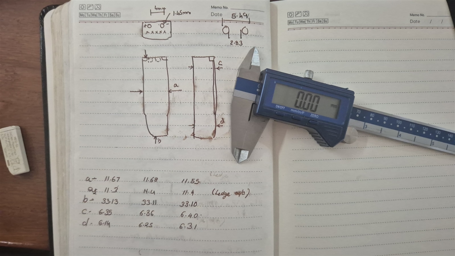

Mechanical Casing

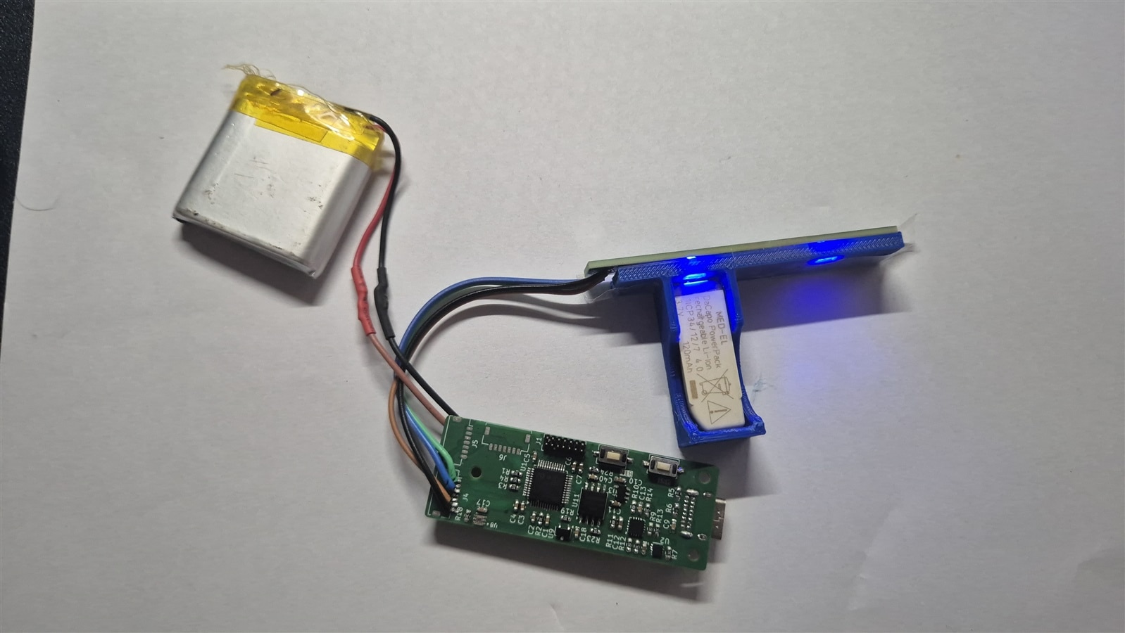

I wanted the battery to be popped in, and it should stay by the force of the pogo pins, with careful measurement of all the dimensions and some experimentation it works. You can see how beautifully the LED is casting the gentle glow on the Battery.

Results so far
The firmware compiles cleanly under STM32CubeIDE and the bring-up tests (RGB colour cycling, lux-brightness, cell voltage reading, OLED update) all worked on . The sleep entry and wakeup sequence works correctly on hardware: closing the lid blanks everything and the serial terminal shows the Stop 2 entry message. Lifting the lid brings everything back within ~200 ms.
Now, I realized a major design flaw. The ADS cannot measure voltage more than the VCC which is 3.3V in this case, So i will have to redesign the Pogo Pin PCB to provide a network bridge enabled by a mosfet for low power usage. This means i coulnt complete the whole project as such but all individual unit test is completed and validated. Hoping to wrap it up by another 15 days.
