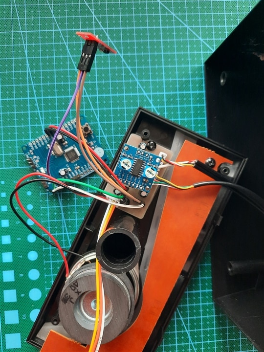

I have a pair of PC speakers, powered by 5V, they also have addressable LEDs built in, thus offering a more special look. But these speakers also have problems, the first being a broken LED that I had to replace, easy job, it's like done. The other problem I couldn't solve, something is damaged on the electronic circuit. It mostly contains: audio amplifier, digital volume control and an unencrypted IC but which I think has something to do with LEDs control.
{gallery}Original circuit board
IMAGE TITLE: Circuit board

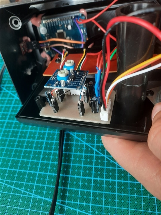

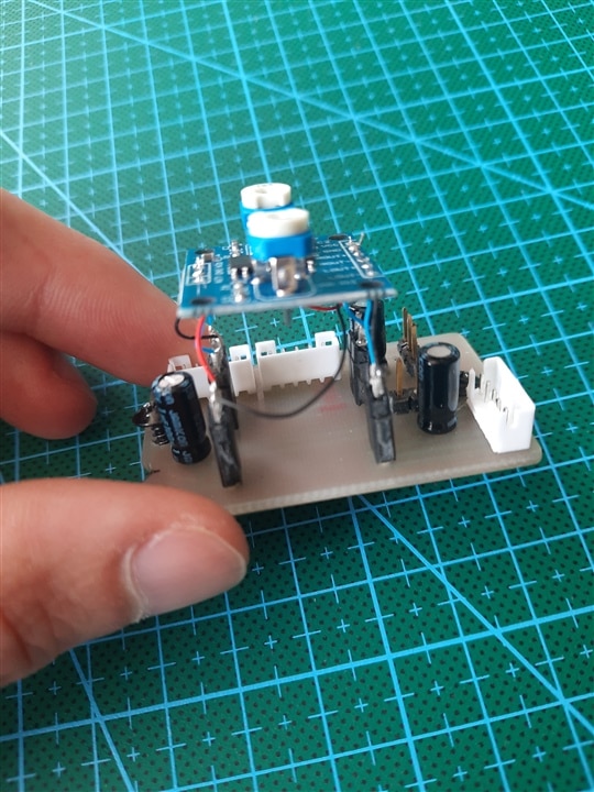

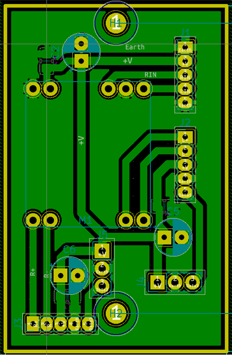

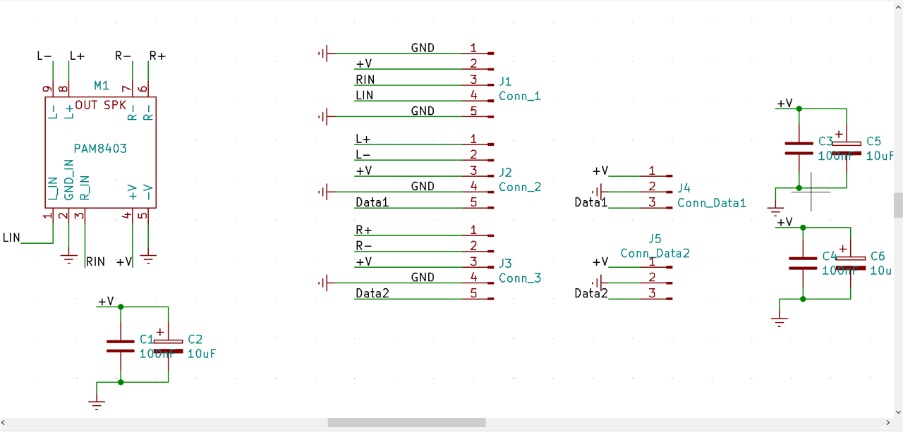

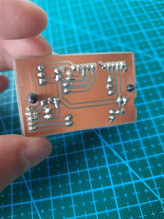

I applied the DIY version using a PAM8403 (initially) as an audio amplifier (the well-known module that you can buy almost everywhere), and for LEDs control I have a microcontroller.
I designed a circuit in Kicad, then I made a more homemade PCB let's say (given that I only need one piece, it didn't make sense to buy, more) on which I mounted the PAM8403 module and some pin headers to connect with jump wires. I know that this module doesn't have a volume control but I don't mind this, it's basically just made to "sing".
I have a very basic schematic and PCB:
{gallery}Schematic + PCB
IMAGE TITLE: Basic schematoc
IMAGE TITLE: PCB
After doing some tests I was quite satisfied, until I added LEDs control. That's how another problem appeared, interference and an unbearable noise that bothers anyone's ear. When the LEDs are on and I apply a light show, a very sharp sound is heard, and without playing music. It's less noticeable during music playback, but otherwise it makes its presence felt. I don't think you want to hear it, I'm very serious.
Noise record.m4a

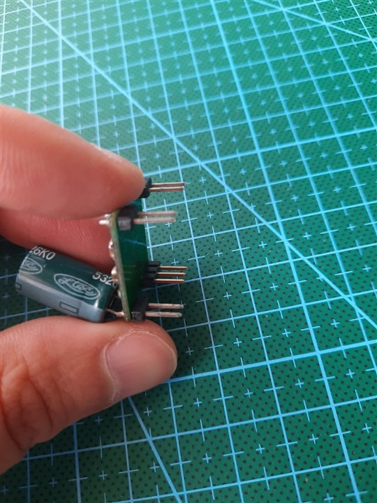

I can't accept that, so I tried an upgrade to the PAM8406 which, as mentioned in the datasheet, performs better in terms of noise and interference.
Indeed, it is a considerable upgrade, it is not perfect but it is certainly better now. That sharp sound is still audible but weak, only if I put my ears in the speakers.
Since I made the original PCB for the PAM8403, I also tested it on this one, basically I improvised by soldering some wires (I mean painstaking work Sweat smile).
I will leave it as it is until I can make a suitable PCB for the PAM8406.

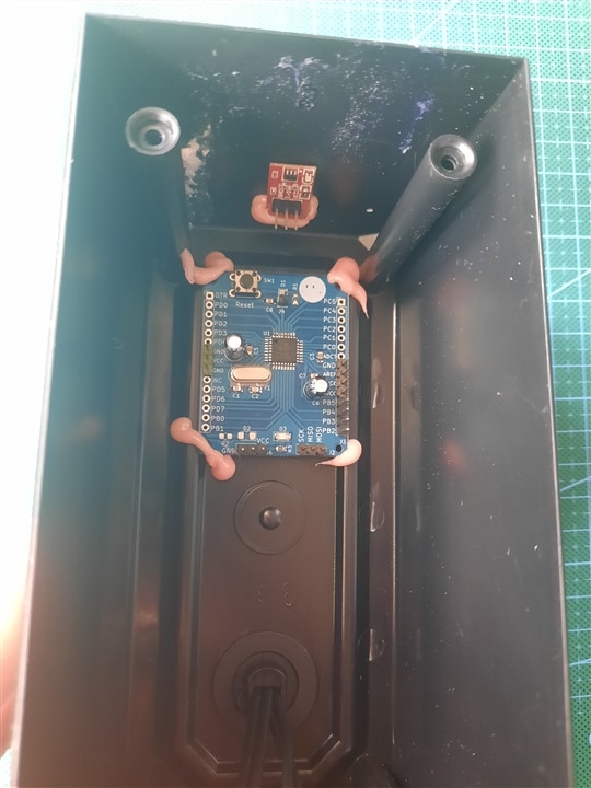

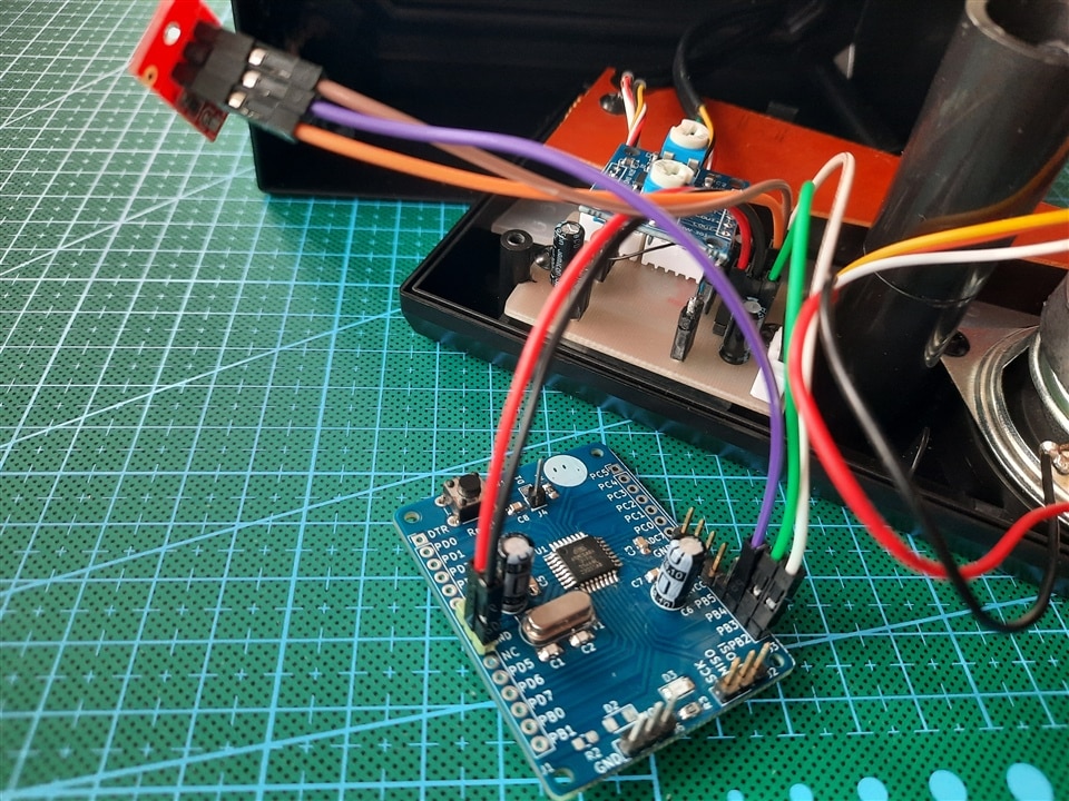

2. WS2812B addressable LED control
As a controller for the LEDs I have an ATMega8 mounted on a simple board, a minimal one. Another option for LED control would have been some simple controllers but since the speakers initially had brightness adjustment I finally opted for a microcontroller because it allows me to use my imagination as well. So I integrated a TTP223 touch button.
We also have a program written in Arduino IDE using the FastLed library. There are 6 operating LED effects: Gaussian pulse, Gaussian ping-pong, meteor effect, random single LED fade and sparkle effect. Using TTP223 I can go through these effects as I want.

As for assembly, some manual work, nothing special.
{gallery}Assembly
IMAGE TITLE: Assembly
I also leave you a video (not maximum volume, I don't want to disturb the neighbors).
What do you think of my DIY project? Grin
Thank you and have a good day!
