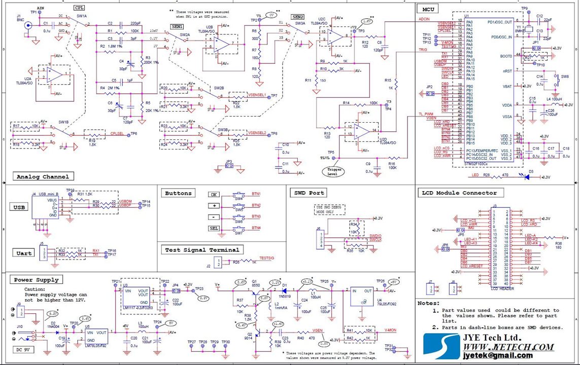

Like many electronics enthusiasts, I have a few unfinished projects that end up sitting on a shelf waiting for the right combination of time, motivation, and patience. One of those projects was a DSO138 oscilloscope kit.
The DSO138 was assembled several years ago as a learning project, but I never managed to get it fully operational. Although the hardware appeared complete, the oscilloscope did not function correctly and was eventually put aside.
For this Spring Clean challenge, I decided it was finally time to revisit the project, troubleshoot the issues, and turn it into something useful. Once the oscilloscope was working, I also added a small function generator module to create a complete basic signal testing setup.
The Original Project
The DSO138 is a compact digital oscilloscope kit designed as both a learning tool and a functional test instrument. After assembling the kit, I expected to start experimenting with signals and waveforms, but things did not go as planned.
When powered on, the oscilloscope would not display useful waveform information. I either saw a blank or white screen, or no meaningful signal display. Despite spending time trying to diagnose the problem, I was unable to get the oscilloscope working reliably.
Eventually, the project joined the collection of unfinished electronics builds waiting for another chance.
Revisiting the Oscilloscope
When I returned to the project for this challenge, I started by reviewing the original assembly documentation and reading through discussions from other DSO138 builders.
Many users reported symptoms very similar to what I remembered experiencing. Common causes included:
  • Jumper configuration issues
  • Calibration setup problems
  • Display-related solder joints
  • Connector issues
  • Small assembly mistakes that are easy to overlook
Since several years had passed since the original build, I approached the oscilloscope almost as if I were troubleshooting it for the first time.
I carefully inspected the board, compared the assembly against the documentation, checked the jumper and calibration sections, and examined solder joints throughout the circuit.
After systematically working through these areas and correcting several questionable connections, the oscilloscope finally began behaving as expected.
The display came to life and waveforms could finally be observed.
With the display functioning properly, I moved on to testing.
The display came to life and was able to show stable waveforms when a signal was applied.
