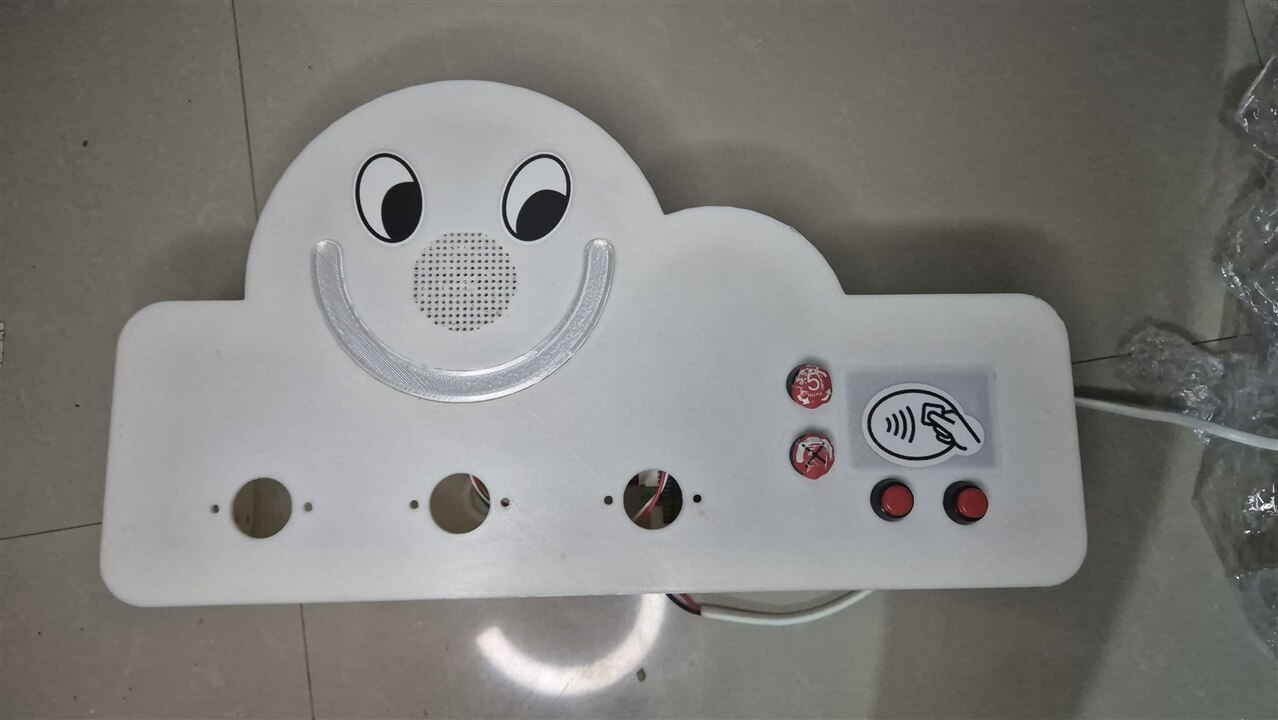

About a year ago, I built a children’s music and light experience -  an RFID-based jukebox for a friend who works closely with kids. The idea was simple: swipe a card, and it triggers a specific piece of music along with a synchronized light show. It was aimed at calming down hyper kids. It turned out to be a huge hit. The kids absolutely loved it. Below are photos of the actual installation in the Play school.The Smile acted as a timer btw.
Kindly Do watch Explainer video above first.

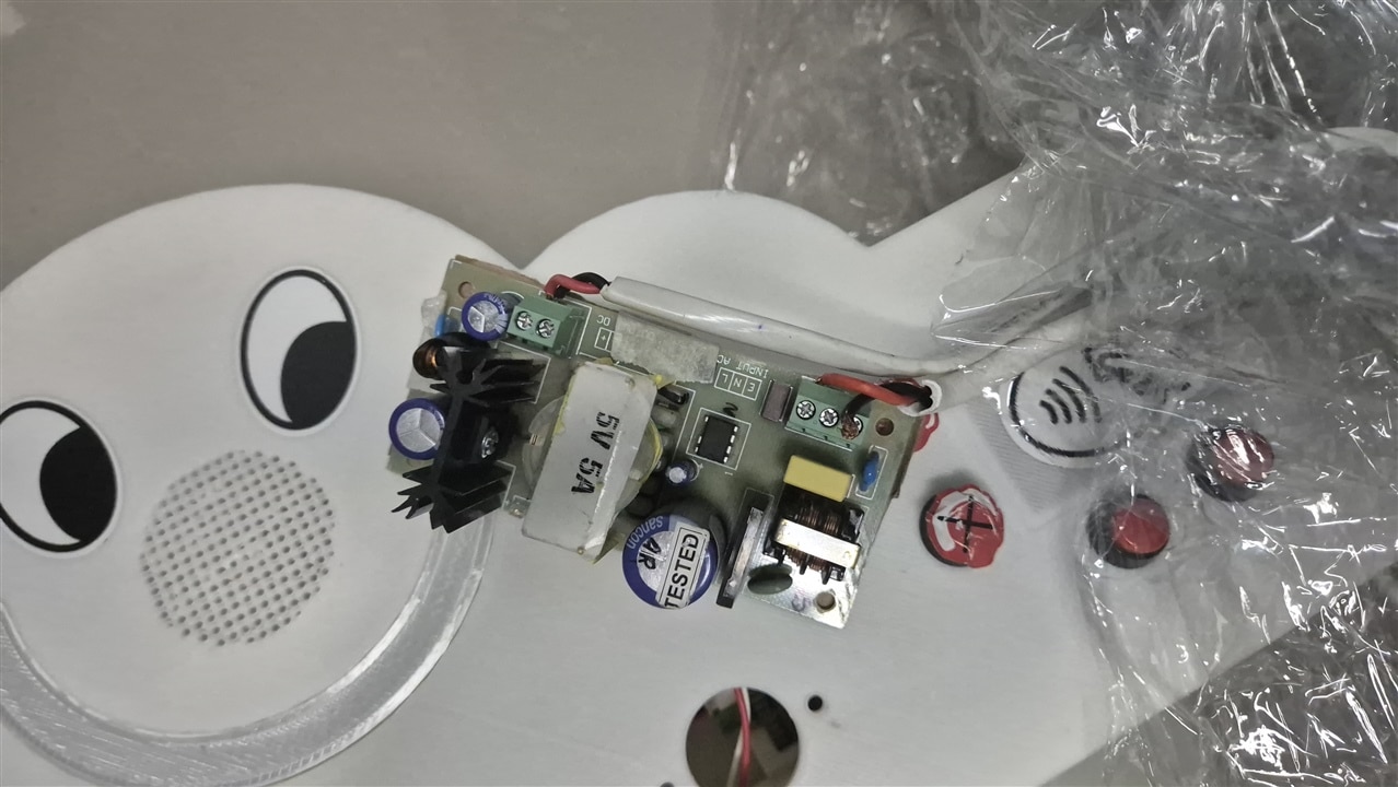

They wanted to try it as an experiment before they invested a huge sum of money in a proper commercial device.  The experiment was successful, but they never managed to raise the money for the commercial device. Now, It worked well for around 6 months, but then the LED Stopped working. Over time, the device went through quite a bit of wear and tear. Buttons were pressed enthusiastically, cables were tugged, and parts that weren’t fully finished in the first iteration started to show their weaknesses. I left out a huge hole in the front. THey did use a tape to cover it. Kids will be kids
Here is a video during the actual development
After evaluating i decided the following changes
  1. Replace the long beefy power supply brick with more portable one.
  2. Fix the LED strip
  3. Clean up the wires inside
  4. Fix the loose speakers
  5. Put in the Arcade Switches
I can't believe that i used a uncovered power supply unit that had exposed Live 220V wires, Yes i told them to put this in an electrical junction box out of the reach of kids and that's what they did, but still i shouldn't have done this. You can see the power cable is nowhere visible in the installation but still it was very inconvenient.

Inside, there is a Nucleo F103 board with a VS1053 shield and a SD Card adapter, connected to it by wires are an RFID  Card reader, multiple panel mount switches, a 3W amplifier and 5W speaker. Yes, I know the speaker is overkill, But that's all i could access to in the time i had.
The Fix
Using Cable ties, i cleaned up the wires, 3D Printed an adapter to secure the speaker. Resoldered the LED strip wires and secured it with epoxy glue. This problem, I have to own it as it was due to a sloppy soldering job. So the epoxy glue will hold the cables securely.  I also used some heat shrink tubes to secure the connection of wires to the panel mount switches. and replaced the power supply with a smaller wall adapter type.
