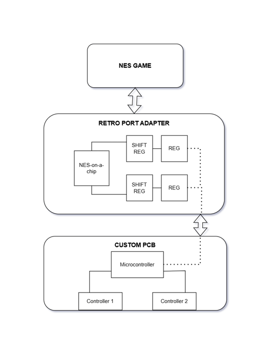

Once I had learned the secrets under the hood, it occurred to me that the Retro Port Adapter could be transformed into a stand-alone NES clone and that is what I set out to do.  My approach in this endeavor is illustrated in the diagram below.
The key facets of the design are as follows:
1 a microcontroller is required to carry out the functions originally performed by the Super Nintendo
2 the two NES controllers must be read out in a serial fashion just like in the original NES
3 the microcontroller acts as the master of the Super Nintendo cartridge bus
4 in its role as master, the microcontroller would require dedicated I/O for the 8-bit data-bus, read/write strobes, and select address lines
5 (after reading from the controllers) the microcontroller will write to the two holding registers that reside on the Retro Port Adapter

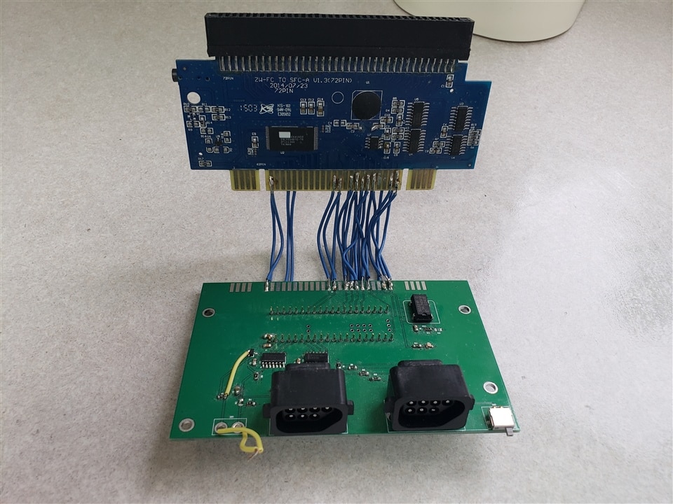

At any rate, lets get acquainted with this Frankenstein monster.
Blue Board this is the Retro Port Adapter without its plastic shell.  The black clump conceals the infamous NES-On-a-Chip device
Green Board this is a custom board that ties everything together.  It includes two controllers and a site for the Teensy++ microcontroller board
Teensy++ the Teensy++ resides on the underside of the Green Board.  Its position can be worked out from the through-hole pin pattern in the photo above
It's not all doom and gloom, though.  There are some silver linings.  For instance, those 22 AWG wires are so strong they serve as a support structure for the Retro Port Adapter PCB.
The real positive though is that, ugly or not, this 'thing' actually worked.

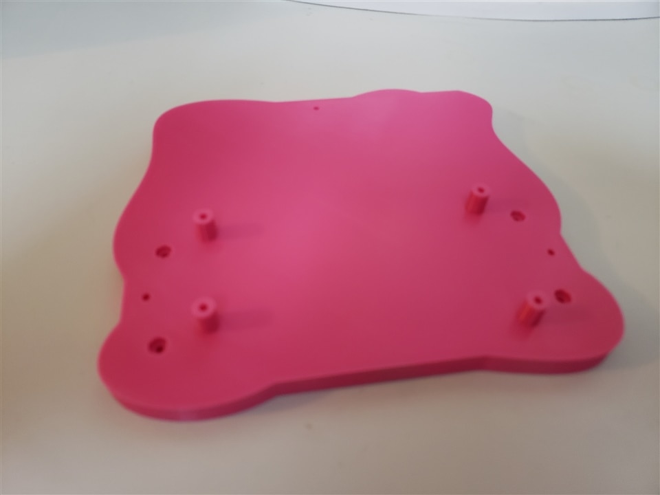

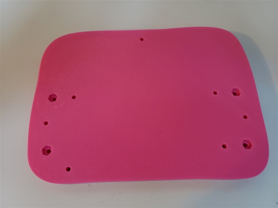

I resolved then to print some kind of tentacle container.  However, I had never worked on a 3D design before so I was both excited and a little nervous at the prospect.  I installed Autodesk Fusion and went to work on the base.  Since I don't have my own 3D printer I used a local service and here is the result.
The printer used a 0.2mm nozzle and overall I was impressed with the build quality.  It was done in PLA but the 3D print lines were less pronounced than examples I've seen in the past.
You will notice that there are 4 posts. These were added to elevate the green board.  Well, that was the plan anyway, but in my haste I accidentally added them when the model was flipped.  This caused their XY positions to be mirrored, so it was back to the drawing board.

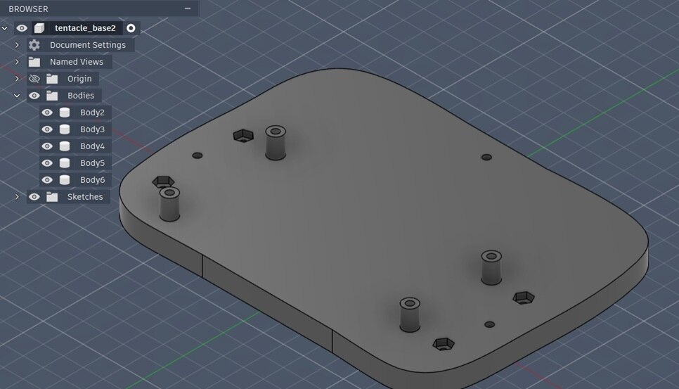

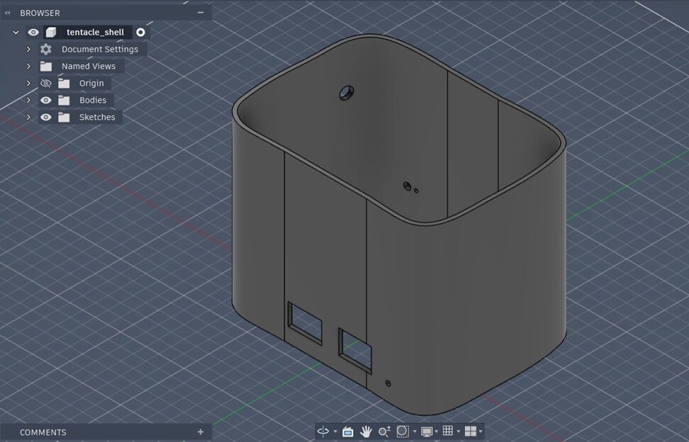

This is the revised base in Fusion:
I designed nut-traps on both sides of the base.  The ones on the reverse side, which are not visible in this view, are used to fasten the board and secure the base to the shell.
The shell itself is pictured below:
Unlike the blob-like shape of the first iteration, this time I opted for a simpler geometric shape.
This is what the new base looked like upon receipt:
Overall I was happy with the results.  However, I made an amateur mistake and it cost me my posts.  In the design process when I was extruding the posts I forgot to select the option to join them to the main body.  As a consequence they were not included when I exported to STL.

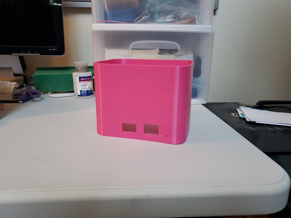

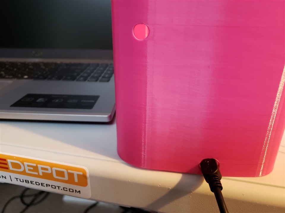

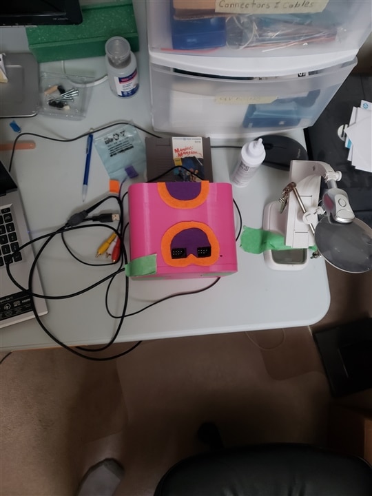

Here is how the shell turned out:
I had become accustomed to seeing so many 3D printed parts in bland colors, so seeing this shell in a bright and bold pink was a revelation.

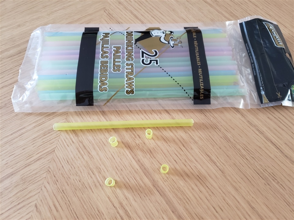

My first challenge was dealing with the missing posts.  I figured that 1cm nylon spacers would serve as a suitable substitute, but finding them in a brick and mortar store was another matter altogether.  In the end I bought some reusable straws and cut them to length.  I filled the straws with rolled paper to limit the space around the screws.
The effects of gravity caused some of the holes in the shell to deform slightly.  It was necessary, for instance to file down the hole for the toggle switch and installing the mini USB power cable took a bit of elbow grease.

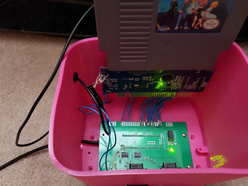

From there it didn't take too long to install the board into the housing.

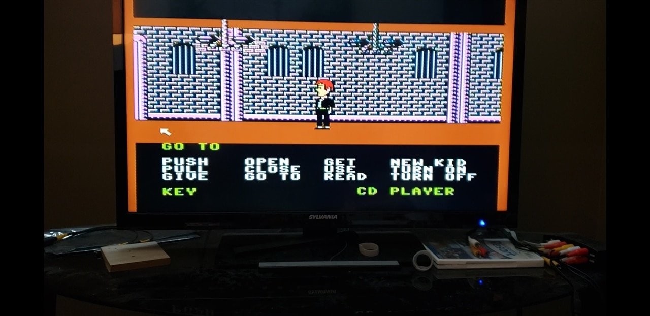

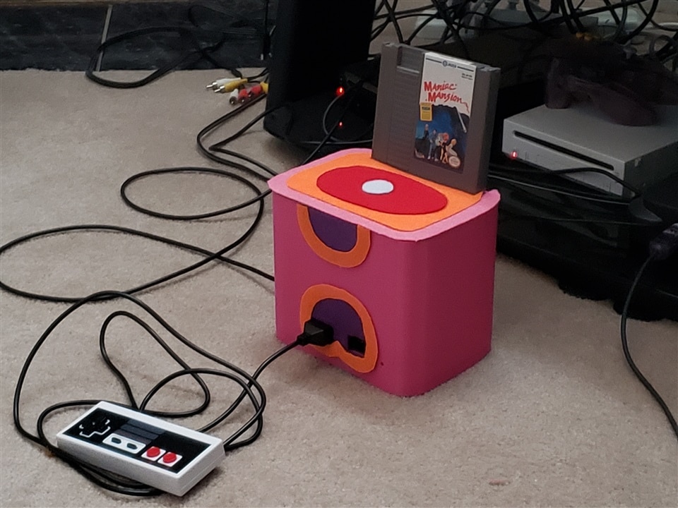

 A quick functional test revealed that the game was working and I played just long enough to end up in the dungeon.
Originally I had considered painting the tentacle's markings but the pink glossy finish gave me second thoughts. At some point I decided that felt would do the job and also provide a bit of depth (i.e. make the features jump out a bit).  The white bottle in the picture below is Aleene's Felt & Foam Tacky Glue.  It was good for bonding fabric to fabric and fabric to PLA.
I wasn't quite done with the felt.  I used some to make a lid and give the impression that the tentacle was severed cleanly with a bone saw.  Yes, I know that tentacles are invertebrates.
Anyway - let's see it in action.
Initially when the Spring Clean challenge was announced I didn't think I had a suitable project on the back burner.  Eventually though, I remembered this diamond in the rough from 8 years back.  In the end I am so glad I participated in this challenge.
While it could be said all I did was make a bucket with velvet patches, the experience meant much more to me than that.  It connected me to the past, first by revisiting an 8 year old project, and then again when I played the game itself.
