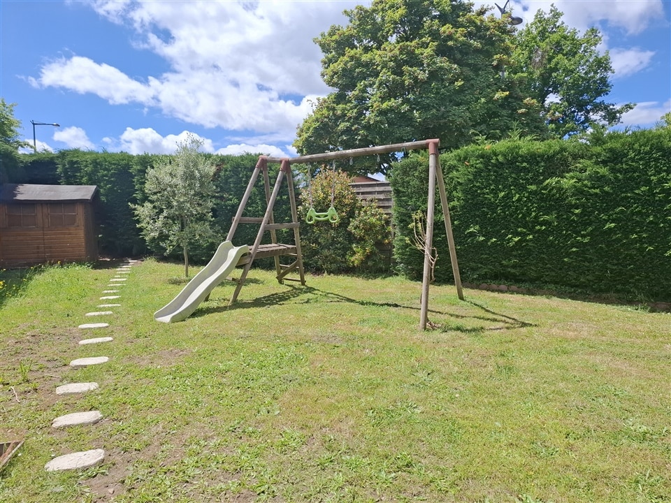

Back when my kids were younger, we bought a wooden swing and slide “playground” that was anchored to the ground with four cement blocks. As they overgrew it, it has been sitting there without much use and because of a design flaw, it even started to bend on itself as can be seen on this picture:
The bend at the top is due to the fact that the manufacturer did not provide a single beam for the top, but rather one long and one very small that are “joined” by the metal piece in the middle. As it turns out, and that was visible early in the life of this installation, this led to some bending, which thankfully never turned into a full blow security risk.

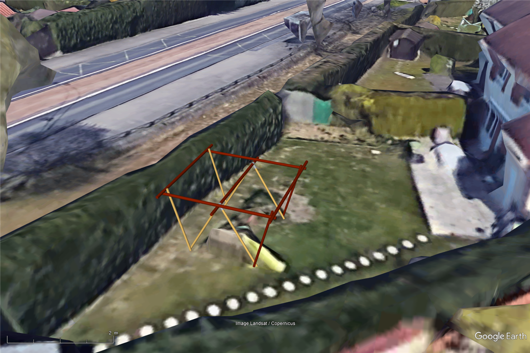

This got me thinking as to how I could apply the same concept to my slightly different situation, and with the help of both Google Earth and FreeCAD, I came up with three potential arrangements, bearing in mind that this should reuse wood as much as possible while being reasonable in cost.
On the following pictures, the existing wood is in yellow while new one is in brown.

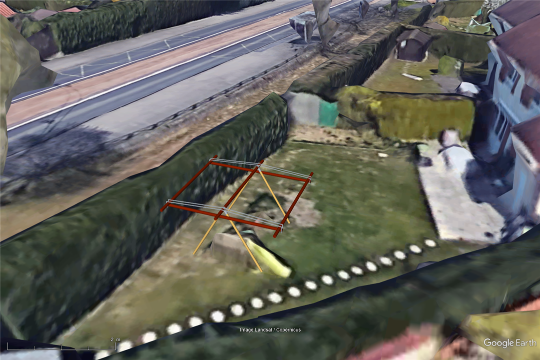

The first idea was to “suspend” the roof with chains so that it could slightly move with the wind, while not obstructing passage around the existing legs:
This one has the highest cost and I was doubtful of its stability, on top of making the roof go quite low at around 2m from the ground. This led me to this second design:
This reused even more wood and the stability would be greater, but creating the joints a mid-height on the existing legs was a mind puzzle for me. I mean, I could always use metal plates and bolts, but it felt like it would apply lots of pressure at the midpoint of a beam, which to me is the exact location of its weakest point.

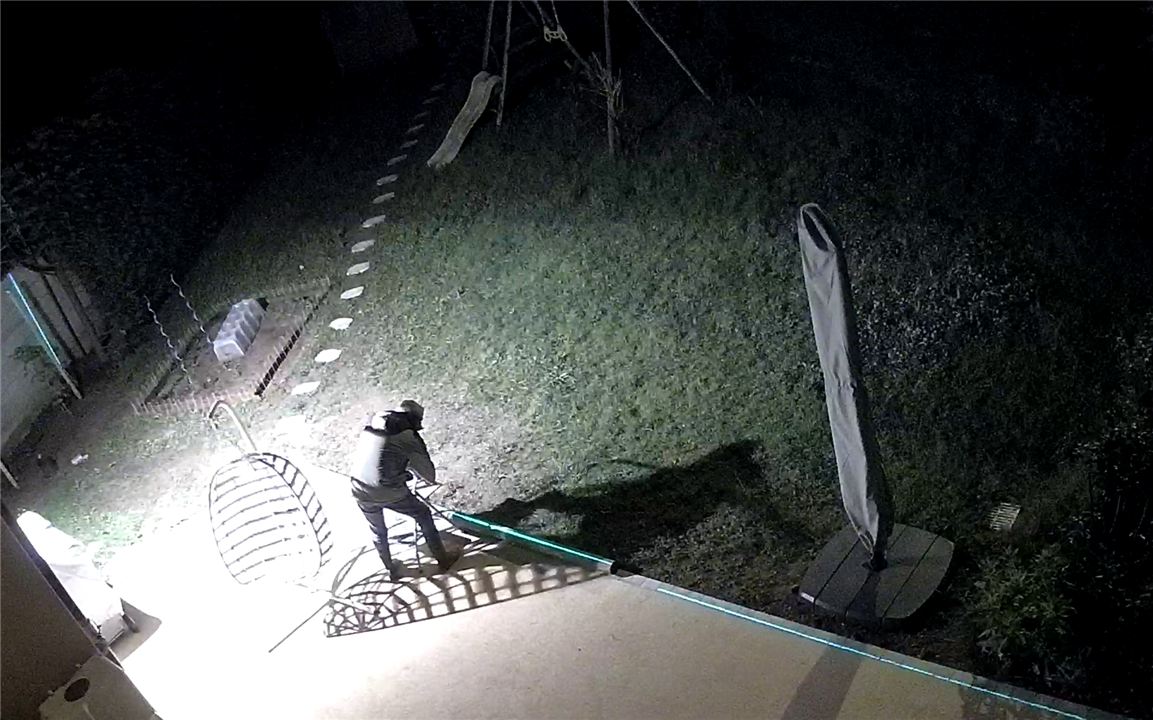

With all this decided, and with a bit of patience to get the various parts delivered or picked up, I worked in steps. The first one was to mark each beam with a line centered on the same side, and for this I used my 3-plane laser level. This had to be done at night because even if it’s using a green laser, it was not visible enough during the day.

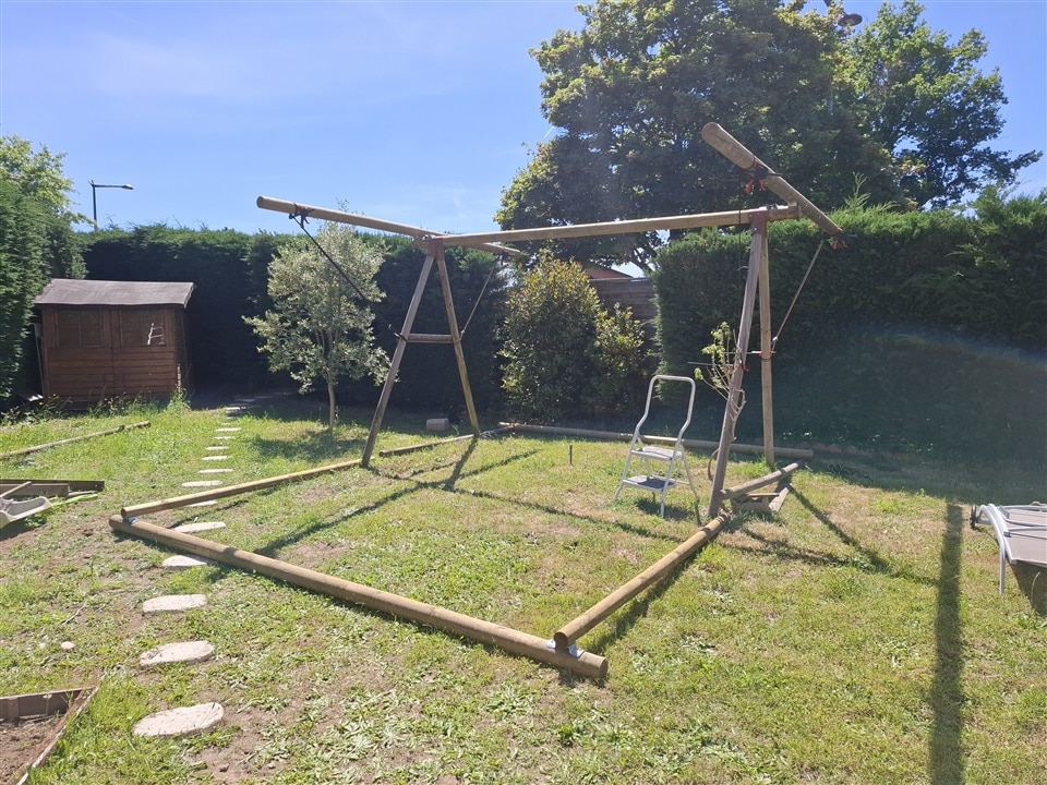

One thing that occurred during those times is that the top beam was a bit too wide for the metal connectors. I mean, they both are supposed to be 10cm diameter, but somehow one side would not fit through. This was solved by generously applying “tractor grease” (lithium grease leftovers from the auto repair shop) to both the beam extremity and the metal connector inside, helping everything to slide in.
