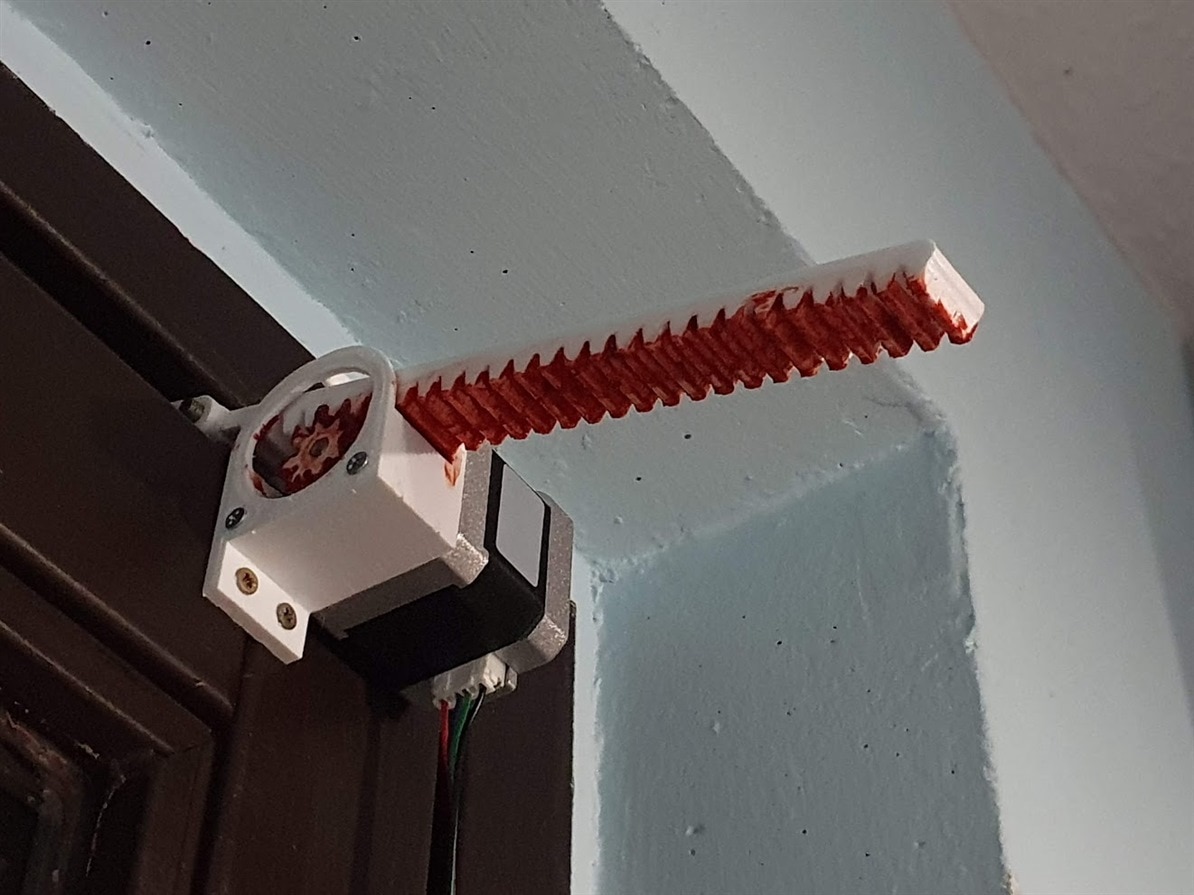

The original prototype
This is the version I started with 4 years ago. The mechanism was crude but technically worked.
The rack gear was kept in place, pushed into the stepper’s gear, with a simple plastic post. This gave enough slack that even with terrible alignment and a bad design, the mechanism worked okay.
The first problem is obvious from the video: it’s loud. Mainly the stepper, but two other things as well: when the stepper engages/disengages, there’s a loud click, and also the entire mechanism makes a rubbing noise (probably the flat top of the rack gear against the post).

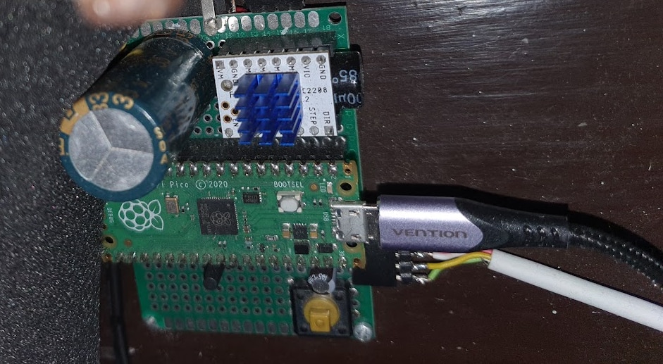

The first upgrade was swapping the DRV8825 I used for a TMC2208, which has something called StealthChop. It’s basically motor control magic that makes steppers silent.
(apologies for the terrible picture, I didn’t know yet that this was going to end up as a project on Element14, so I didn’t take any decent pictures).
As the image shows, a Raspberry Pi Pico and the TMC2208 stepper driver are the main components. The yellow button manually opens and closes the window. 24V comes in at the top (cut off), and there’s a white cable carrying I2C, for sensors.
The TMC2208 fixed the stepper noise issue. The next goal was to fix the rubbing noise.

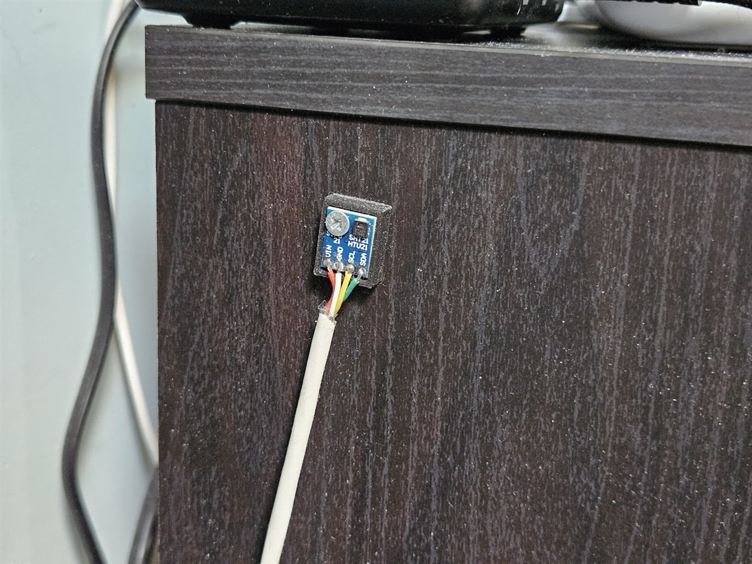

At minimum, two temperature sensors were needed, one outside, one inside. The former one was needed so the window wouldn’t be opened when it’s hotter outside than inside.
The inside temperature sensor ended up being an HTU21 temperature/humidity I2C module, mounted on my bedside table.

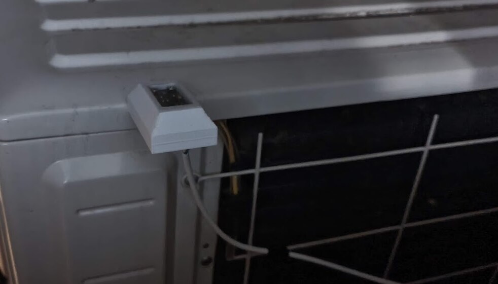

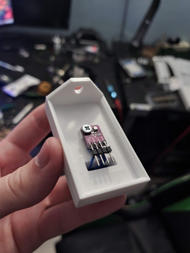

For the outside sensor, something a bit more complex was needed. I didn’t have a rain-protected spot to put it in, so I had to make some enclosure for it.

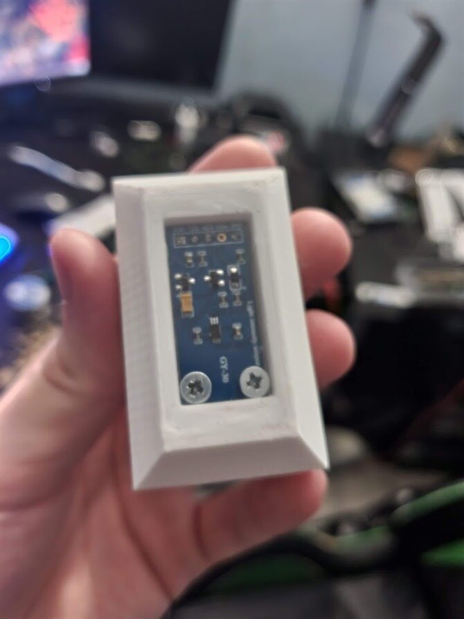

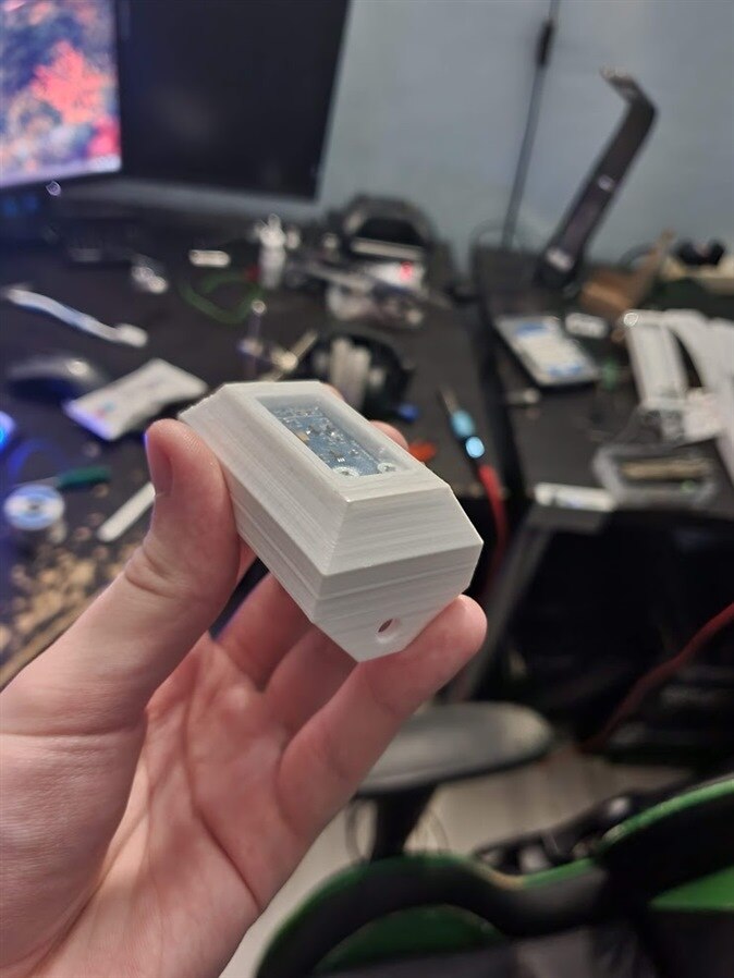

While I was browsing for temperature sensor modules, I found an I2C light sensor, along with the BME280 temperature/humidity/pressure sensor that I got, so the enclosure had to accommodate that too.
I glued a transparent piece of plastic to the top, so light could still reach the BH1750 sensor, but water couldn’t. The BME280 sensor was placed at the bottom, where it is also protected, but doesn’t get stuck in hot/cold air pockets.

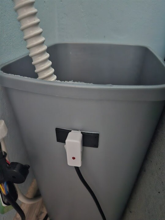

I mounted this assembly on the back of my AC’s outdoor unit, where it also benefits from the active airflow of the AC fan in the summer (the backside is the intake, so the warm air from the AC cannot influence readings).

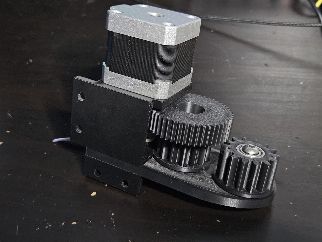

The first part was achieved by adding a massive gear reduction. This was by far the biggest upgrade in this entire project, because it solves a bunch of issues at once:
  • Active braking becomes viable: instead of needing 10W+ to hold the motor stationary, we only need a fraction of that.
  • Sensorless homing becomes viable: the stepper can now spin fast enough for StallGuard to work, which is a feature in some Trinamic stepper drivers, to detect stalls/skipped steps. This means we can properly home the stepper on boot, instead of relying on the potentially faulty assumption that the window is always closed on boot.
  • Effective torque increases immensely, and the window can be actuated slower, for less noise
The second part was achieved by adding a magnet to the shaft of the stepper motor, and mounting an AS5600 magnetic rotary encoder sensor next to it. This sensor can measure the exact rotational angle of a magnet positioned a few millimeters above it.
I also wanted to get rid of the crude plastic post that holds the rack gear pushed into the stepper motor’s gear. The best way I could think of was to make the rack gear ‘double sided’, and sandwich it between two gears, one driven by a stepper (and the gear reduction), the other freewheeling.
The rack gear got a curvature matching the path of the top edge of the window, so it wouldn’t have to constantly pivot on its mounting screw, and change its angle between the two gears.

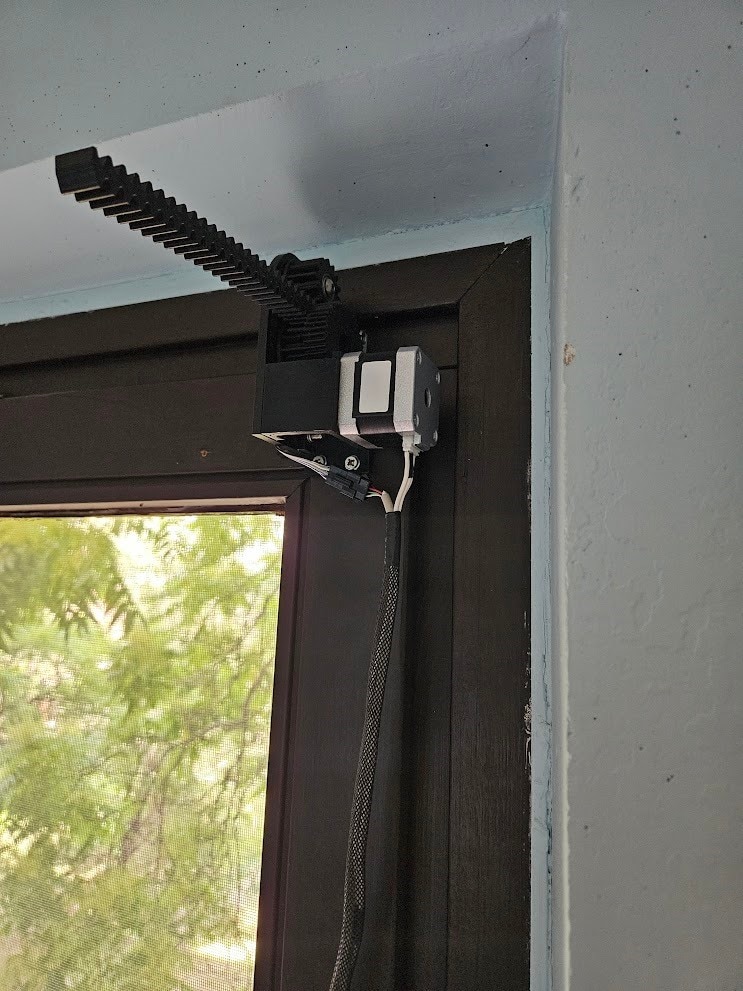

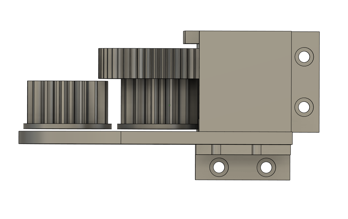

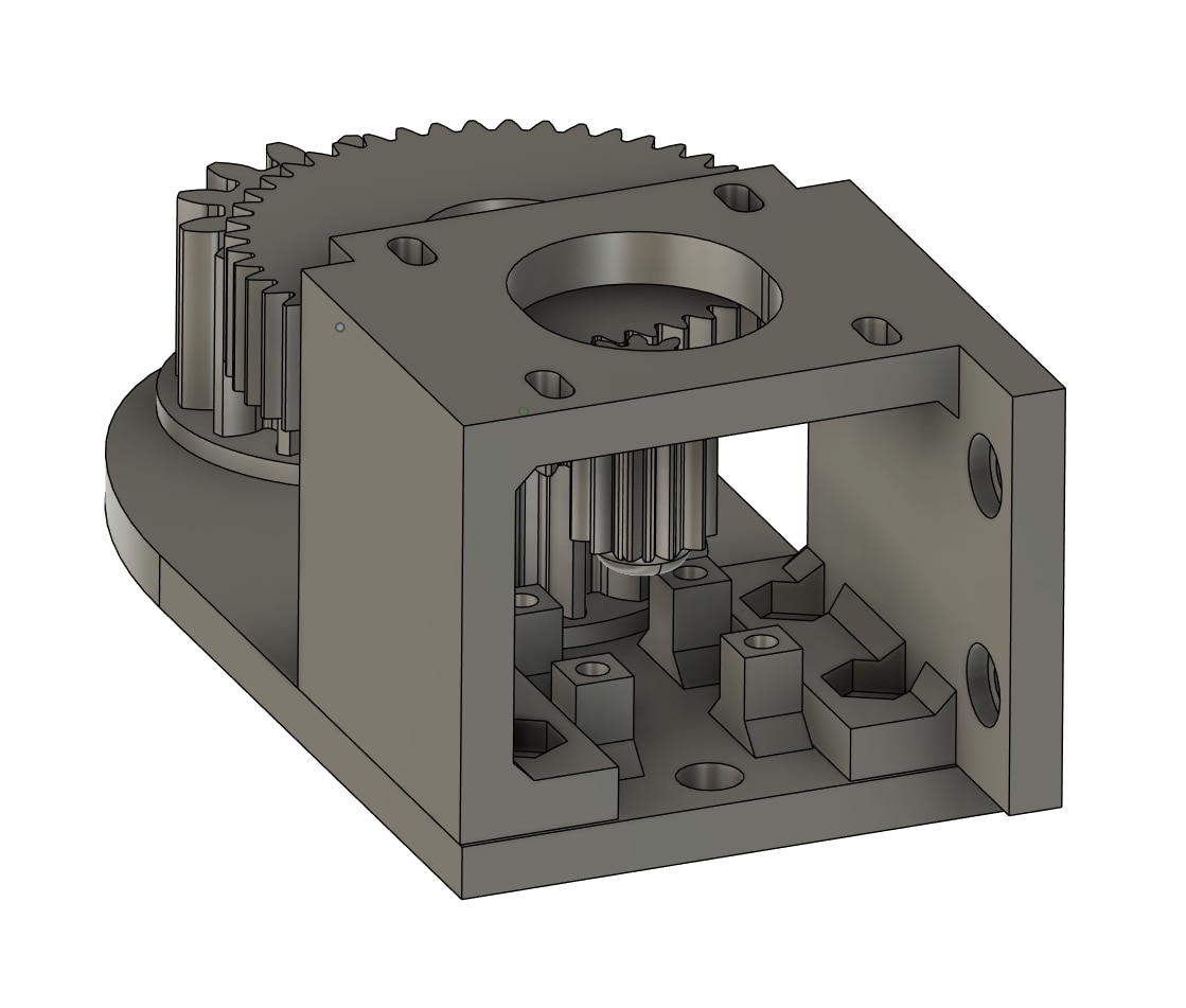

Here's the final design of the mechanism:
The four square posts under the smallest gear(or above it, in the next picture) hold the AS5600 magnetic encoder module, and the gear has a small slot for a magnet:
I 3D printed the rack gear from PETG, to make it a bit more flexible. The two large gears that sandwich the rack are PLA, and the small stepper gear is PETG too.
The two gears have slots for two bearings each, and an M5 bolt secures them to the baseplate.
And here’s the end result, mounted on the window:

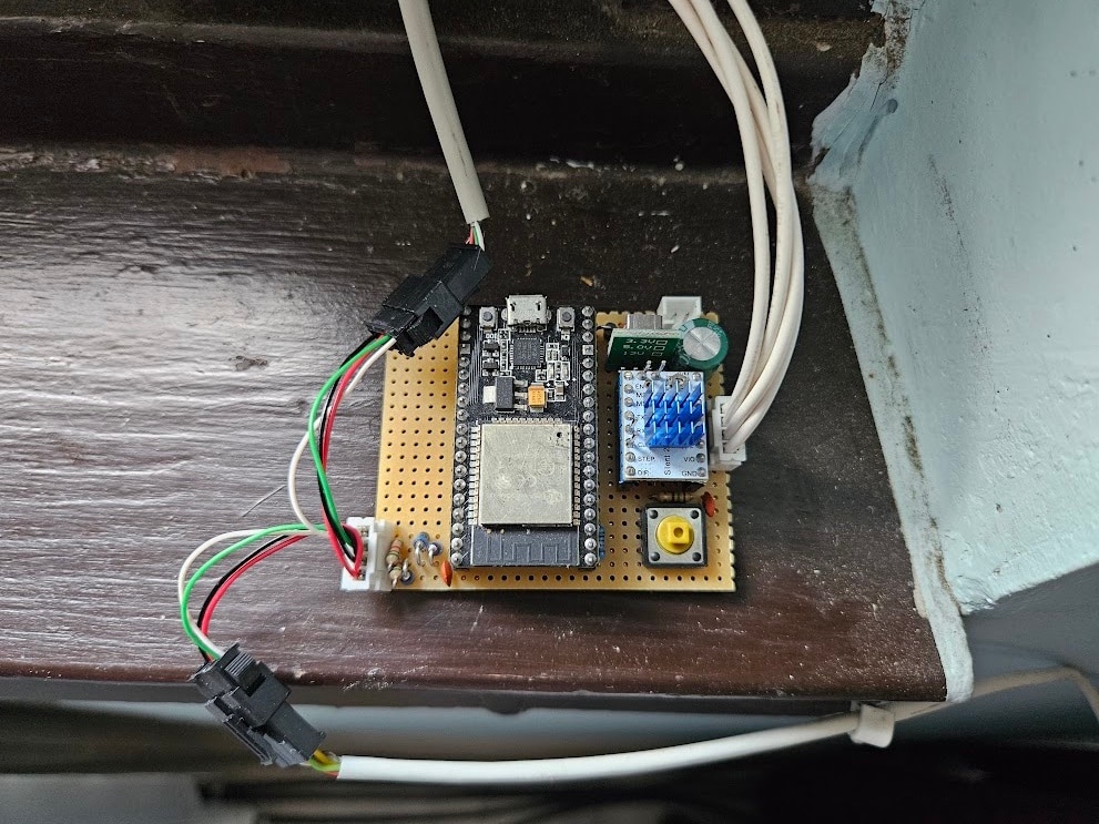

The Pi Pico + Linux setup from the previous version was a mess. It was clear that the microcontroller should handle everything by itself. I had an ESP32 lying around, and bought a TMC2209 stepper driver to go along with it.
The TMC2209 driver upgrade was needed for StallGuard, which is the feature that lets us do sensorless homing. Instead of assuming that the window is closed on boot, the driver carefully ‘bumps’ into the window frame on boot, to detect where the closed position is.
The sensors remained the same, I didn’t face any issues with them four years ago.
The new PCB is nothing fancy, I didn’t even make a schematic for it. I plan on making a nicer, custom PCB for it later, but for now, this is perfectly fine. I didn't make an enclosure for it yet, as I don't want to remake it each time I change something.
24V goes in at the top right, on the unplugged 2-pin JST-XH connector. This directly powers the TMC2209, and also goes into a small buck converter, to power the ESP32.
The bottom left has a 4-pin JST-XH connector for I2C, which goes into a splitter, that creates two JST-SM connectors. One goes to the magnetic rotary encoder sensor, the other goes to the various environmental sensors.

  • vmate
    vmate 5 months ago in reply to afernandez
    You're welcome! A few more things I forgot:
    You'll need 6x M5 nuts, ideally locknuts, the ones with the plastic insert thing, so they don't come loose on their own.
    4x  M5x12 or longer screws are needed to hold the baseplate and stepper bracket together, along with 4 of the 6 nuts.
    2x  M5x30 or longer screws are needed to hold the two large gears to the baseplate, along with the remaining two nuts.
    4x  625 bearings are needed for the two large gears total, meaning 16mm outer diameter, 5mm inner.
    For mounting the stepper motor itself, M3x8 screws are needed, you can probably get away with M3x6, but longer than M3x8 might not work.
    The AS5600 module is probably not worth the hassle initially, see if active braking can hold just fine without it. If you want them later, M3x18 or longer screws, and M3 nuts are used to mount it. (technically M3x16 might just barely work out, but it will only thread about a single mm into the nuts). M2.5 is also an option. The magnet needed for the stepper gear is a 4x2mm (D x L) neodymium circular magnet, but they are usually supplied with AS5600 modules.
  • afernandez
    afernandez 5 months ago in reply to vmate
    Thanks you so much!!!! I will try to use it as a base of my window automation!
    I will sent you my window automation result! Slight smile
    And for finaly thanks you again for the help!!!!!
  • vmate
    Thanks! Absolutely, here it is:
    WindowActuator.zip
    The .3mf file should have all the objects, but you'll have to manually orient them, and don't print all at once ideally.
    These are the print orientations:
    You will need supports for the two large gears, and the big bracket the stepper motor mounts to (the thing in the top right), and possibly the L bracket, left of the stepper motor bracket.
    PETG is recommended for the rack gear, so it can flex, and something non-flexible(PLA is okay) is recommended for the big baseplate, so it doesn't flex. The other parts are probably fine with anything, although apparently it's preferred to have dissimilar materials for gears like this, so I printed the two large gears from PLA, and the small stepper motor gear from PETG.
    The stepper motor gear is interference fit, so you'll have to dial in your vertical hole expansion setting perfectly, or just print like 6 of them at once with slightly different expansion each, and one of them will fit.
