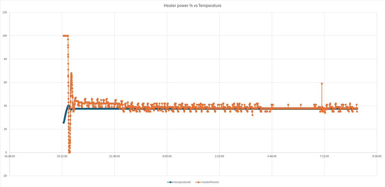

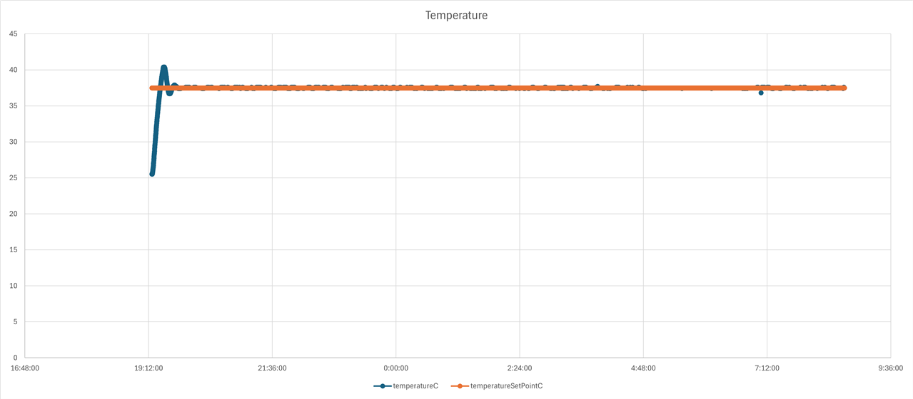

So this time, the first major improvement I made was temperature control.
pid_temperature_test
The original incubator behaved more like a basic thermostat, and even though this type of control can work, it often produces larger oscillations because the heater is simply switched on or off based on the measured temperature and, as I said, that’s not desired.
PID
I wanted something smoother, so I implemented a PID controller that calculates the heater output based on the difference between the target and the measured temperatures. Instead of just turning it fully on or off, the PID output value is converted into a PWM duty cycle.
temperature graph
The graph above shows how the system maintains the temperature close to the configured setpoint (37.5C). This improvement might sound silly and a little basic, but it is actually one of the most critical parts of the project, and even though I don’t have data to show from the “before”, I can assure you the difference is brutal. The code below shows the simple PID implementation used to calculate the PWM duty cycle.

One detail that I had to fix while tuning the PID was the integral term. The incubator does not reach the target temperature instantly, so if the error is accumulated without any limit, the integral part can grow too much during the warm-up phase. Then, when the temperature finally gets close to the setpoint, the controller may still think it needs a lot of power and push the heater harder than it should. In other words: a perfect recipe for turning a smart incubator into a very small egg cooker. To avoid that, I limited the accumulated integral error, which prevents integral windup and keeps the PID response under control even when the system takes some time to reach the desired temperature.

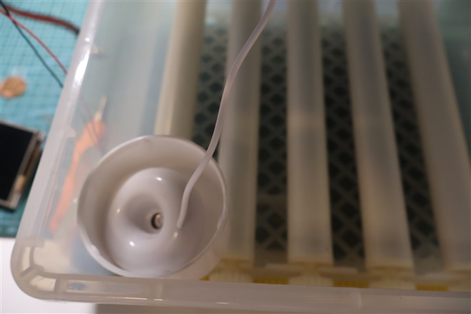

The next point I wanted to touch on was humidity control.
Since the incubator originally only showed the humidity value but didn’t have any system to control it, I decided to add a water atomizer so it can go off when the enclosure starts to get dry.

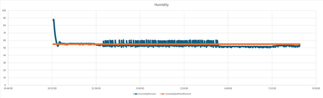

The system reads the humidity sensor value and activates the atomizer when humidity drops below the configured threshold. For this part, a hysteresis-based control strategy is good enough. There’s no need to overkill it.
I also added a small water tank that allows me to refill the water for the atomizer whenever needed without opening the incubator, and the tube is placed in a smart way so we always know the water level from outside.

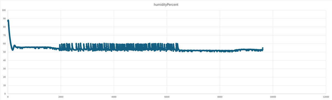

This was a very interesting part of this project because humidity behaves differently from temperature. The response when the atomizer goes off is not instant, and other factors like the physical placement of the atomizer, the kind of water, the airflow, and the position of the sensor can greatly affect how the system behaves.

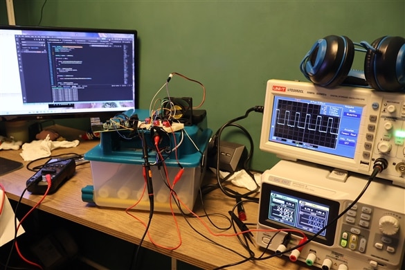

All these new parts of the incubator wouldn’t work as they should without a proper electronic interface. I’m using a Raspberry Pi as the brain of this project, but the board shouldn’t directly power the heater, the motor, or the atomizer since its GPIO pins are only meant to provide control signals. To handle all the switching, I designed a small PCB that uses transistor-based stages to control the different loads from the Raspberry Pi GPIOs. This is safer for the Raspi, cleaner than a breadboard full of wires, and also easier to debug, maintain, and make more reliable in the long term when I give the incubator back to my mother.
This schematic shows the different transistor stages used to control each actuator.

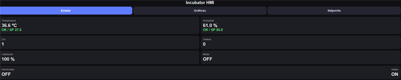

I could have left the project here since the incubator was already handling the temperature and humidity better and automatically turning the eggs. But then I thought, why stop here when I can do the obvious thing and start monitoring this remotely instead of having to check with my eyeballs every day or every few days how the process is going? So I added an interface that shows the current state of the system.
This was totally not necessary, but it made it so much easier to supervise how the incubation process is going, and it also helped a lot during the testing phase because I was able to detect errors at any moment. Observability might not be critical, but it sure makes a difference.

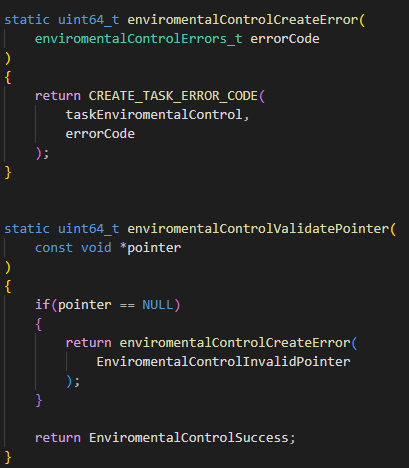

One small detail that made the project much easier to debug was the error encoding system. Instead of returning simple true or false values, each module can return an encoded error that identifies both the origin of the problem and the specific reason why it happened.
In a project like this, where the temperature sensor, humidity control, GPIOs, PWM output and task logic all interact with each other, this helped a lot. When something failed, I could quickly know whether the issue came from a missing initialization, an invalid pointer, a GPIO problem or another specific part of the system.

Sadly, I don’t have any fertilized eggs nor time to wait for a chick to be born, because that would for sure make a statement, but these graphs were really useful for validating the behavior of the system and being able to say the improvements were a success, not only at one instant but over time.

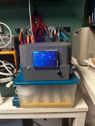

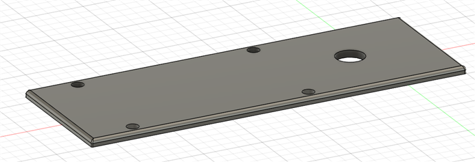

Finally I print a case cover with my ender 3 to protect all of the cables and boards.
I have an spi touch screen from old project and I decided to added it to monitor and control the incubator.

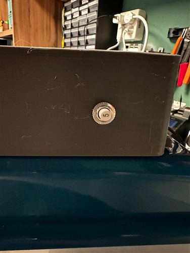

I also added a 3W high intensity led to check if eggs are fertilized with a push button  for the activation.
To improve safety and protect the whole system, I added a 5A circuit breaker to prevent potential short circuits that could harm the chickens or damage the electronics Disappointed.
