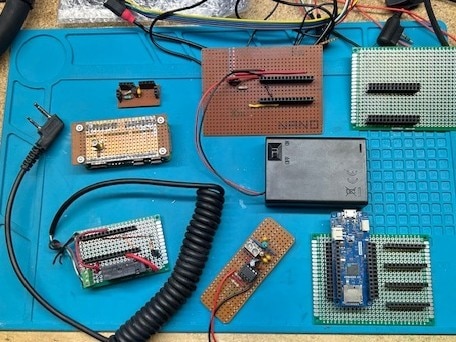

While looking for an HDMI to mini-HDMI cable that I just knew that I had... I came across a plethora of protoboards that I had used for other projects.  Some of them I even remembered what the project was.  In the spirit of Spring Clean, I asked myself "What are you really going to do with these?" - like the six Pi Pico bases with voltage divider resistors and NRF24L01+ hook-ups that I used for Experimenting with Thermistors.
image   These are just a few.
I decided - again, in the spirit of Spring Clean - that I could "sacrifice" some of them for a dedicated purpose device.  It would be whatever it was - until it stopped working.  I could even "sacrifice" a microcontroller - as I looked at my Digistump Oaks and Particle Xenons that I didn't use while they were still supported and now may never find a purpose in life.

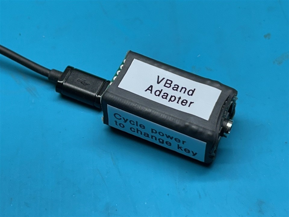

So... I cut the protoboard to the reduced size.  I cut the Pico after GPIO11 and tested it.  It still worked.  I installed a 1/8" stereo jack between the female headers on the protoboard and connected the jack to GPIO9 and GPIO 22 - because they were the closest pins.  I also connected GND.  Now I just needed to program the Pico.
EVERYTHING that I found online was over-engineered.  I just want simple.  "Simple" was not to be found - so I had to make it.  Arduino IDE and the keyboard library.
Easy enough, right?
Until I plugged the mono plug for the straight (traditional Morse Code) key in instead of the stereo plug for the paddle.  Dooh!  Constant "Send".     Think.  Think.  Think.
The solution for me was to look for that "send" connection during boot and, if it was there, assume that a mono plug was in the jack instead of a stereo plug and treat the input as a traditional straight key.  I would call the logic pseudo State Machine in that the program either looks at one or both inputs based on the state of the inputs at boot.  If one of the inputs is grounded at boot, the program doesn't look at that input again - until the adapter is power cycled.

I then wrapped the Pico and board in heat shrink tubing.  Freeing the BOOLSEL button and trying to make the LED_BUILTIN visible went horribly bad - so they don't exist any more - but the Pico still works.
SO... while there was no vision to create this adapter, I did use a couple of components that were languishing in parts bins and created something that I have actually used.  I'm still terrible at sending Morse Code, but I'm improving slowly.  I'm relearning Arduino coding AND... I actually did find that HDMI cable.  It's longer than I remember. Frowning2
