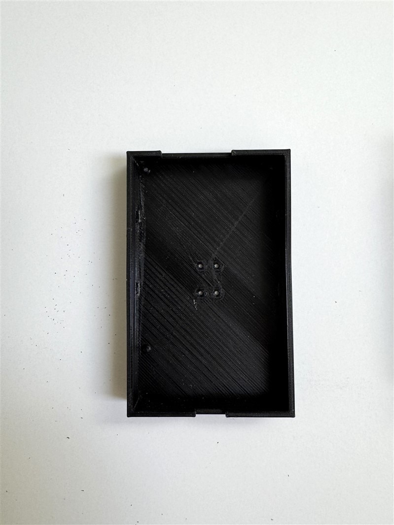

Here is the 3D printed case - the LEDs are not installed:

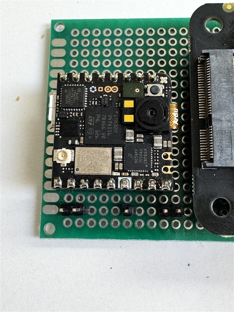

And the boards mounted on female headers on a protoboard.  The NoteCard is mounted on a NoteCarrier-B (no longer available) and the Nicla Vision is above.  The dual antenna is for cellular and GPS.

The bottom of the case has some mounting holes for adapter mounts and some clips on the sides to retain the protoboard:
A closeup of the Nicla Vision showing male headers that I added for test points and the last 2 on the right jumper the power together when running on battery - I need to add header pins for the LEDs and pushbutton:

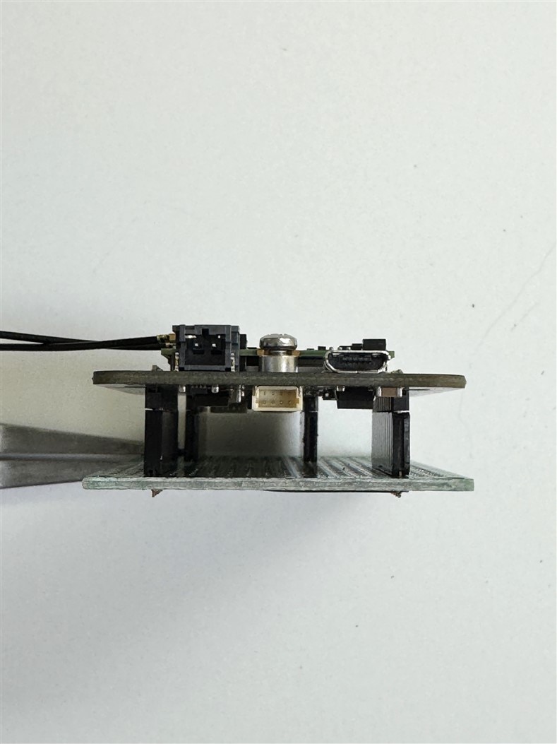

And finally a side view under the NoteCarrier where there is space for a LiPo battery -the battery connector is on top to the left:
