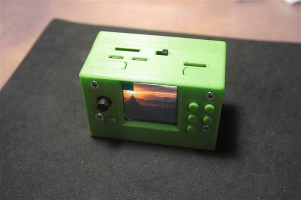

     I wanted to assemble a full-fledged mini camera that will work from a battery, capable of recording video with sound and playing it back, and which will have a display and buttons for convenient control. And all this should fit into a small case and be conveniently assembled and disassembled. I chose several modules that I want to place in the case and which were easily accessible to me.
  • Raspberry Pi 1.54inch mini LCD touchscreen;
  • Raspberry Pi Camera Rev 1.3;
  • Microphone INMP441 MEMS;
  • TP4056 charging module;
  • Module step-up voltage from 3.7v to 5v.
  • Audio module PAM8403;

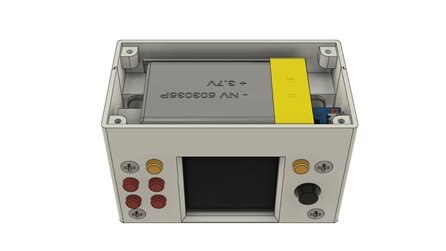

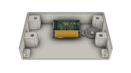

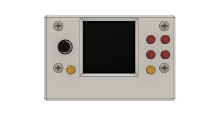

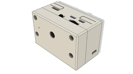

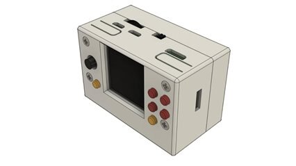

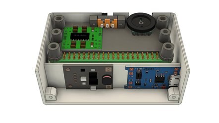

3. Design

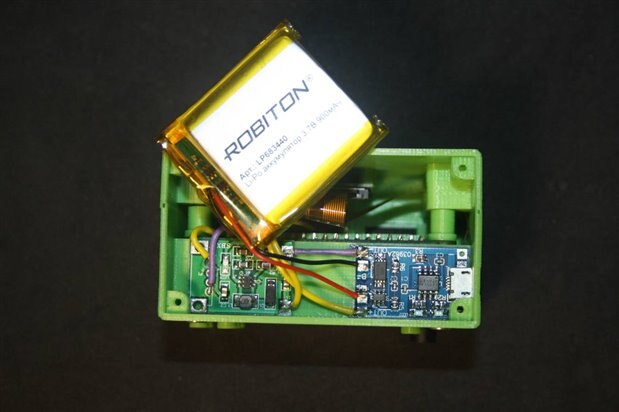

     I tried to arrange the modules and design the case so that all the buttons and USB holes are at the top or side. I placed the battery and charging modules with a voltage converter on the bottom so that it would be convenient to install them inside. The niche for the battery is closed with a separate lid, so you will not need to completely disassemble the case in order to change it, moreover, this niche will allow you to install a large battery.

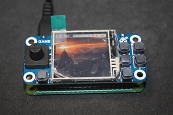

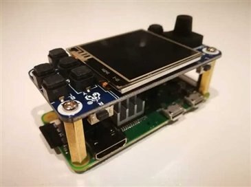

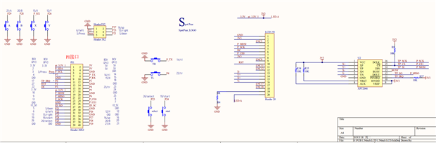

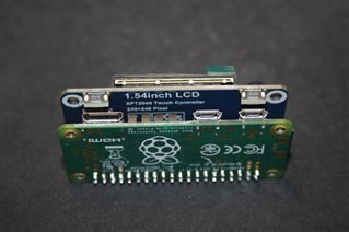

Display module

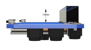

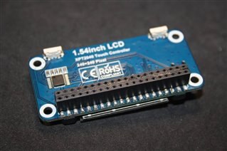

     I found such an interesting module with a display and buttons for the Raspberry Pi Zero. It has a 1.54-inch color touchscreen display with a resolution of 480x480, eight buttons and one joystick. The display and sensor work very well, even the smallest letters are readable. Therefore, I will use it for the project.
Very long pins were soldered on this module and the distance between the boards is 2 cm. This option did not suit me very much because I plan to make a compact device. Therefore, I had to unsolder them.
     It is best to use PH3.5 2x20P surface mount pins. But I didn’t have these in stock and it took a long time to wait for delivery. Therefore, it was decided to take the usual classic Arduino single-row PH8.5 pins, glue them together, grind them with a file on top of 1.5 mm and bend the legs at 90 degrees. And I got a pin height of 7.5 mm. And I got a pin height of 7.5 mm and a distance between the boards 1 cm. This distance is enough for a cooling radiator if you have to use a Raspberry Pi Zero 2 that heats up as much as 75 degrees.
Pinout of the module.

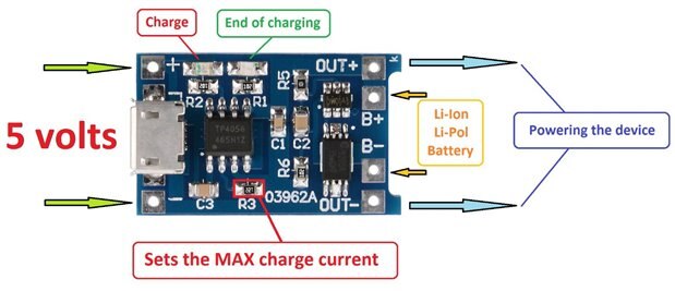

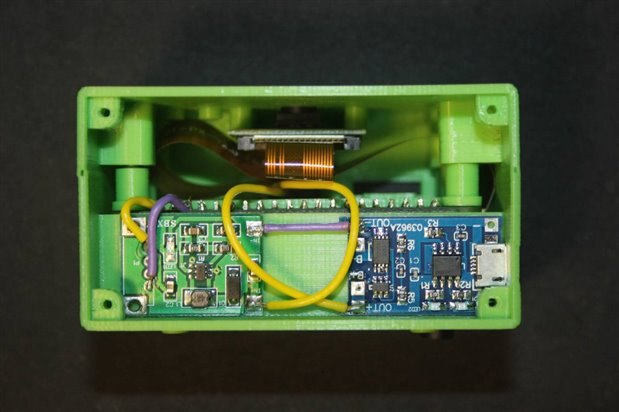

     To charge the battery, I decided to take such a module.
     The module is based on the TP4056 chip, a 3.7V Li-Ion and Li-Po battery charging controller with built-in temperature sensor, it is a complete product with constant voltage / constant current linear charging for single cell lithium-ion batteries.The controller is made in the SOP-8 package, has a metal heat collector on the bottom surface that is not connected to the contacts, allows charging the battery with a current of up to 1000 mA (depending on the current-setting resistor on the board, it is designated R3).
Resistor (kΩ) R3Charge current (mA)
3050
2070
10130
5250
4300
3400
2580
1.66690
1.5780
1.33900
1.21000
     TP4056 automatically completes the charging cycle when the voltage on it reaches 4.2V and the charge current drops to 1/10 of the programmed value. The module has an indication of the charging process. At the moment of charging, the red LED lights up, and when the battery is fully charged, the green LED lights up, the red one turns off. In addition to the TP4056 charging controller, two chips DW01 (protection circuit) and ML8205A (double MOSFET key) are added to the board, they serve to protect the battery from overdischarge, overcharge, overload and short circuit.

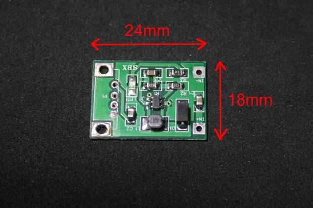

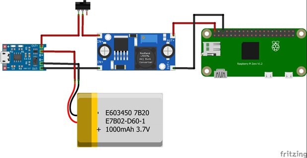

DC-DC module
I used a 3.7v to 5v step-up module. Unfortunately, I did not find any description either for this module or for the F1A9 microcircuit that is installed on it. Module dimensions 24x18mm.
5. Connection

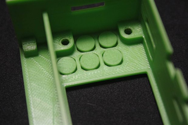

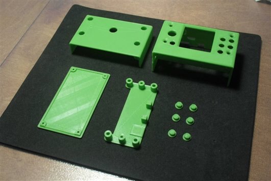

6. 3D Print
Attention. This case is the first trial version in which errors may be present and which will allow me to correct all gaps and holes. Therefore, if you want to print it, consider this.
     I was printing parts with an Ender3 printer. The upper and lower parts of the case and the battery cover were printed with a layer height of 0.2 using supports and with a filling of 20%. The inner part of the case where the on / off button is attached is also only without supports. The buttons were printed with a layer height of 0.1 and 100% infill.

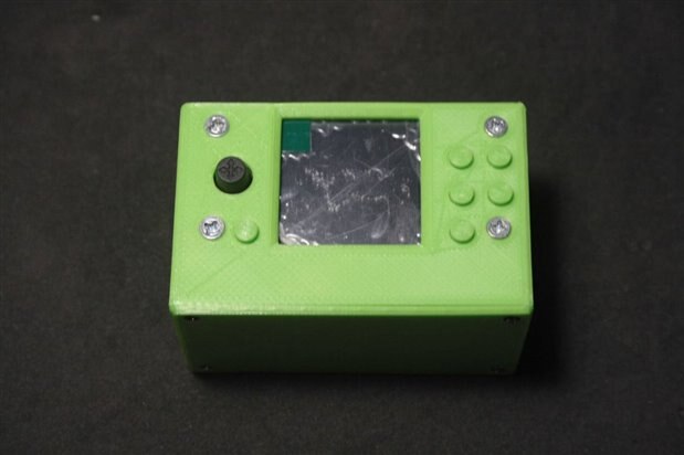

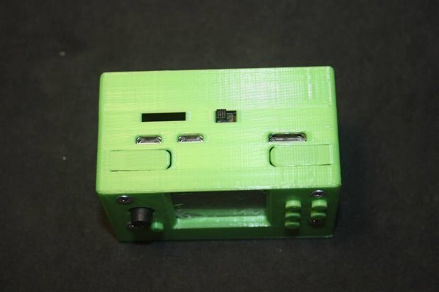

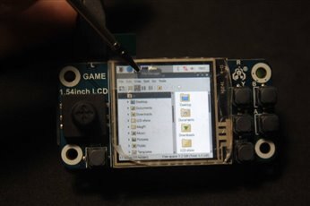

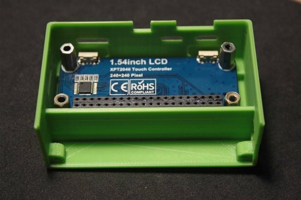

1. Before assembling and slightly processed the edges of the buttons with sandpaper so that they would slide better. Then we put the buttons in our holes.
2. We put the display module and fasten it with screws m3x12 and stands m3x10.

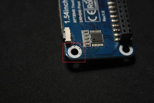

Attention. I found that this module has thin tracks next to the screw hole. Although the board is covered with a solder mask and painted. It seems to me that this is very risky, because if you tighten it tightly, if the rack rotates, you can scratch the board and damage the tracks. Therefore, it is better to use nylon stands or did I just glue a piece of tape and cut a hole in it.

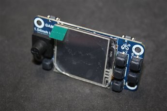

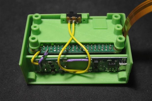

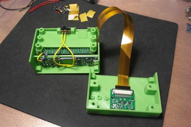

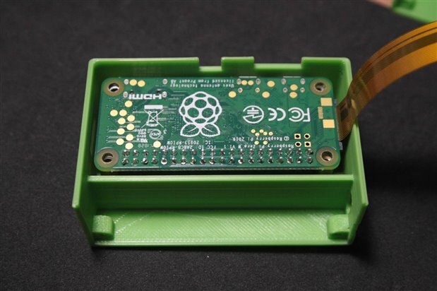

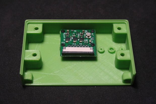

3. It is best to remove the memory card before installing the Raspberry Pi. We insert a 16cm long ribbon cable for the Raspberry Pi camera, bend it at 90 degrees and insert the module into the display.
5. I screwed the Camera module with four screws to the body and connected the ribbon cable.

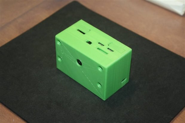

6. Then I bent the ribbon cable and twisted the two parts of the case with the m3x20 screws. To understand how best to bend the train, I cut off a piece of paper of the same size as the train and bent it. This helped me calculate the curves.

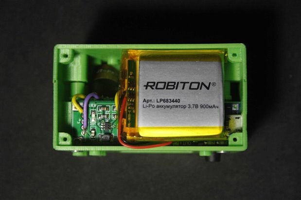

7. Soldered the battery and put it in its place. Closed the lid and screwed it down with four m2x7 screws.

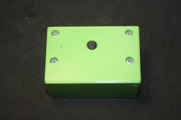

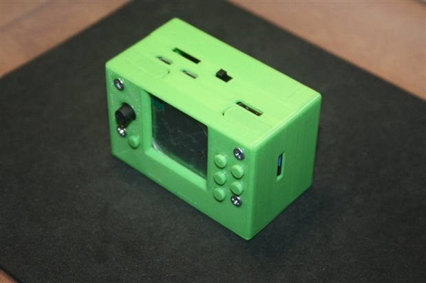

{gallery} MiniZeroCam
IMAGE TITLE: Front
IMAGE TITLE: Back
IMAGE TITLE: Front
IMAGE TITLE: Back
IMAGE TITLE: Up
IMAGE TITLE: Switching-on
