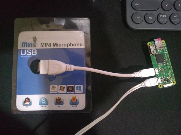

Here is part #1 of the build. I am setting up a Pi Zero W with a USB mic.

#3 Shutdown the Pi and connect the Mic to the Pi using a micro usb OTG cable, in my case I bought my Mic from Amazon.
#4 Now boot up the Pi and run the following command
lsusb -t
if the Pi has detected your USB mic, the output should similar to the below

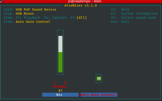

#4 Now you would have realized that the volume of recording is very low, now to adjust the volume use alsamixer
alsamixer -c 1
here 1 is the card number, and the use F6 to select the device , it should be something on the lines of "USB PnP Sound Device"
and then use F4 followed by the up arrow key on you keyboard to increase the volume
once done, record another audio wav file using the command below, and you should hear a good enough volume on the audio.
arecord -D plughw:1,0 -d 5 test2.wav
