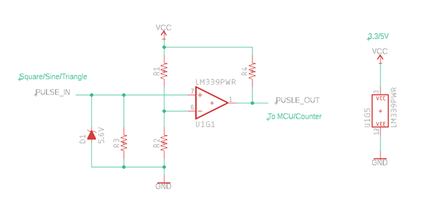

Arduino or any other controller need TTL signal levels at input to count pulses and only work with square wave.
So what if we want to find out the frequency of sine ,triangular or low voltage square wave?

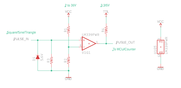

We can solve this problem with the help of comparator IC like lm339 which can operate down to 2V (Fig. 1) and also we can use separate power supply to power up the IC and use TTL voltage to pull up the output of comparator. (FIG. 2)
FIG. 1
FIG. 2

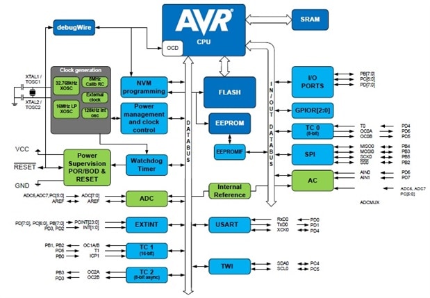

If we look at arduino UNO R3 specification we can find that it has 3 timers TMR0 (8-bit), TMR1 (16-bit) and TMR2 (8-bit) also shown in block diagram of ATmega 328P (FIG. 3). And Only TMR0 and TMR2 can be used as input.
TIMER Arduino IO - pin
TMR0 IO - 4 (INPUT)  IO - 5 & 6 (OUTPUT)
TMR1 IO - 5 & 8 (INPUT)  IO - 9 & 10 (OUTPUT)
TMR2 IO - 3 & 11 (OUTPUT)
We can use use either TMR0 or TMR1 as frequency Input. To choose the best option between these two timers we can opt TMR1 as input because it is 16-bit. And use other two timers in cascading to calculate elapsed time for better accuracy. (After editing TMR1 setting we cannot use millis and micro)
FIG. 3
