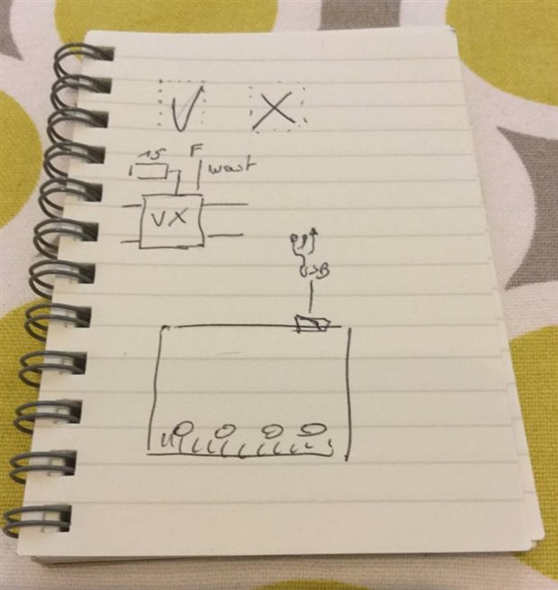

I received a micro:bit from element14. My first project is to turn it into a LabVIEW test device as a pass and fail indicator.
It will perform two functions:
  • display an image or image if a test passes or fails. A physical indicator for the test operator.
  • drive an output high if a test passes and another one if a test fails. This can be used to drive a buzzer or, in a full automatic setup, to push the failed device off the production line into a rework bin.
It's a project that fits the Project14 size. It should be easy to replicate. I add no hardware to the micro:bit.
I have never used this device and plan to program it in C or C++. I’ll blog the learning experience here.

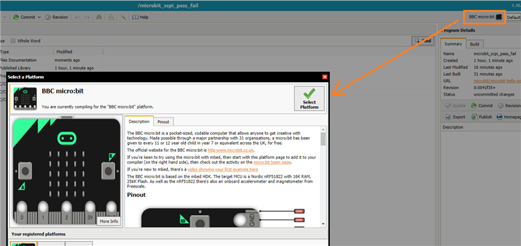

I'm using the Mbed web editor. I created an Mbed account, then added the BBC micro:bit as a board.
After that, I imported the Hello, world! example. It compiled without any difficulties and worked straight away when I loaded the firmware to the board.

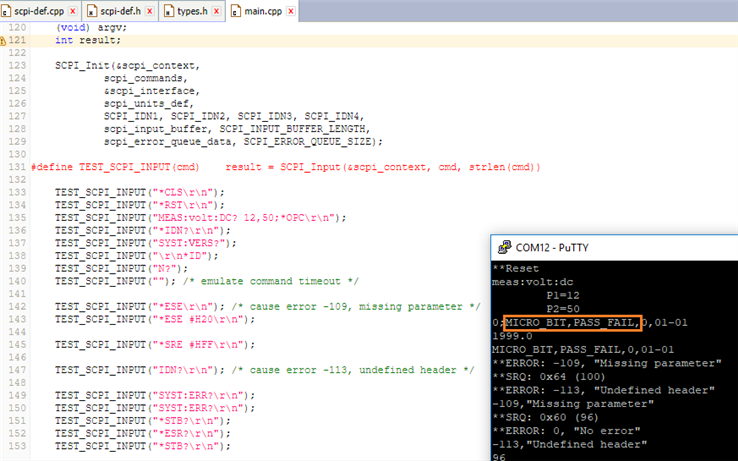

Once I did that - I simply copied the lib's parser testcase, it contains a definition for all necessary functions - all compiled well.
And it works. I attached a console to the USB port (speed: 115200) and could see the test result stream.
In the image above, you see MICRO_BIT and PASS_FAIL in the output.
Those are the values I programmed for the manufacturer and device name (the SCPI attributes for the *IDN? command).

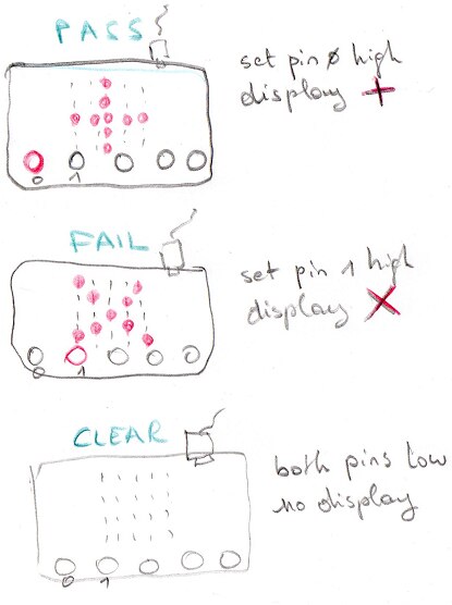

Figure: display and IO behaviour for all 3 states.

The final firmware version adds two output pins. Pin 0 on the micro:bit sets high on success. Pin 1 on failure status.
This requires little changes. In the main() function we set both pins to 0, just after initialising the board.
    // Initialise the micro:bit runtime.
    uBit.init();
    uBit.io.P0.setDigitalValue(0);
    uBit.io.P1.setDigitalValue(0);
Then, in the SCPI handler, based on the state, the appropriate pin is set:
        case SCPI_STATE_PASS:
            uBit.io.P0.setDigitalValue(1);
            break;
        case SCPI_STATE_FAIL:
            uBit.io.P1.setDigitalValue(1);
            break;
        case SCPI_STATE_CLEAR:
            break;

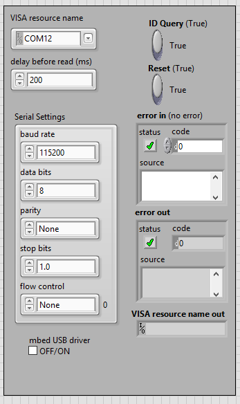

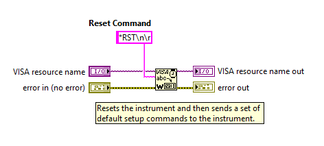

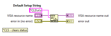

LabVIEW Driver

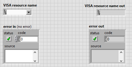

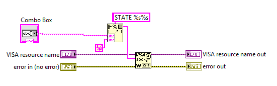

The driver library contains the necessary blocks to control the micro:bit and an example process. This is also attached at the end of this blog post.

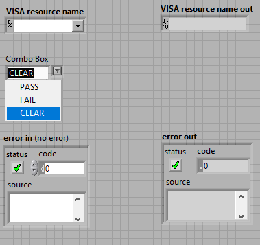

State Control block:

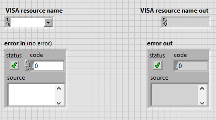

Initialize block:
Reset block:

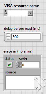

Default Setup block:
Close block:

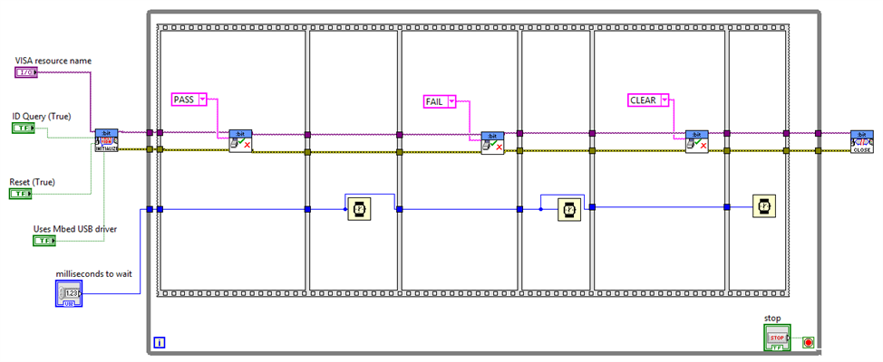

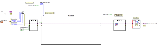

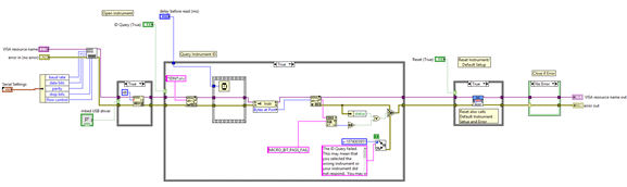

LabVIEW Example Process
I've used the simplest process that shows the micro:bit Pass / Fail device functions.
image: demo process runs through the three statuses of the micro:bit pass / fail device
Because it uses the driver's functional blocks, all is fairly easy.
It connects to the micro:bit over USB. Then it steps through PAS, FAIL and CLEAR status until you press the stop button. At the end the connection is closed and resources freed.
When you execute this flow, you can see the micro:bit LED matrix represent the statuses.
You can also measure the signals on pin 0 and 1 during the execution.

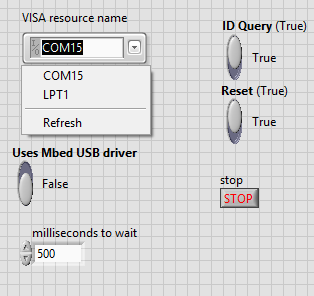

Before executing the process, select the COM port that's assigned to the micro:bit.
If you've installed the Mbed USB serial driver (Windows only, neccessary for Windows versions < 10), set the "Uses Mbed USB driver True. Else set this witch off.
You can see if the USB driver is the MBed one by opening the device manager, open the Ports node and check if the micro:bit entry says mbed serial.
If yes, you use the driver and youhave to flip the switch.
image: take care to select the COM port and USB driver of your micro:bit before starting.

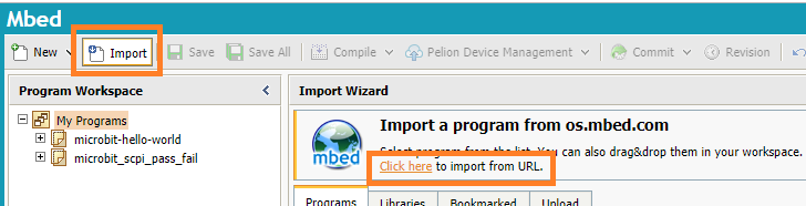

The source code can be imported and built by following these steps:

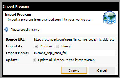

In Mbed, click import. Then click on the link to import from URL:
Enter https://os.mbed.com/users/jancumps/code/microbit_scpi_pass_fail/
Select these options:
After Import, you can select the project and press compile.
If all works OK, Mbed creates a hex file and places it in your Download folder.
If you drop that file on your micro:bit, it should be programmed as a Pass / Fail device.

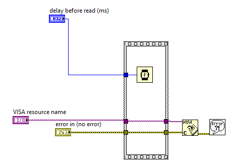

    Jan Cumps over 8 years ago in reply to Jan Cumps
    I had to make that buffer block conditional, because the device stopped working reliable with that block in place and the normal Windows 10 USB Serial driver:
    Enable it only when the Mbed serial driver is installed and active for your micro:bit. I'll upload a new LabVIEW archive with this functionality.

    Note on writing over serial to Mbed
    To prevent Error:-1073807298 (could not perform operation due to I/O error) when attempting to write to serial do the following.
    Insert a VISA Set I/O Buffer Size  just after configuring the COM port.
    Set the mask to 48 and the size to 4k or the maximum number of bytes you will ever need to read or write.
    The VISA set IO buffer is found under Instrumention I/O --> Serial --> VSet Buffer Size
    I have done what's explained above (see the red square in the process). I only had to set the mask. The buffer was 4K by default.

    Both link refer to same drivers but it tells how u can debug your code.
    Yup In lab view u need VISA drivers to use com ports.
