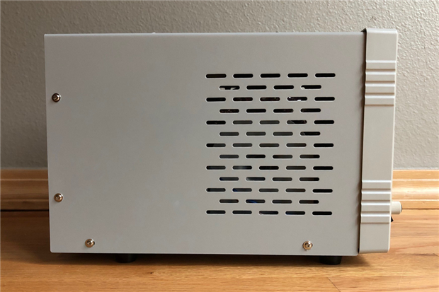

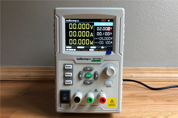

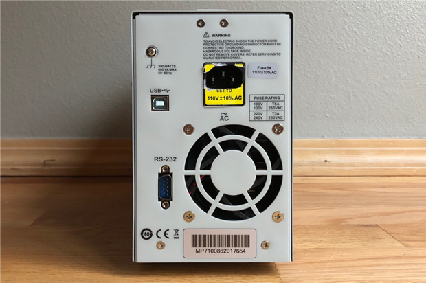

{gallery} Multicomp Pro MP270086
Front
Side
Back

InterfacesNoneUSB, RS232
External ControlNoneSCPI

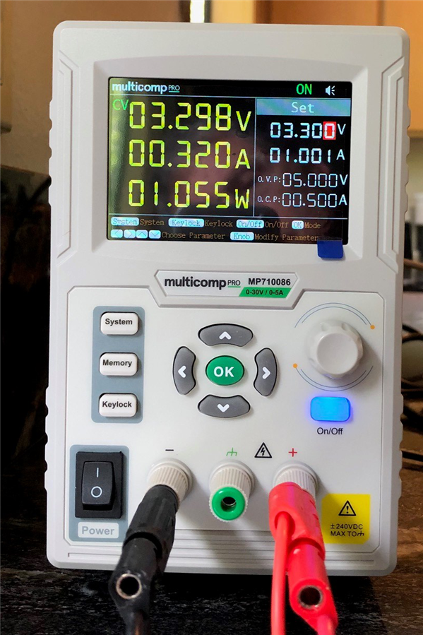

I find the input and navigation controls easier to use and more intuitive on the Multicomp Pro MP710086 and easier to use than the less expensive Tenma 72-2685 (although the Tenma user interface isn't that difficult to adjust to).  Both use encoders and are much easier to set accurately than power supplies with potentiometer input.
The system setup and storage / recall of settings is easy to use.  The addition of an on / off switch for the load and a keylock are useful upgrades. The unit also allows over-voltage and over-current protection to be set.
The primary display is well laid out and easy to read.

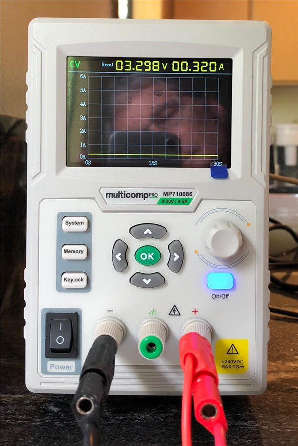

The secondary display has a graph which can show either voltage or current.  Unfortunately the scale is fixed and for the range of voltage and currents I use is of limited use.  The display below shows 320mA with the Y axis range 0A to 6A.
Overall I like the user experience and find the unit to be of good value.  The MP710086 is a good upgrade from the most basic power supplies on the market.  It lacks 4-wire, LAN, and numeric input found on instruments the next level up.

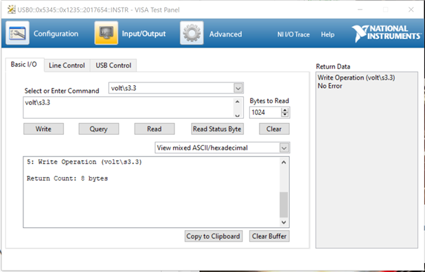

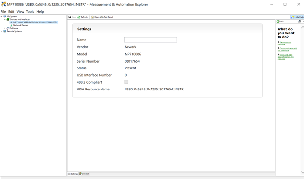

A driver was not required and the instrument showed up on National Instrument NI MAX as shown below:
The National Instruments Test Panel was used to test SCPI commands (use the "Open VISA Test Panel" button in NI MAX).  Setting the output voltage to 3.3V is shown below.
The documentation I prepared for my own use is given below.  Things seem to work but it has not been extensively tested. I've not been able to determine the SCPI commands (if they exist) for several of the features such as memory storage and system commands such as using the beeper.  Use at your own risk.

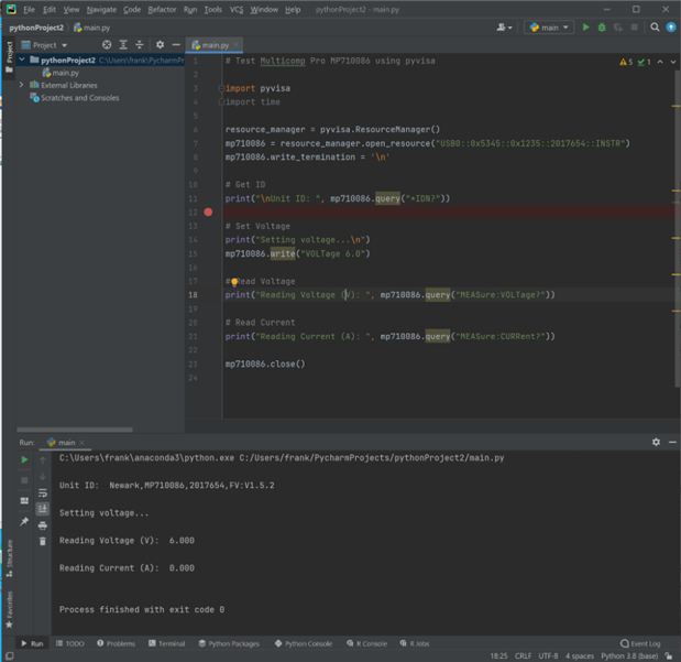

SCPI with pyvisa
Update 19 May 2021:  There is discussion in the comments below on using the unit with pyvisa with Gough Lui to the rescue again.  My test script is given below along with output using the PyCharm IDE.

Some Quick Tests
I have been using the unit for several months now and have experienced no problems in use.  Most use was with small motors in the several hundred mA range with voltages from 3V to 9V and up until now I'd not tested it at low voltages and currents.  To rectify this the test setup shown below was set up and a range of tests done starting at 1mA.

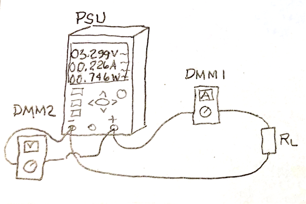

The unit was varied manually while supplying power to a nominal 10 ohm resistor with quite a bit of wire connections.  The voltage setting was recorded along with the voltage delivered as measured by the PSU and an Extech EX330 (DMM2).  The current setting was also recorded along with the current delivered as measured by the PSU and a Tenma 72-1020 (DMM1).  When the current setting controlled the output an asterisk (*) was placed in the PSU Setting (A) column.  When the voltage setting controlled the output the asterisk was placed in the PSU Setting (V) column.
Results are given in the table below.

I am very pleased with these results.  The current can be controlled to within 0.5mA right down to 1.0mA and the voltage is bang on from 1V up to 10V which is the range I normally work in.  These results are well within the specifications given in the datasheet.

  • wosipoff
    wosipoff over 4 years ago in reply to edax
    The default serial port speed is 115200 BAUD.  Have you tried that?  Also, use a line feed as a terminating character (ASCII decimal 10).
    Regards,
    Bill
  • phoenixcomm
    phoenixcomm over 5 years ago in reply to edax
    edax Sir most computers still have a DB-25 check to find out which pins on DB-9 are the same btw most USB-DB-9 cables do not have the hardware protocol adapter built in.
    As this is not as simple a connecting two wires to 2 connectors. RS-232 are +/- 12vdc, and that's just for starters, you also have different stop and start bits.
    you can buy a RS232 DB-9 to USB converter for less that 30$US
    Good Luck
    ~~ Cris
  • edax
    edax over 5 years ago in reply to fmilburn
    Hi Sir
    Thanks for your prompt reply.
    Need to conduct a full system check as per yours and Mr. Gough Lui kind advice.
    Thx ^ Br
  • fmilburn
    fmilburn over 5 years ago in reply to edax
    Hello Eddy,
    It has been a long time since I've used RS-232 and I don't even have cables anymore and can't give better advice than what Gough Lui gave above.  In particular, regarding his last bullet point:  Check the voltages on your USB-RS232 cable - some leads put out TTL (0 to 3.3V/5V) levels which is insufficient for some equipment that expect the full RS-232 (+/-12V) level. It may be that the power supply expects the full +/- 12V level.  Unfortunately, the manual doesn't say.
    Sorry, I am unable to help but I wish you good luck.
