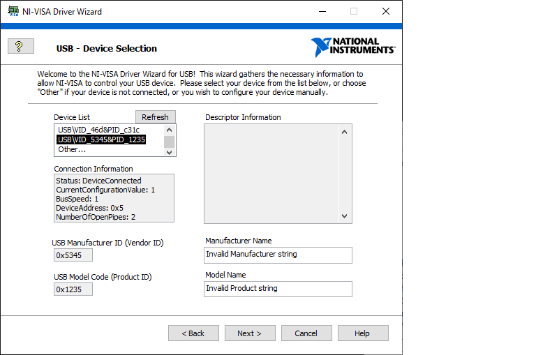

    Hi Good Afternoon
    FYI, I have checked my MP710086 with the NI-VISA Driver Wizard and below are the Error Snaphots:
    Hope we can troubleshoot together to resolve this problem.
    Thanks & Best Regards

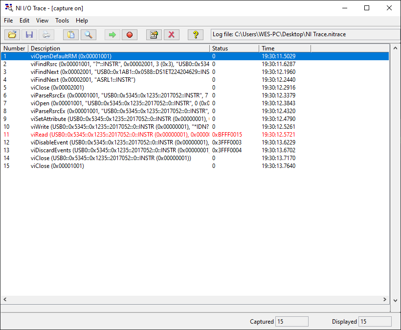

  • edax
    edax over 5 years ago
  • fmilburn
    fmilburn over 5 years ago in reply to edax
    Hi Eddy,
    It looks like it timed out and there was no communication. I haven’t tried PyVisa with mine yet.  Did you try NI-MAX like I did above?  Hopefully that would automatically identify the PSU and tell us it can communicate.

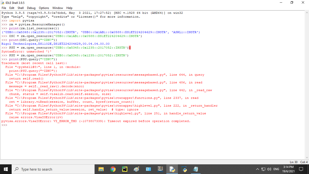

  • edax
    Hi All
    I am Eddy from George Town, Penang Malaysia.
    I had purchased a DC PSU the Multicomp Pro MP710086/87 30V/5A last month.
    The purpose was to program using python language and remotely control using its USB Interface.
    However, I seem to have errors using the Python 3.9.5 or the IDE PyCharm.
    The codes I had entered are the following:
    import pyvisa
    rm = pyvisa.ResourceManager()
    print(rm.list_resources())
    Here I am suppose to see resource address but I don't.
    However, since I know the address and entered as following:
    PSU = rm.open_resource('USB0::0x5345::0x1235::2017052::INSTR')
    print(PSU.query("*IDN?"))
    Now spills the error...
    Traceback (most recent call last):
      File "<stdin>", line 1, in <module>
      File "C:\Program Files\Python39\lib\site-packages\pyvisa\resources\messagebased.py", line 644, in query
        return self.read()
      File "C:\Program Files\Python39\lib\site-packages\pyvisa\resources\messagebased.py", line 486, in read
        message = self._read_raw().decode(enco)
      File "C:\Program Files\Python39\lib\site-packages\pyvisa\resources\messagebased.py", line 442, in _read_raw
        chunk, status = self.visalib.read(self.session, size)
      File "C:\Program Files\Python39\lib\site-packages\pyvisa\ctwrapper\functions.py", line 2337, in read
        ret = library.viRead(session, buffer, count, byref(return_count))
      File "C:\Program Files\Python39\lib\site-packages\pyvisa\ctwrapper\highlevel.py", line 222, in _return_handler
        return self.handle_return_value(session, ret_value)  # type: ignore
      File "C:\Program Files\Python39\lib\site-packages\pyvisa\highlevel.py", line 251, in handle_return_value
        raise errors.VisaIOError(rv)
    pyvisa.errors.VisaIOError: VI_ERROR_TMO (-1073807339): Timeout expired before operation completed.
    I can use the above python codes on my Digital Oscilloscope - RIGOL - DS1102E USB Interface and encounter no problems.
    I have tried using another pc too its the same error.
    Please assist.
