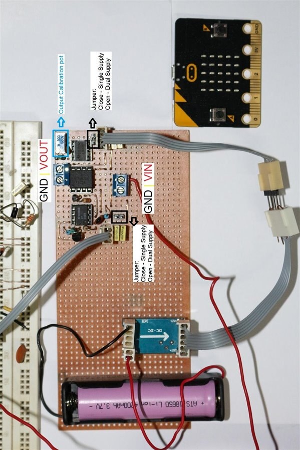

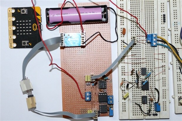

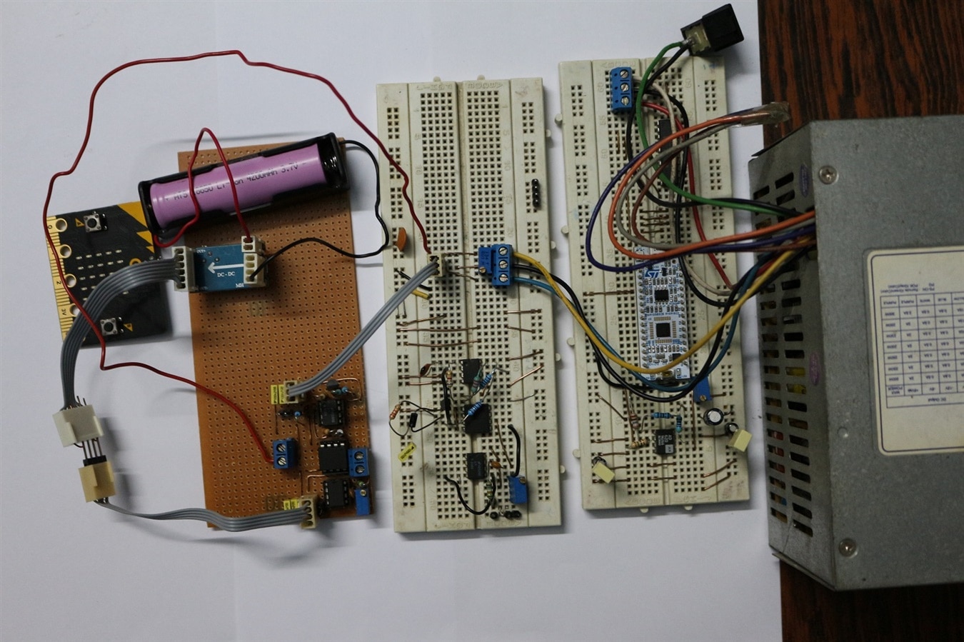

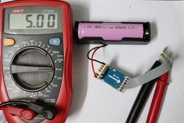

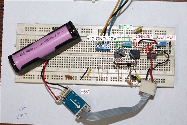

Hardware Setup:
{gallery} Analog Opto-Isolator Hardware
IMAGE TITLE: tinyMonster - Analog Precision opto-isolator - output stage power supply
IMAGE TITLE: tinyMonster - Analog Precision opto-isolator - Breadboard prototype
IMAGE TITLE: tinyMonster - Analog Precision opto-isolator - Final Strip Board prototype
IMAGE TITLE: tinyMonster - Analog Precision opto-isolator - Breadboard and Final prototype
IMAGE TITLE: tinyMonster - Analog Precision opto-isolator - prototype setup
