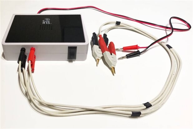

I have repurposed an old internet hub to house the meter.

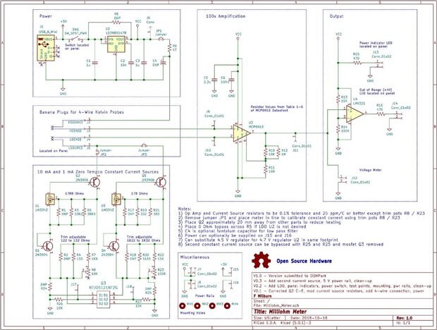

Schematic

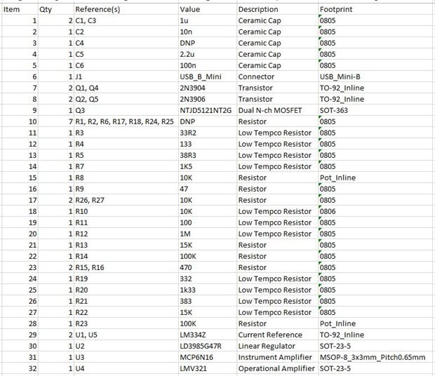

Bill of Materials
I have used a lot of precision low temperature coefficient parts but these may be overkill for many applications.  There is a very interesting discussion around zero tempco constant current sources in the links at the end of this post.

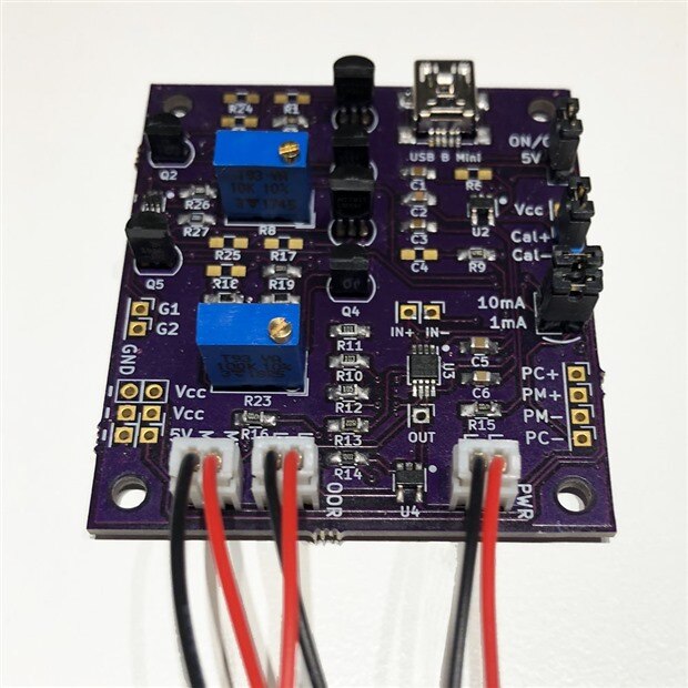

PCB
The PCB has many surface mounted parts but was designed to be hand soldered.  Small ICs should be soldered first, followed by the 0805 components, and then through hole.  This is still under development but if you are interested in the gerbers files or Kicad files send me a personal message.

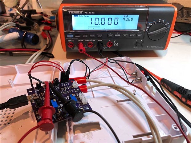

Calibration
The multi-turn potentiometers enable very accurate setting of the current sources.

No code required at least for now.  This is pure analog :-)
Using the Milliohm Meter

  1. MOSFET Q3 is for future auto-ranging but is not currently implemented.
  2. Op Amp U4 is configured as a comparator to flag out of range conditions but is not currently implemented.
  3. Trim Pots R8 and R23 may need additional trim resistors (R1, R2, R17, R18) to get in range
  4. Accuracy drops off below 3 milliohms
  5. User must add a 10x factor to readings when using the high range
